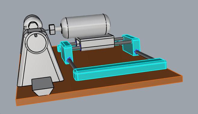

My English isn’t great, but if I understand correctly, they’re thinking of the principle of a gantry milling machine. Isn’t the principle of a CNC lathe simpler? Just an X and Z axis.
I made a drawing to clarify what I mean.
Yes it could be but then I would have to design my own instead of resuming a working design. I’m not good enough for that

this is not what I ment with my post. I mean a A axis with a stepper so the software can possition the material according to the gcode
Yes i like your suggestion it would be perfect except for the design
Could still work. Replace the lathe motor with a stepper. Or more likely, replace the lathe motor with a stepper tied to a belt with a 20T pulley on the motor and a 60T pulley on the drive to give it a 3:1 torque increase. The build itself remains the same, or very similar.
