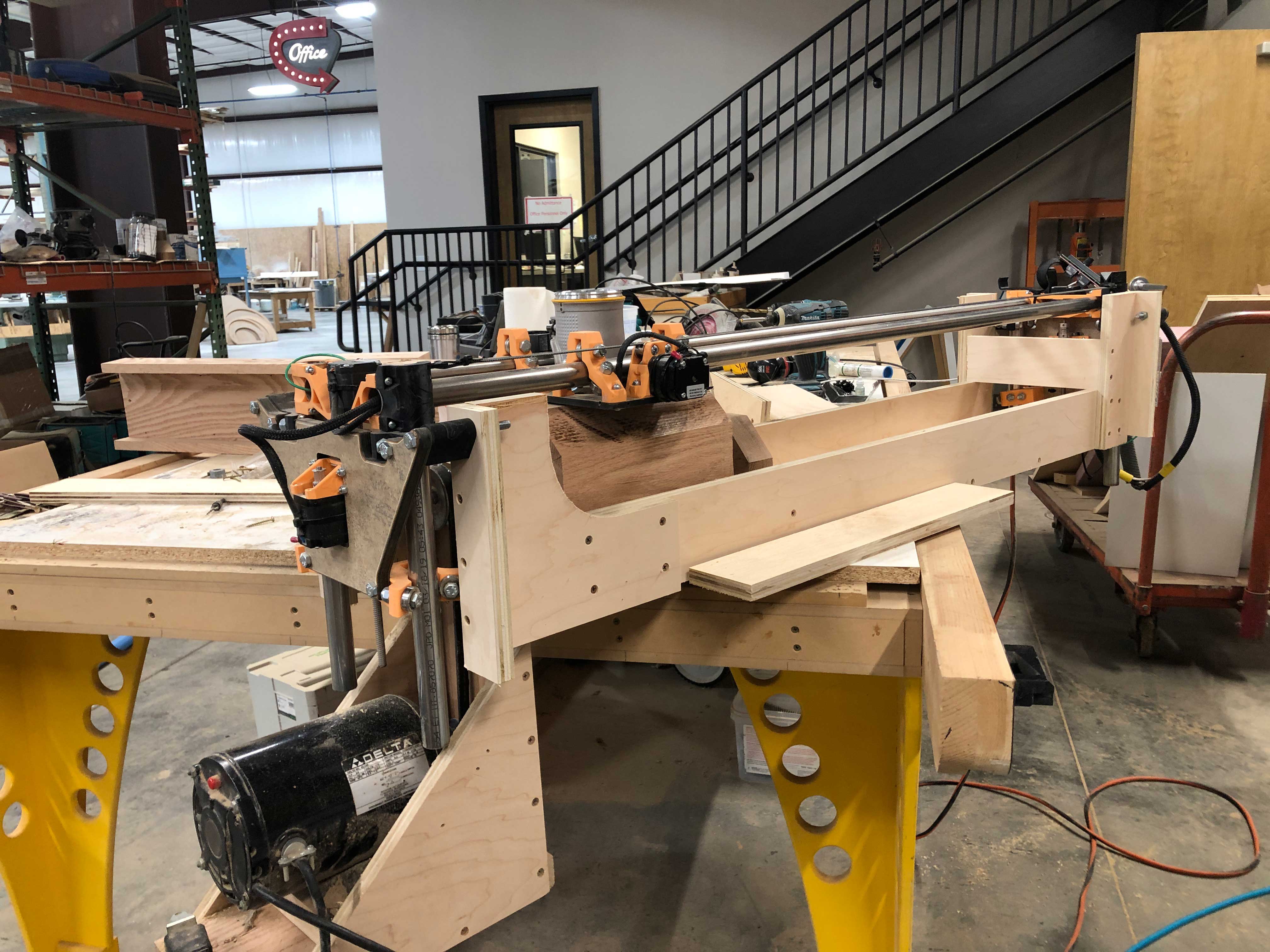

Been mulling this over for quite a while now. A job popped up that this would be just the ticket for. I haven’t used my LowRider for about a year, it was replaced by a giant Onsrud.
This is a 3/4 hp motor driving a belt to a pulley going through bearings to create a makeshift lathe.
The lowrider is mounted lengthwise along the lathe axis. Using only the X axis and Z axis to move the router over the workpiece. Of course, since the lowrider hasn’t been fired up in months, it doesn’t work. The screen came up as a garbled mess. The ribbon cables were really loose on the board. Tried a little contact enhancer but now I just have a blue screen. Do you guys think this is just a cable problem or something more?

The blue screen is usually related to the wires being swapped or rotated. A loose contact would be a good guess too. It shouldn’t really wear out.
What about just skipping the screen and attaching a computer to the USB? I’m not sure if you are set up for something like that. But it would at least let you test the Marlin board and then worry about the screen.

Very cool idea! I’d worry about the sideway force on the endmill. Usually when you are using a hand tool on the lathe, you have a very long handle and a solid edge to rest the tool against. When using a lr2 router on a lathe, I can’t figure out whether the spinning of the endmill is enough “counter force”. Just a thought, don’t want to be a party pooper!!

I don’t have first hand lathe experience, but I believe the reason for the huge leverage on lathe tools is that it can bite, and it won’t give in until you make a chip, or you get injured. The rotating bit should be taking smaller bites, and due to the angle, if it get stuck, the wood will move away from the tool, and the tool can just let go.
You guys make completely sense. Yes, it’s the bite that is my fear. But as you are saying, since the endmill is spinning, it would just move “around”, rather than giving an awful kickback. On the other hand- making a proper lathe cnc with a fixed tool would demand a hefty fixture.
If it takes too big a bite, the endmill will make that cool “ping” noise.
Made a little progress this weekend. I have video but don’t have time to process right now. jeffeb3, I need a little code to make the steppers stay on after a program runs. I was able to run the machine using the Surface but will have new cables for the screen today. I did succeed in turning the blank round and also succeeded in creating the “ping” sound!

I received the new ribbon cables and that was indeed the problem. The screen is working correctly now. I have to fix some slop in the leadnuts, I’m going to change out the screws for through bolts. Also since the longest piece I have to cut is 7", I can shorten the rails of the LowRider to take out a lot of swing.
I was lowering the Z .05" per pass and slowed the X travel down as far as Repetier would go. I’m cutting oak just because it was laying around but the Designer said maple or poplar with a walnut stain. I don’t have enough turning experience to know which of the three would cut the best. Suggestions? I ordered a couple of round nose end mills to try. It will be slow going but I don’t really care if i get a good result. I have time to get it done. I don’t remember what rotational speed I ended up with, I calculated it when I bought the pulleys. I need one of those segmented belts to reduce vibration. I’m considering getting a small “real” lathe and put the LowRider on top of that. It would be a lot smoother and easier to change work pieces. I’ll have news on that very soon. I need to do a quick program and see how long it would take to cut this piece. Too much Fusion work to do.
