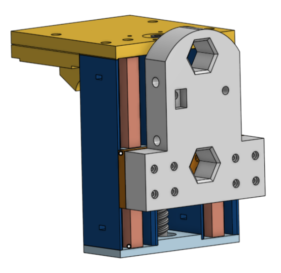

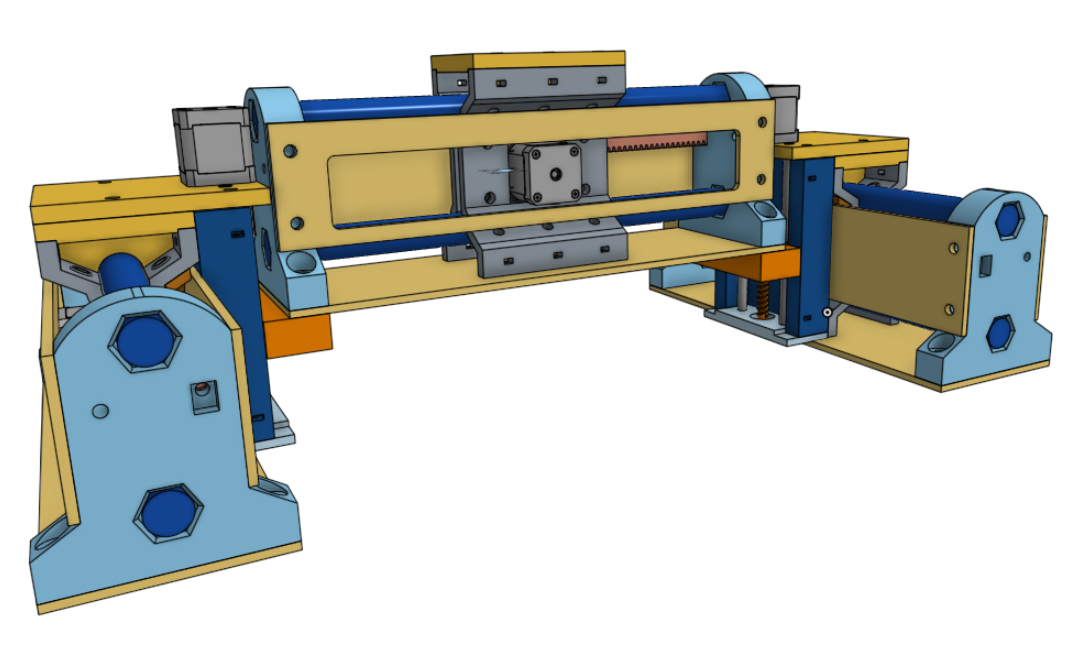

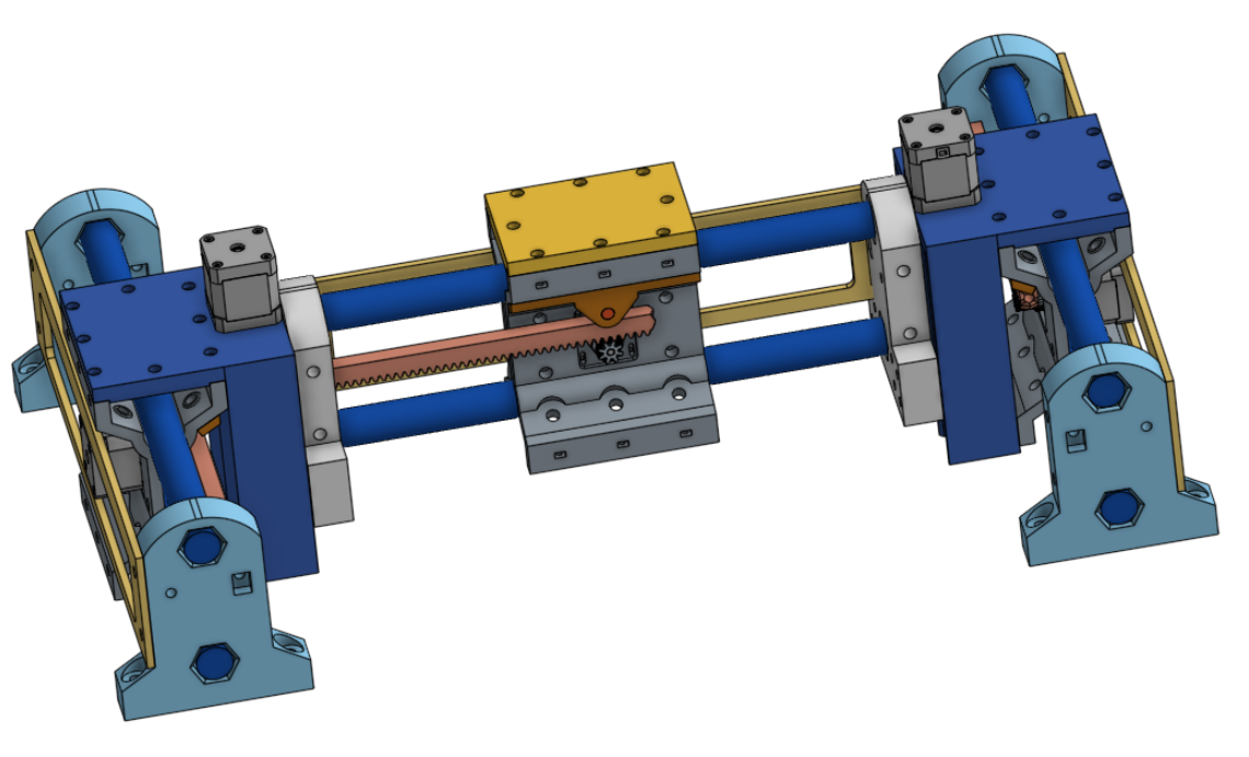

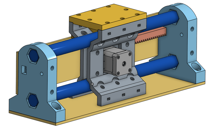

With my prototype MPR&P now languishing because of a lack of motivation and hatred of the noise and debris… a new Prusa Core One L printer has rekindled an idea bandied about during that fun first build.

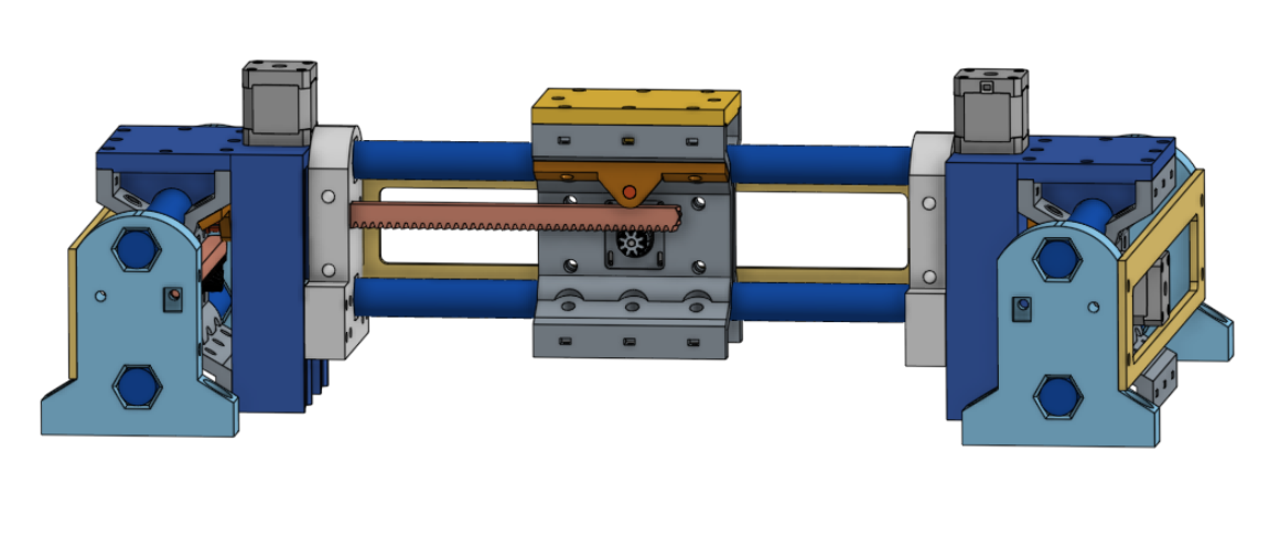

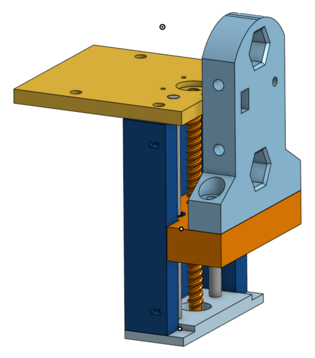

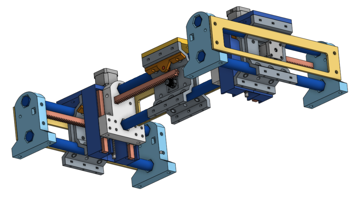

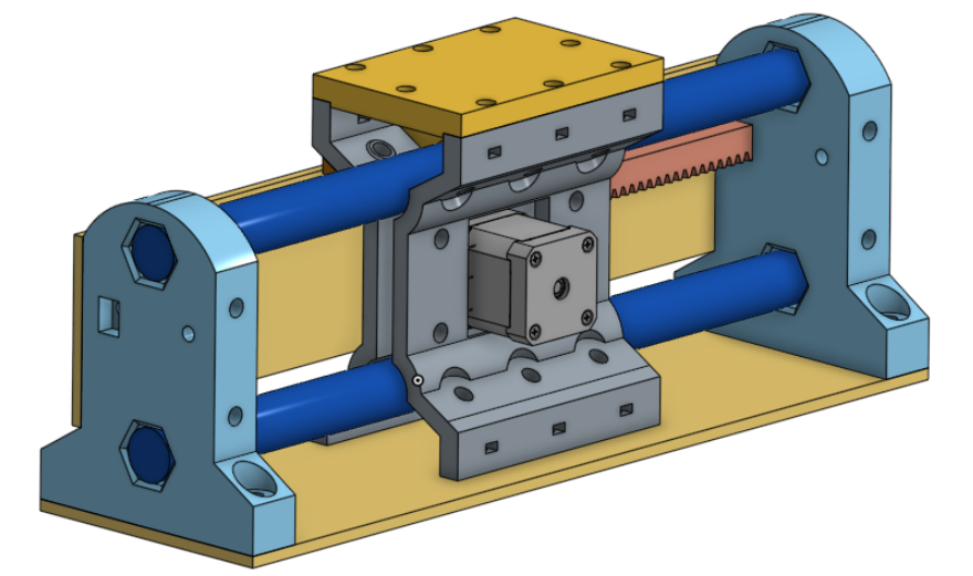

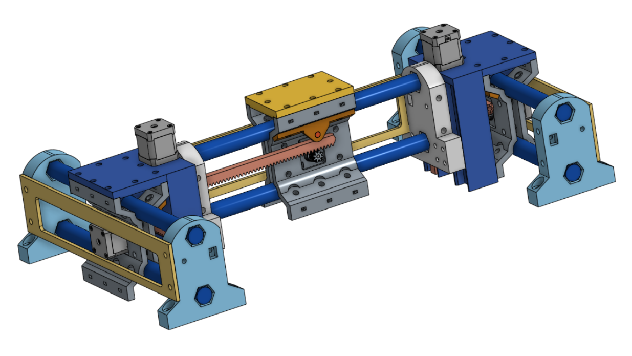

What if we married a LR4-inspired beam and lift assembly with MPR&P’s “standard” linear stages?
Much lower COG and rigidity at the expense of bulkier gantry ends?

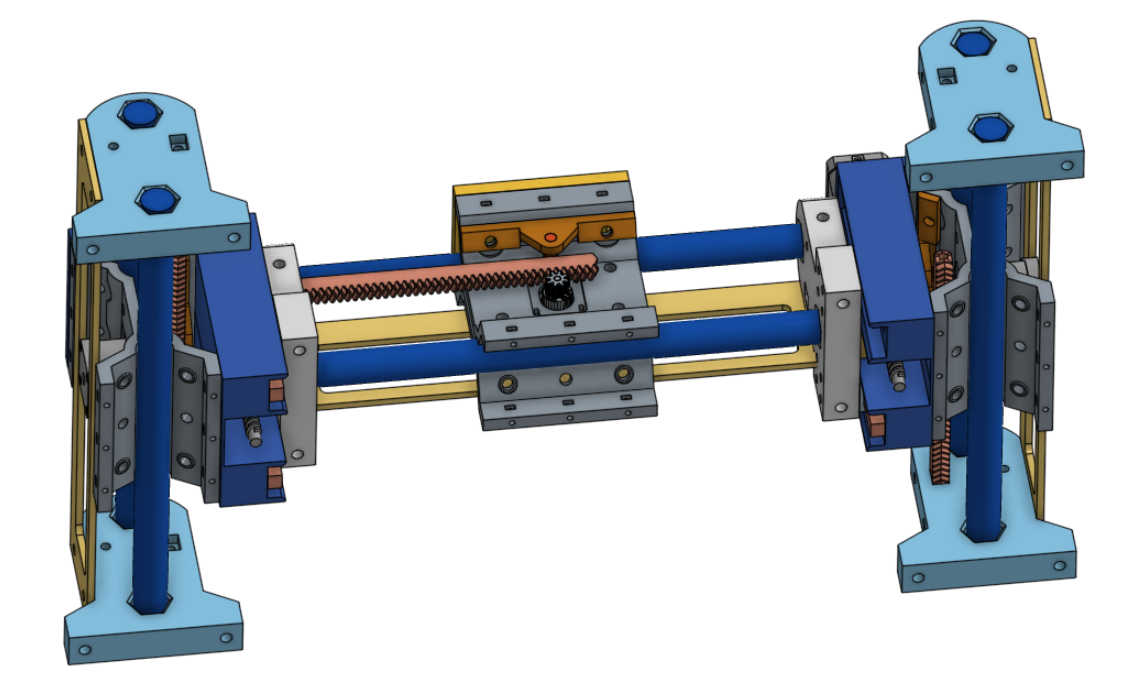

This obviously needs a lot of adjustment and refinement of parts design and relative placement and spacings but it could use almost stock linear MPR&P linear stages and the addition of two new Z-lift assemblies. Sadly, it does do away with the R&P Z-axis of version 1 but it looks to me there’s lots of ways to make the beam much more rigid… with flat ply panels along the back (as shown) and bottom connecting the gantry ends. I bought a set of LR4 linear guides from Ryan and this looks like it could be a fun project for the new printer. I’ve got LR4 leadscrews on order as well but for now I want to test with a printed leadscrew, similar to one of my motorized Z-axis mechanisms…

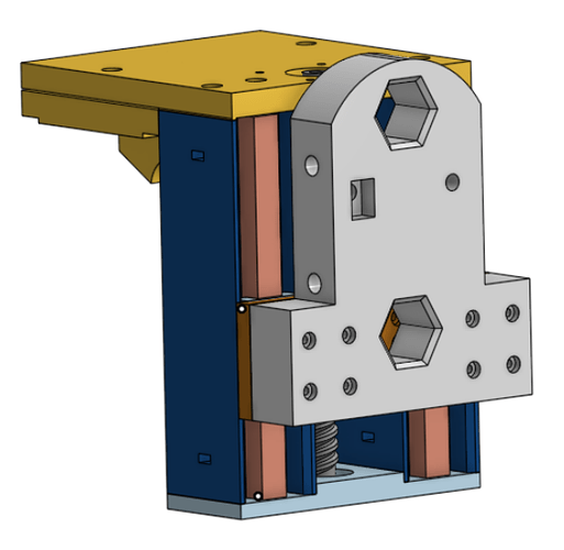

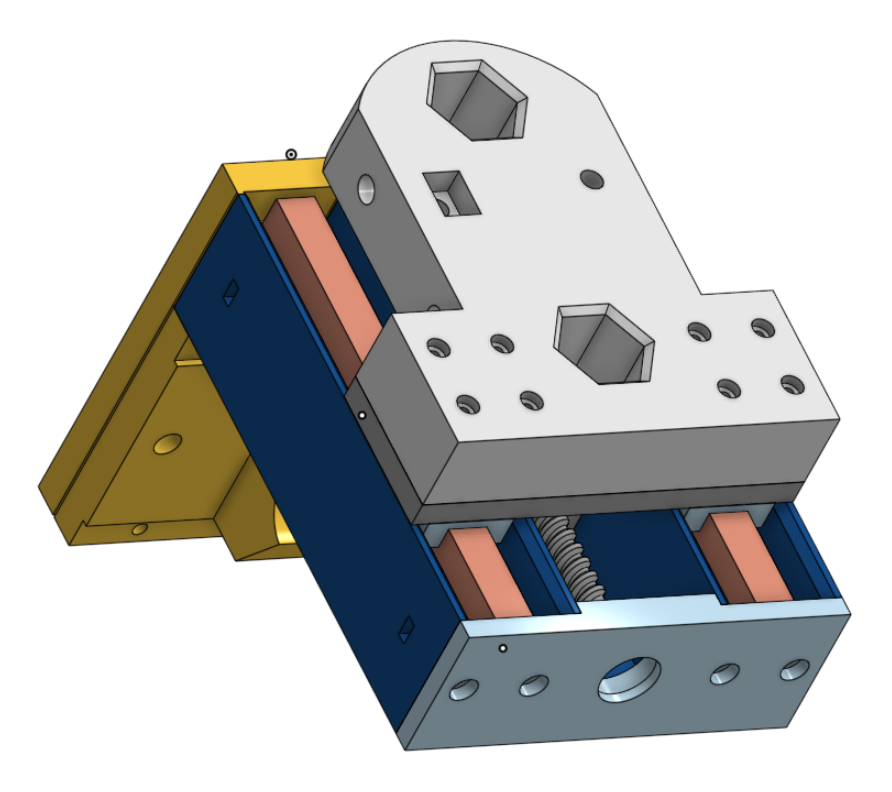

So far, I envision everything the same as MPR&P version 1… and am working on the new Z-lift assembly with slightly modified gantry ends…

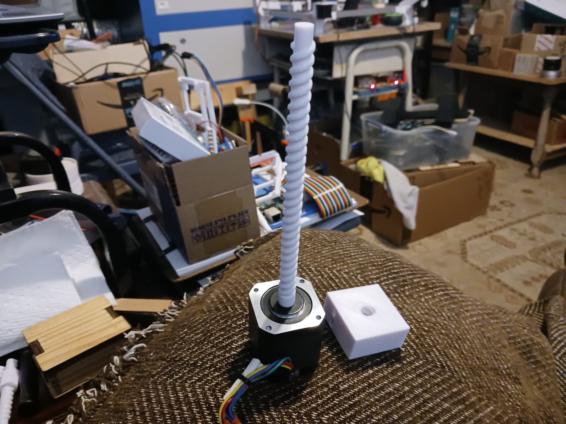

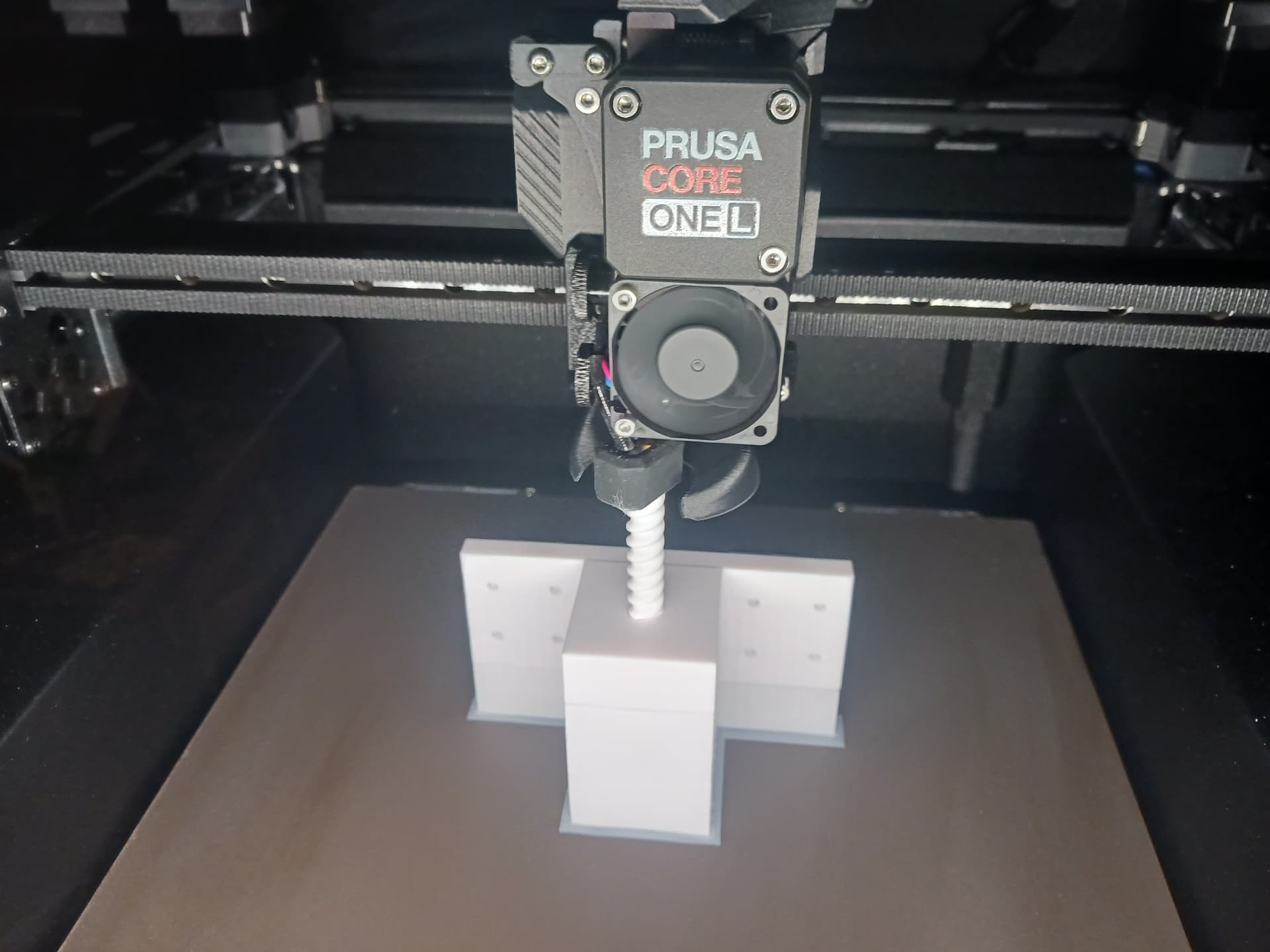

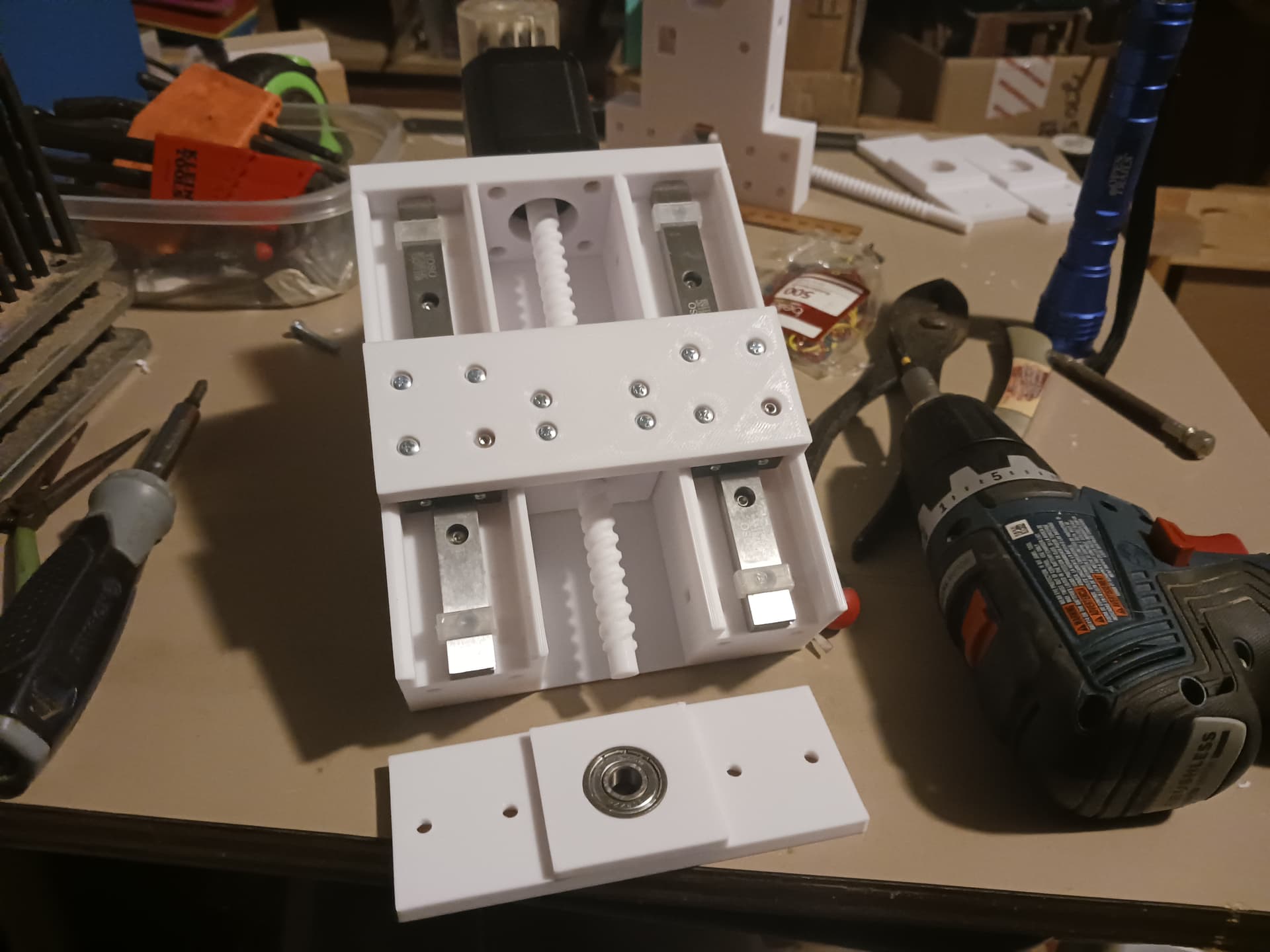

Am currently printing a slightly shorter leadscrew with integrated nut and plate… a print-in-place. They must be printed together to keep matching pitch. Don’t care about actual pitch value… I can adjust the steps/mm during calibration.
Initially tried separate nut and plate as shown here… but leadscrew about 2mm too long to attach bottom bearing capture plate.
The linear slides are Ryan’s 150mm LR4 slides. Should have something moving tomorrow… er, later today. As soon as I have a semi-workable lift assembly I’ll be happy to provide .3mf files…
:stuck_out_tongue_winking_eye:
I think those are great to test with but if it was a long term thing the motors need to be on the bottom sot the screws are always under compression not tension.
Thanks for the input, Ryan. Wherever possible, I’ve always tried to design in symmetry… always pays off somewhere down the line with fewer unique parts and multiple orientations. Y-carriages are symmetric and should allow Z-motors on bottom. Just add support legs from original MPR&P to clear…

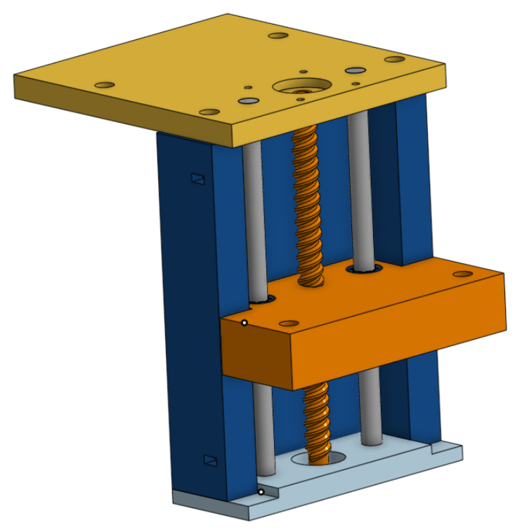

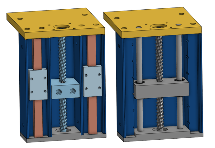

I just happened across an older i3 style (bed slinger) 3d printer and it uses a guide rod and a lead screw for z.
In my recollection, the linear bearing tends to be the cost driver in this setup for z. Is it more economical to use a rod bearing in this case for economy or is it trading off too much rigidity or complexity?
I doubt you could be much cheaper than the rod guides and printed leadscrew shown in this video…
This particular laser engraver Z-axis shown used garden variety 5/16" x 6" bolts from the big box store surrounded by printed linear bearings. Who knows how long they might last as Z-lift stages in MPR&P-V2? The same question could be asked of any other of MPR&P’s printed parts… the printed R&P parts, in particular. But as Ryan noted above, repair and replacement of printed parts is miniscule while their function might be good enough for long enough to be quite handy and useful.
The MPR&P-V2 will utilize the LR4 linear slides I bought from Ryan… because I have them and it’s LR4’s beam and lift setup I’m looking to duplicate. I might use the LR4 leadscrews as well… and I have them on order. But I also wanted to play with the printed leadscrews as well… they are fun to make up in Onshape and printed-in-place, with the only real cost being time and filament.
So, a really cheap mostly-printed machine with surprising accuracy can made that will last long enough to at least see it’s potential… if not longevity. I’ve made several machines like this… the R&P MPCNC, a MPCoreXY laser engraver with printed BB-bearing linear slides, the original MPR&P, and bunches of manual and motorized Z-axis for laser engravers. The original MPR&P was a substantial project and cost almost nothing, except time and filament… working from my junkbox and printing almost all the parts.
To answer your question… the rod and leadscrew is definitely more economical than the linear slide and leadscrew setup. And, at this early stage, I don’t think anybody really knows the trade-off of rigidity and complexity. Until a few of these things are built and actually put to use, I doubt we’ll ever know.
Initial test of Z-lift stage…

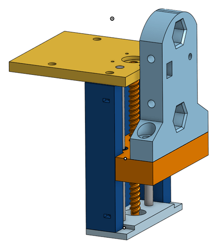

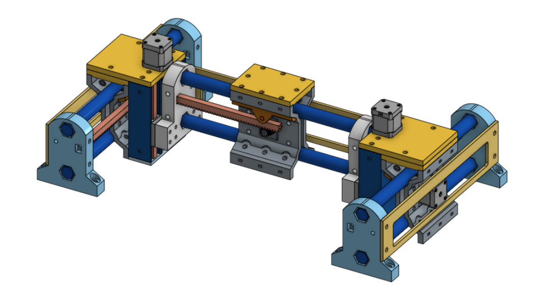

Now that I’ve thought about it some more and there’s been several musings/comments on what a most economical MPR&P might look like… I’ve rethunk my comments about what the MPR&P-V2 Z-lift assembly could look like with rod guides instead of linear rail…
Even if you purchased common 8mm or 10mm polished rods and matching LMxUU linear bearings I suspect it would still be considerably less expensive than the MGN12 linear rail. I think I’ll continue with that idea in mind.

Been printing lots of test parts after switching back to PLA from PETG experiments. I love the new CoreOneL printer though I’m not too crazy for PrusaConnect and its internet connection back home. The machine seems a bit too smart in some ways… but I do like being able to control it from my recliner.

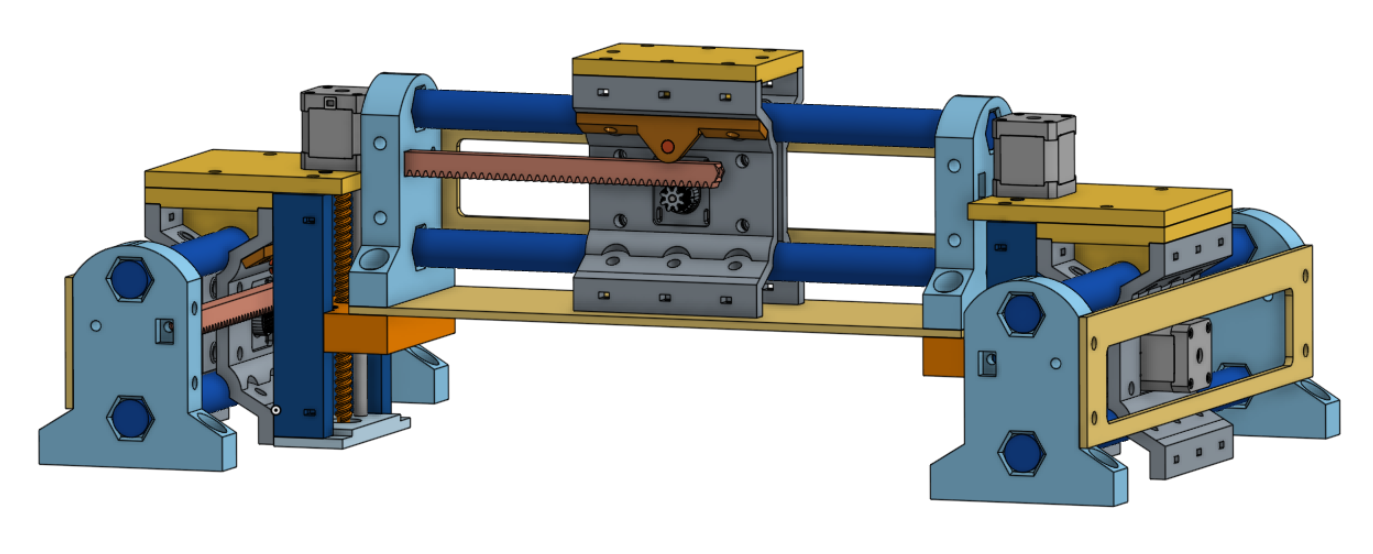

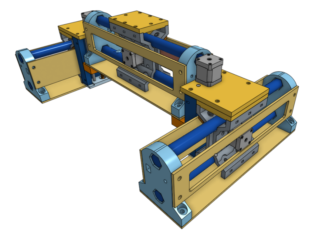

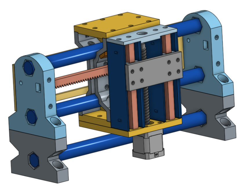

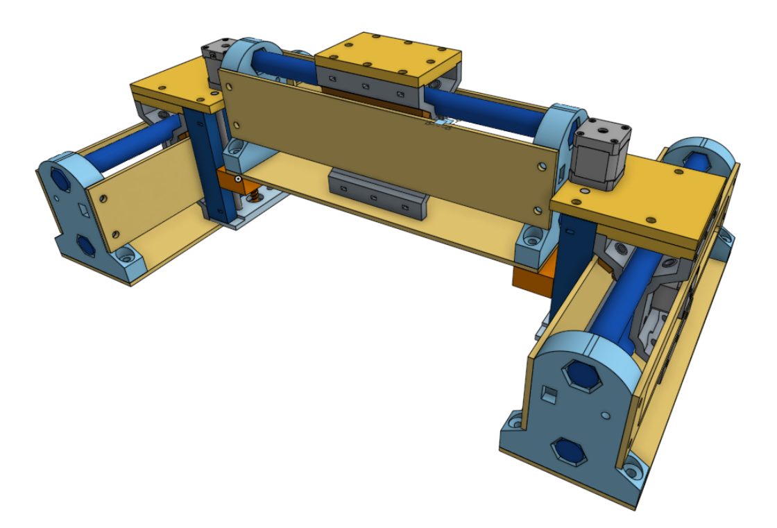

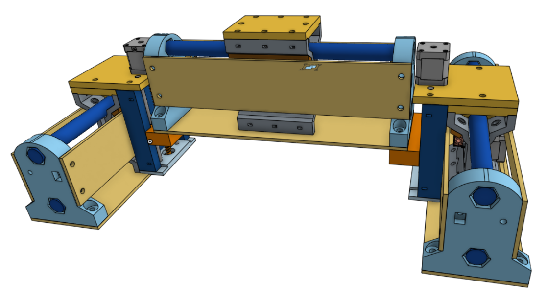

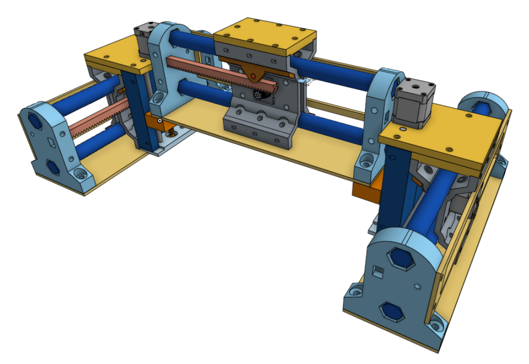

The guide-rod Z-lift is coming along slowly… while also needing to work on some Christmas gift ideas. I’ve still got adjustments to make for the Z-lift assembly and am printing test parts right now… still hope to demo today.

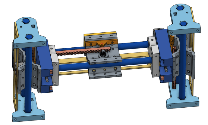

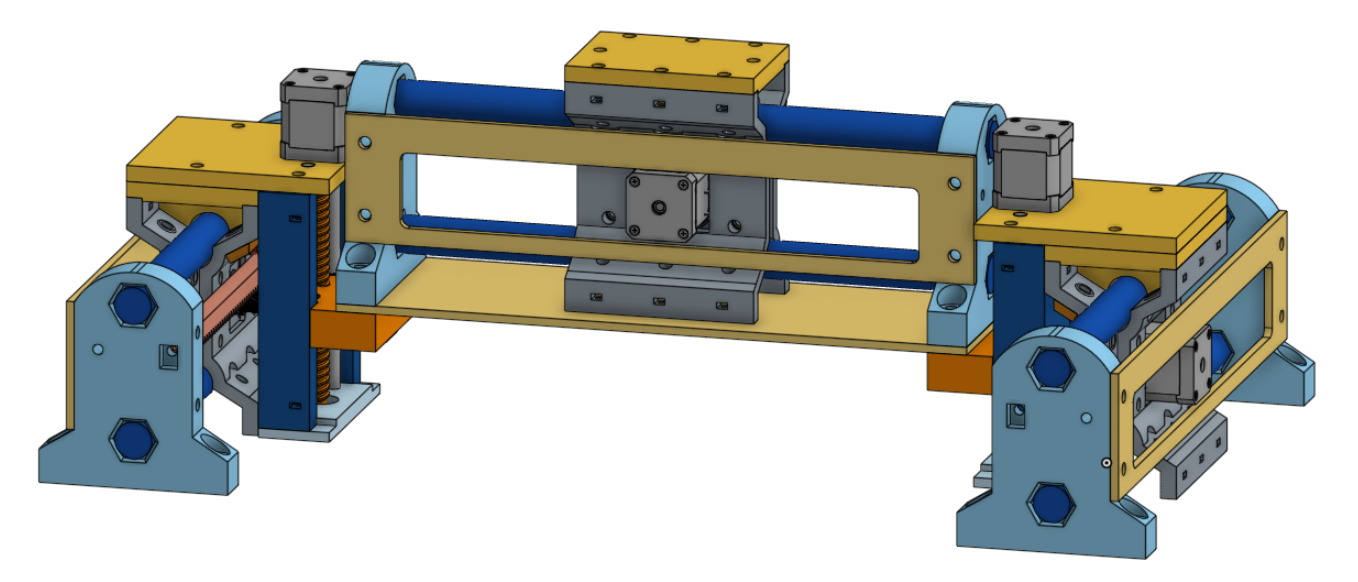

In the following renders I’m showing flat-panel plywood stiffeners in place that I think will make the whole machine more rigid but adjustments will need to be made to provide a tad more clearance between parts. I really think now that the entire machine can be virtually three identical linear stages and the two Z-lift assemblies. All that would remain is a fixed-position tool mount on the gantry’s X-carriage… which I envision would mount similar to the lift assemblies on the Y-carriages.
Please holler up if you have questions/ideas and/or it seems I’m headed into the weeds.

Shoot, it looks pretty good!
