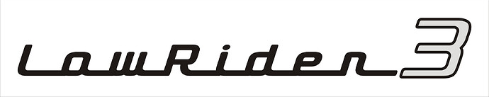

I like it, maybe a separate 3? But I really really like the font, very conducive to CNC cutting.
Agree. Looks good either way.
but I kinda like the 3 being there
I agree. And keep it larger like @bitingmidge has his. I don’t want to steal his design but this is shaping up to be different enough that hopefully he wont mind lol
Maybe a bit heavy…I know the font is different, but I can’t help but think Dale Earnhardt when I look at it lol
I haven’t got around to it yet, but it will be a simple thing to modify the “O, R, D and E” as I have in the “Fat Albert” Font to make sure the centre parts of the letters are not islands. If anyone wants a version like that give me a shout and I’ll sort it for you.
Yes, that would be a needful step for a design where the letters are cut through instead of pocketed. Fonts with that feature built in a typically referred to as “stencil” fonts. As you mention, it can be manually added to existing letters!
Here are two versions I made in which a separate 3, larger, and based on the D3 Roadsterism font, and set so there is a weight matching the name, is included:
A, with no care for it being a “descender”:
B, no “descending” so it could work for keeping (the name part) under the X belt on a strut:

Here are 8 usable variations I made based on the prior efforts and ongoing improvements here in this thread.

LowRider v3 Nameplate (A-2), normal 3, stencilized for through-cuts with no islands

OK, so this one (v3-A) is updated to have “stencilized” version of LR3 nameplate for supporting through-cuts with no islands, expressly for being lit from behind by LEDs. No pockets, no paint.
In the illustrations, gray represents aluminum, and white represents LED light shining behind a through-cut.
