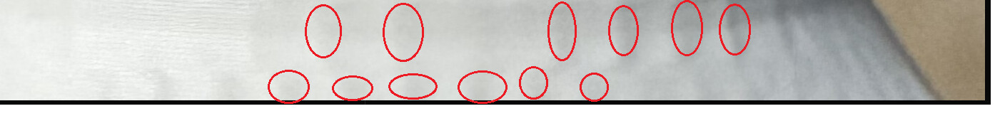

Yes I’ve thrown every single idea I can come up with at him. And everything he has tried at least 3 times lol. At this point I am frustrated because it doesn’t make sense and it’s bringing back PTSD from my V4 build lol.

Perhaps you can print something in vase mode and see if the wall thickness is going thick/thin, or if the wall is wandering laterally.
Also, this caught my eye, suggesting that the pitch is not constant, unless this is a trick of the light.
Given that it changes so much with layer height, I’m thinking it has to be thick/thin and not wandering.
I “think” I printed one in vase mode already, but I can’t find a picture. I’ll run another when I get off work.
That white print was an older one and had other issues as well, so I’m not sure if that one is a good thing to base anything off of. It was just the only print I had with a round part on it.
I can run the round part again today as well and see what it looks like
This looks really familiar. My V0 suffered from this and I do remember it was a pulley alignment issue. The pattern is from the belt teeth.
Forgive me if this was already mentioned but did you make sure the pulleys are perfectly(ish) inline with the proceeding idlers? If the belt rubs on the idler flange or rides it you get that pattern. Adjusting the pulley on the shaft so is aligned with the following idler fixed the issue - at least in my situation.

  • You can isolate the A side of the CoreXY from the B side by printing a cube at 45 degrees. If you have idler, or pulley issues that would let you know one set of parallel sides or the other.
  • Turning off features in the firmware would let you know if it is firmware related.
  • A cube printed at 90 degrees should isolate Y rails from X rail bearing issues (or wire dragging).
  • A large cube would show if you have acceleration issues because eventually ringing/ghosting should stop, and be more severe at corners.
  • A pulley or stepper shaft issue should show up as a 32mm periodic issue.
  • Bed issues should show more in Z.
  • if you make a single wall vase mode part with no top layers you should be able to see if it is extruder related if you have a thick/thin pattern. This would show on the walls as a stripe, but would typically vary and be fish scale at times. If you printed a vase with a changing diameter, the pattern would move around like wood grain.
  • I have one Y linear rail that is not as good as the others. This presents as a pattern like yours that is worse, the fourth right I print on the bed. So a cube looks good on the left, bad on the right.
  • The other thing I noticed is I see artifacts in some thin walled sections that do not show up in regular prints. I am not sure what that is, but I kinda assume that means arachne is doing something funny to thin section with a thick nozzle.
My guess is a linear rail issue. Since you feel it nice and smooth with no load, I propose there is a load being added. On the X rail that could be the load of the extruder adding a twisting load and it is getting chunky, the Y rails if they are not co planar then you are twisting them to be in line with each other. I think JJ had this on his build in some form. The Y truck to X rail part was angled pretty bad for some reason and when connecting them his rails got chunky enough that he did not print with it. He bent or adjusted them if I am not mistaken. Maybe a truck print with elephants foot twisting the plate?
