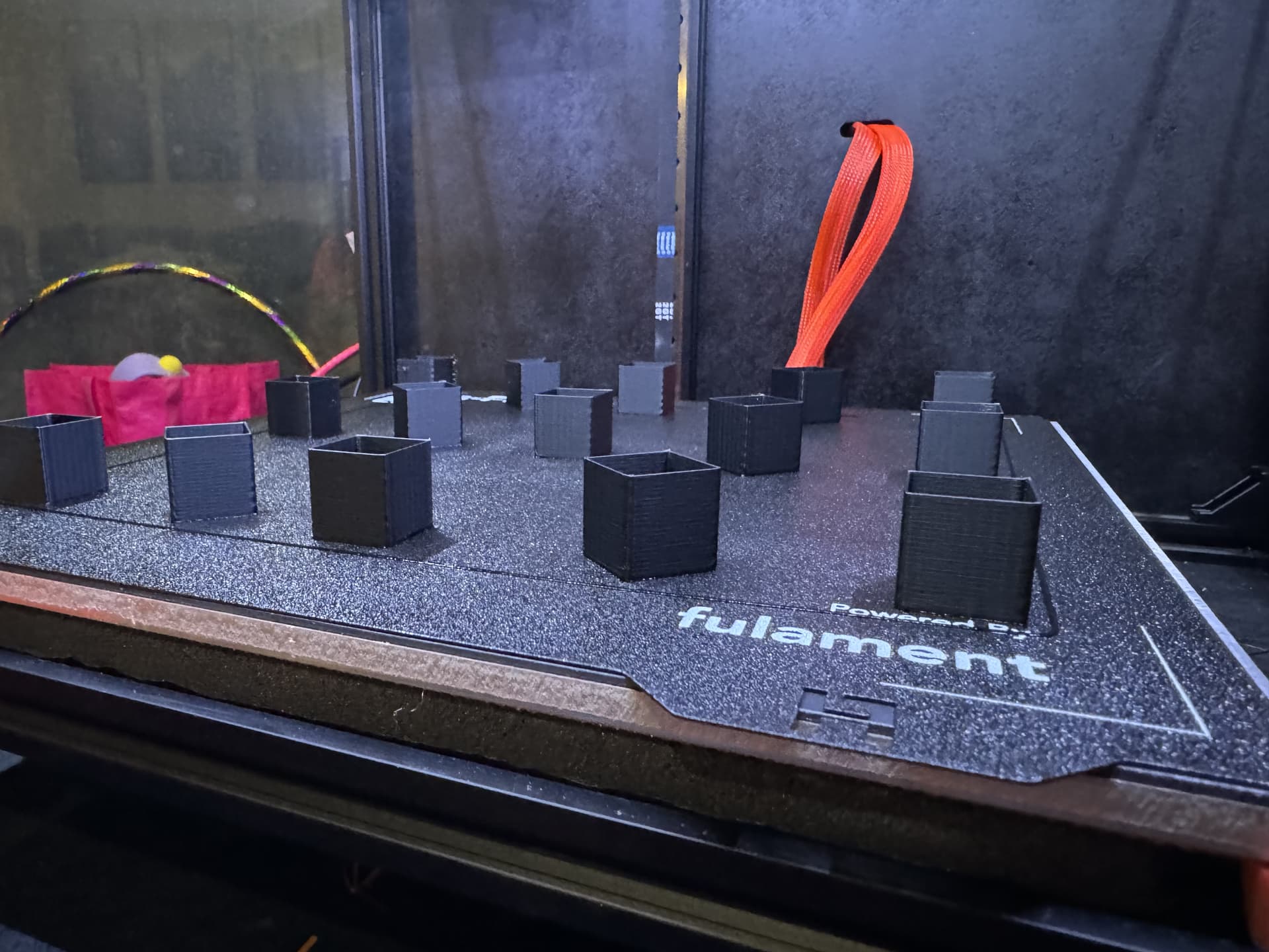

So if this were true, it seems it would only be x or y. That wave is very uniform. Also i would expect it too only be in spots.

Well…that may not be 100% true…I am seeing some artifacts on some early prints… You can see on that front right cube.
In the beginning I think I brushed it off because my I assumed I needed to tune input shaper, but later realized it was something different.
This was a test print I was doing to check on those funky corners. Those corners is what actually started this entire mess of trying to work out issues…
I’m not 100% that one is solved either…so there may be a follow-up thread after the waves are solved :grin:

no, we can’t really feel them, just see them in the light. All my belts, idlers, and gears are the spendy genuine gates brand. A bunch of us went through a lot of crap trying to track it down. It even has a name, “the ripple”. I’m using superlube grease in the bearings.
Can you upload your klipper config? I’m not sure what I would look for, but something might jump out.
ok, perimeters set back to 0.66, tried a bunch of stuff…still the same
I’ve seen it show up on prusa’s big printer too.
forgot we even have an emoji for it on the discord. :rofl:
