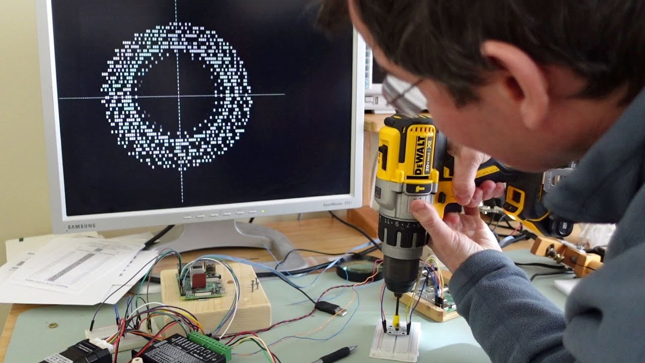

This is a huge clue.
The motors don’t have exactly uniform torque or exactly uniform distance among the microsteps within a step, and potentially could have non-uniform torque across multiple steps depending how the stepper is made. I’ve seen two separate YouTube videos where a NEMA17 stepper was connected to an encoder and a slight non-uniformity of rotation was observed and attributable to the motor.
Something to do with belt teeth meshing with motor pulley teeth, or idler teeth, should be expected to stay the same pitch, even if the motor pulley changed diameter. But the magnetic ‘cogs’ within the motor would manifest as a different distance when changing pulley size.
One experiment would be to temporarily set the motor current extra high, then extra low (but high enough to not skip steps) and see if the pattern changes.

Do you think this is a stepper flaw or the driver implementation in the firmware?
In this case it wouldn’t be firmware or the stepper drivers. It’s inherent to stepper motors, but perhaps not all stepper motors are created equal.

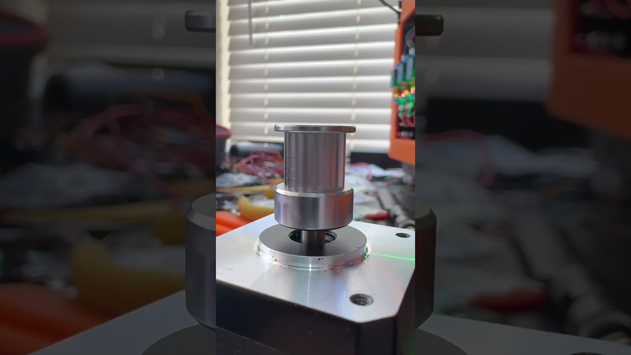

Here’s one of the videos I had seen before:
The one part of this theory that is hard to reconcile is why the period would be 2mm and not some much smaller artifact on the order of the motor steps. “Full steps” are 90 degrees of current phase, so a motor that is 200 steps per revolution is actually 50 full 360 degree cycles per revolution, but this is still much smaller than the ~2mm artifact. So it would seem the intrinsic nonuniformity of microstepping has too small a period to be the problem here.
But maybe there can be other imperfections in the motor that appear at different periods? That’s the best I’ve got.

Wouldn’t a slightly bent/crooked shaft or pulley on the motor (as seen in the video up above) cause the belt to walk on/off the pulley teeth? That’d have an artifact closer, but not quite, the pulleiy/belt tooth spacing size, right? Increasing tension would make that more pronounced, and change the spacing, because it also changes how deep the belt can walk up/down the out of alignment pulley.
If the belt is deforming so that it fits fully into the crooked pulley, then again this would manifest itself in varying tension across the 360 degrees of rotation. This would also manifest itself in motion artifacts in the resulting print.
Exactly, tight and loose once per rotation. 32-40mm depending on the pulley.
I don’t think so. Tight for half loose for half so if it did move it would move up and down a tiny bit, but it is very much captured by a 3-4mm flange.
