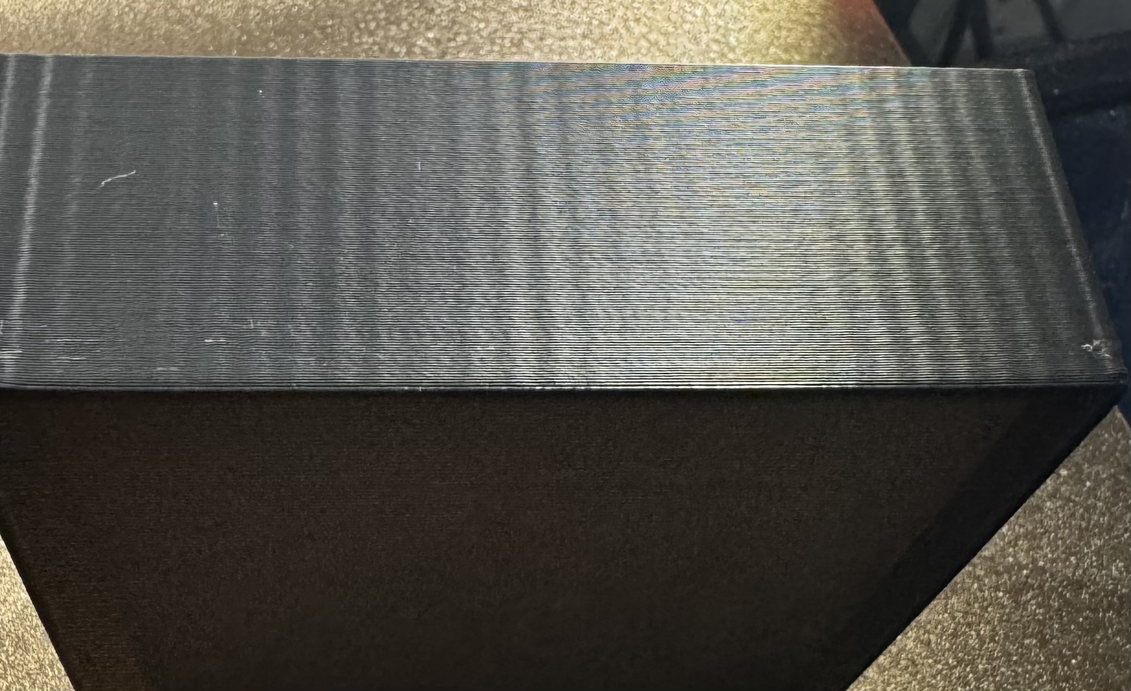

I had waves on X and Y, although X was more pronounced than Y.
Turning it 45 degrees, the B Motor (the one in the video above) side had waves, while the A motor sides did not. I don’t about the relationship of the wave distance on flat sides vs diagonal sides though, as I wasn’t paying attention to that. I only measured on the diagonal sides.
The fact that we were able to isolate it to one motor is what gives me hope that it will get corrected when the motor is replaced, but while I waited for them to arrive, I just wanted to go through everything and make sure that I was confident that everything else was right.
That’s pretty much all my test prints have been
I only did one before I left, but this is the square turned 45 degrees, with the new 20T pulleys
While you can see them, in this case, I don’t think you could feel them as much after I changed everything
If I remember correctly, I think the spacing was ~2.6mm now

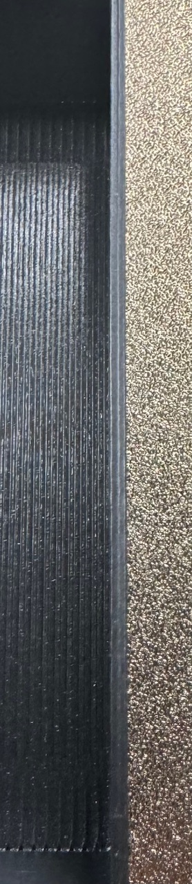

I just made and printed this. You can see my worst print in the pictures. I am only seeing a very tiny ripple on the X axis. I swear, I used to have a pretty nasty ripple on one axis. I was pretty sure mine was bearing related, so maybe they have worn in.
https://www.printables.com/model/918498-test-print
Taking a real critical look, my front X face is the worst and it is fine on the back X face, so maybe my frame has a slight flare back to front.

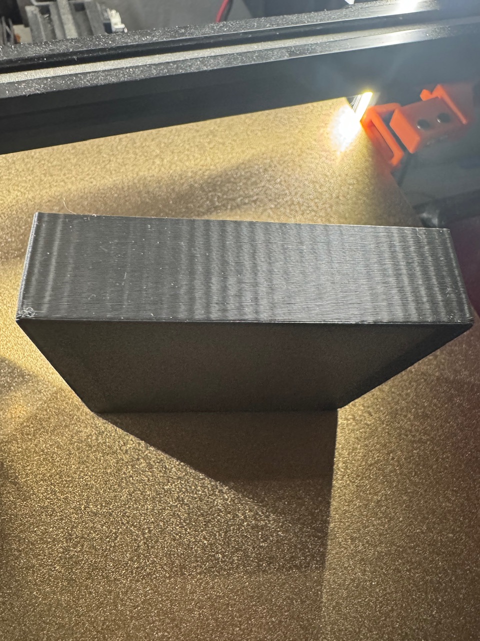

So I’m back home today. I replaced the motors and pulleys on the XY with the new motors, and back down to 16T pulleys…
And still the same.
Except the wave is more visible now on both belts than it was at some point. that might have been when I had the belts tighter though…not sure.
On the B belt, it’s definitely a pattern you can feel, not just see.
