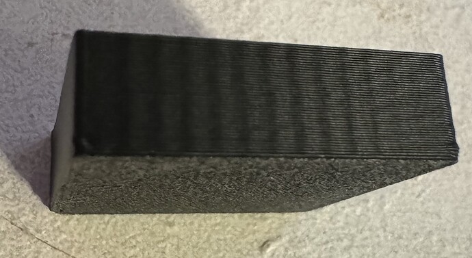

I’m starting this thread because, well, to be honest, I’m at my wit’s end with this one…and I hope someone here has seen something like this before and can maybe point me in the right direction.
Since finishing my MP3DP v5 build, I have been chasing my tail on an issue, and I have taken apart my XY motion system multiple times already trying to figure it out.

Here’s the issue when I print:
This vertical wave pattern appears
This was printed at a 45º angle. The pattern only appears on the side that engages the B belt path. The A belt path doesn’t have the same artifacts.

I’ve been back and forth between thinking I had it solved, and then not, over and over for the last few weeks.
When I loosen the belts some, it gets worse. My belts are currently probably slightly over-tightened just lessen the effect some.
When I print with larger layer heights, the it gets better…
For this picture, the top large print is at 0.2 layer height, and the bottom section is at 0.3 layer height.
This is all being printed at 110mm/s and 4k accels.

As a troubleshooting step, you could try to print at different speeds and accels and see if it changes.
That might help to differentiate between something in the hardware like an out-of-round pulley, something hardware+software like a resonance issue or something purely in the software like a tuning issue, perhaps?
Edit: It might also be worth trying to print something smaller as a ‘reduced case’ to make diagnosis quicker. You know what it’s like on a big part. Does a small 20mm cube exhibit the same issues?
Another thought is that you could print it with cubic infill and see if all paths exhibit the same effect or whether it’s just walls? Not entirely sure what that’d tell you, but it seems like a good ‘poke it with a stick’ method of information gathering.
Have you tried swapping the stepper and pulley between A and B?

For reference, that print in the picture is about 60mm long on the side.
I did try the same with a 20mm cube a couple days ago, and got the same effect on the walls.

what’s the spacing between the ripples?
Pretty close to the belt spacing…but not exact…
Looks like 2.05-2.1mm
We get that on railcore printers. The current theory is the belt alignment at the hotend is slightly off. We know ours is out of alignment by about a millimeter.
One of the guys got it mostly gone by cranking belt tension up to about 100hz. That’d rip a printed printer apart though.
That’s how mine has gotten a little better. Increased belt tension…
We’ve also seen less tension kinda hide it. Can’t go as fast though.
Are those waves in yours deep enough that you can feel it?
When it’s bad you can feel the grooves when you rub your finger back and forth?

Are you using belts, idlers and pulleys from V1E Shop, or did you self source?
It was all from V1. The belt has been replaced with a non-V1 belt, but that was to try to get rid of this issue as a test to see if it was the belt
Is there anywhere in your belt path where you have the belt either able to walk on/off the idler GT2 Pulleys or where it isn’t seating properly? I’ve seen mis-machined idlers on other CoreXY kits, and misalignment where the belt wasn’t fitting the pulley properly.
