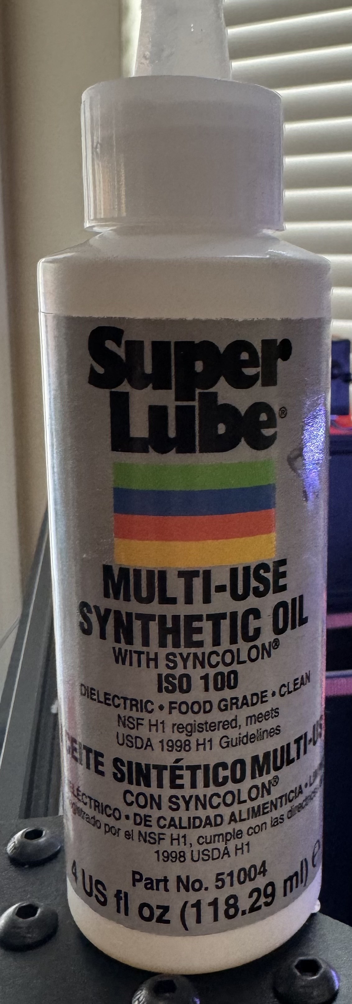

I don’t have any graphite. Only super lube oil.

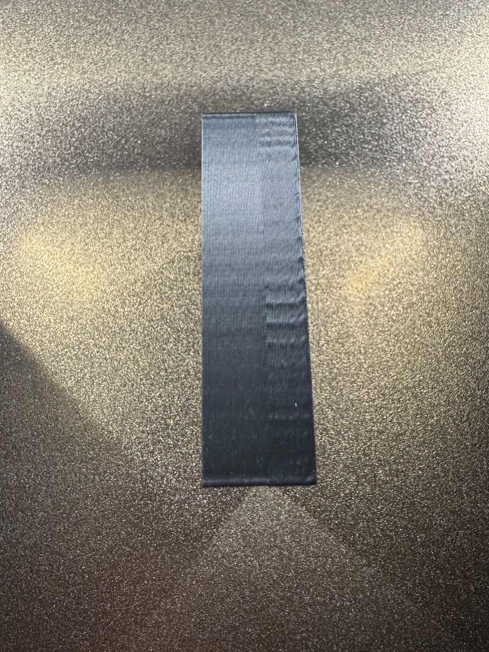

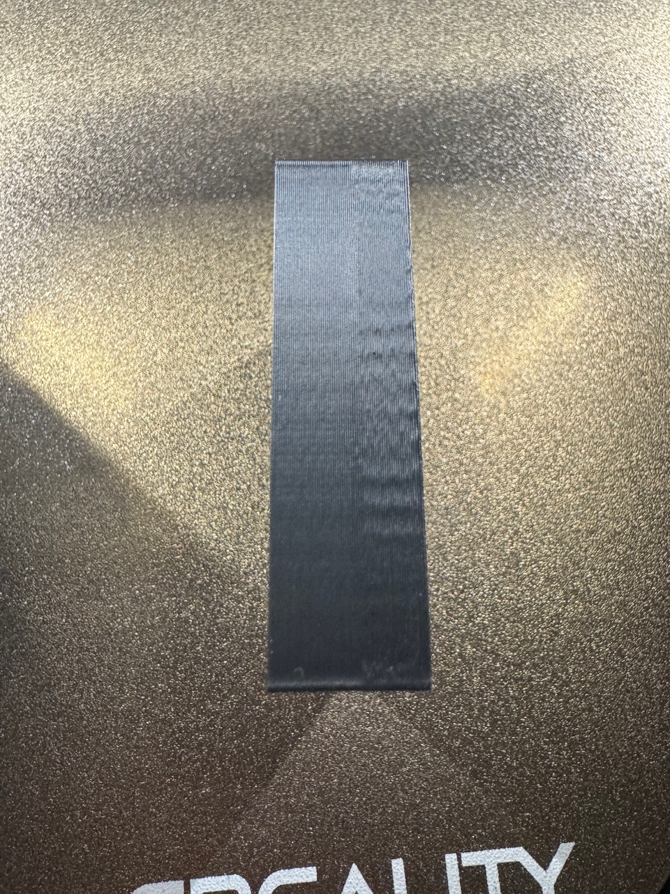

Ok, so new datapoint…
What I changed:
  • Max accel set to 500
  • Disabled Input Shaper
  • Disabled Pressure Advance
  • Loosened belt back to what should be the normal reasonable suggested tension (around 2.0 on the PFMakes belt gauge)
I printed it at the normal 110mm/s for the first 30 layers, then limited the speed using KlipperScreen down to 29mm/s the rest of the way
Pictures
Observations
  • While it normally only really showed on the B belt side, the pattern now shows almost equally on the A and side
  • While the slower speed does look better, the pattern still appears even at 500 accel and 29 mm/s print speed.
If you decide to try lube, AI suggested to consider something other than graphite…
:man_shrugging:

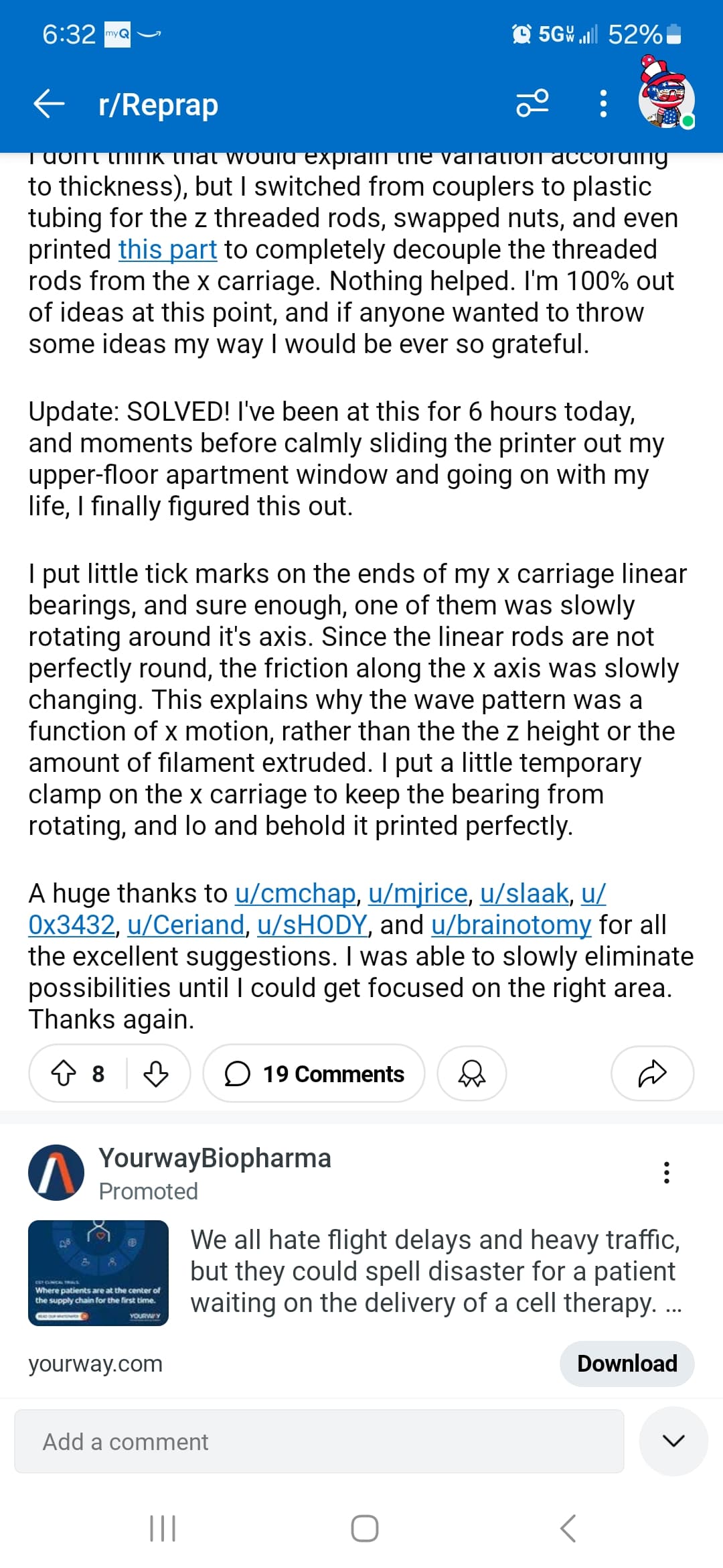

So check out what i found. Interesting. I would never have thought about roundness of rods!!

Want to send the link to that thread? I’d like to check it out
