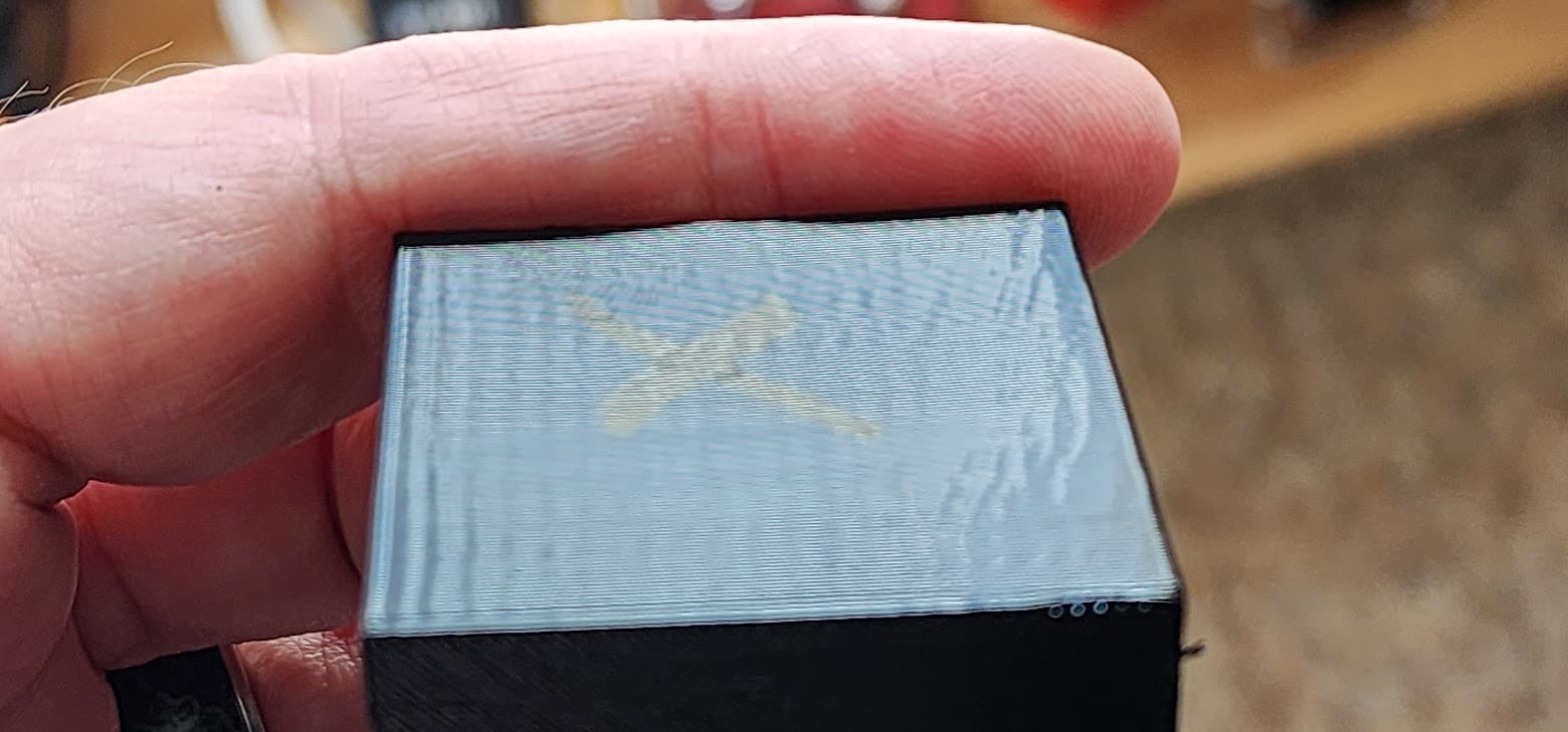

So, I haven’t really been trying very hard to test this at the moment, but I thought this might be an interesting data point to share.
Since my last updates, I have replaced the 0.6mm nozzle on my printer with a 0.4mm CHT nozzle.
I ran a test yesterday, and it has changed again.
This was printed with a 0.4mm nozzle at 0.16 layer height.
This ripple is much closer together than it was before I changed the nozzle
Well, if it was extruder related a smaller nozzle would mean longer extrusions per micro step so the ripple would be further apart I would think.
If it was linear bearing related, it should not change.
This is crazy

So I open PrusaSlicer, right-click on the build plate, add a square. Resize up to 60 or 80mm. rotate it 45 degrees so each face is aligned with a single belt’s motion. Turn top layers to 0. Perimeter count has been tried at both 1 and 2. 0% infill. 0.5mm nozzle with 0.2 layer height.
I don’t think there has ever been a case where that did not show it.
Increasing either the layer height or speed or belt tension has all had some affect on it to make it less visible.
I have printed the same model on my Ender 3 using the same setup in PrusaSlicer and it comes out fine, with no visible artifacts.
That’s about the best I can do for a brain dump summary at the moment lol.
It’s a very frustrating thing especially since it is not consistent across all prints. If the same pattern appeared on every single surface throughout all prints, I feel like maybe it would be something more traceable.
Having it show up just “when it feels like it”, to me, is worse for tracking it down, but better for being able to actually use the printer :grin:

Wouldn’t that mean that you need fewer steps per distance traveled, so if it is extruder related then you should see them be closer together? EDIT: What I mean is that as the flow is happening, you ‘see’ the impact of each small step in a more pronounced way with the smaller nozzle.
This looks like there is a flow-related mode here where the line width is varying because flow through the nozzle is varying. Different outer shells may have different behaviors depending on what type the slicer decides they are.
