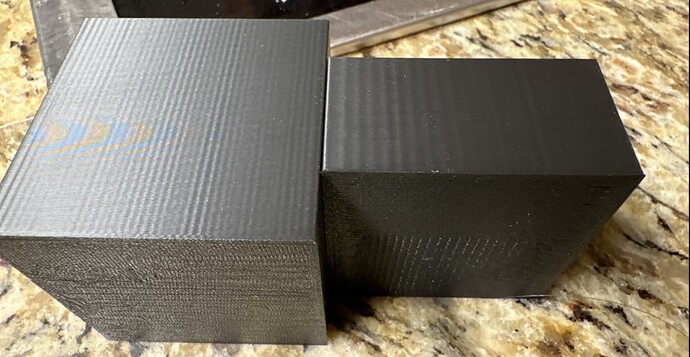

Just to show how frustratingly in circles this goes…
When I got home I downloaded and installed Cura. Built a profile starting with a Voron 2.4 standard profile and tried to get it to match speeds, etc as best as I could.
I did the same thing I normally did in Prusa to add the box to the plate, then exported that box as an STL.
Sliced in Cura and printed…
The Cura printed box is the one on the right. The ripple looks identical to what I was getting previously before I changed the nozzle
The box on the left is the one I printed from PrusaSlicer last night.
So previously, I thought the nozzle change caused the smaller pattern to show…
but now…
(manshrug)
I am printing another right now from PrusaSlicer at the same speed to see if I get the same pattern.
The I’ll come back, likely as confused as ever…

Ok. Prusa slicer print today looks the same as the Cura one, which matches all the previous results….
So the last night one is the mystery I guess…
Last night Prusa
Cura
Prusa just now
Prusa Just now (110 mm/s)
gcodes-2024619-221049.zip (43.5 KB)
Cura (110 mm/s)
gcodes-2024619-221129.zip (42.1 KB)
Prusa yesterday (slower print, previously didn’t change pattern with 0.6 nozzle)
gcodes-2024619-221156.zip (43.7 KB)
Comparing the 2 Prusa ones with different patterns…
Only a speed difference
nearly 2x the speed, nearly 2x the ripple spacing?

So I printed your gcode - and - there is a ripple. I don’t think I have ever noticed that before. Its hard to photograph and I can’t feel it. You gave my printer the ripple virus :rofl:
At about layer 180 I slowed the feed by 75% (in klipper) to bring it to my usual ~82.5mm/s printing speed - a subtle change in the ripple but still there.
So I just used prusa slicer to follow your method as I think it is: Place square; make 60mm; turn 45 deg. I changed my print speed to 110mm/s and 2 walls (also changed external wall speed to 100% from 60%). Other than that I kept my usual settings - I’ve not dug deeply into the settings at the moment -but I wonder if you could try printing this cube that I created?
rob box 110.zip (39.6 KB)
It prints on my machine without a ripple.
If my cube prints on your machine without a ripple, perhaps we can dig further into slicer settings?

3 things I notice are a little different.
My file was at 0.16 layer height, yours is at 0.2
My is extrusion width is 0.44, yours is 0.45
My temperature was at 220, yours is at 200.
if I don’t see the ripple in the first portion, I will up the temperature in steps to test that one as it’s going.
The layer height one might be important though because we saw before that larger layer heights made it less pronounced.
Will report back when it’s done.

It’s still printing, but the ripple is there for me.
It is a little more faint, but I can’t say for sure if that’s a layer height thing, or if the slightly wider wall helps
3 colors are where I stepped the temperature up.
220
210
200
