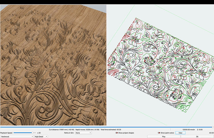

I’ve been experimenting with the Fluting operation today. I wasn’t sure what it was. I see a lot of similarity to V-carving, which makes me think even more they are close to finalizing it.’
Fluting is simpler - it’s basically following a vector path while varying the depth in relatively simple ways. It looks pretty, but doesn’t need the medial axis transform to determine the depth at a given point, so the implementation was a lot easier.

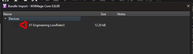

I added the Lowrider3 in the default MillMage devices based off the 4x8 machine we have internally with a Jackpot. Adjust size as needed.

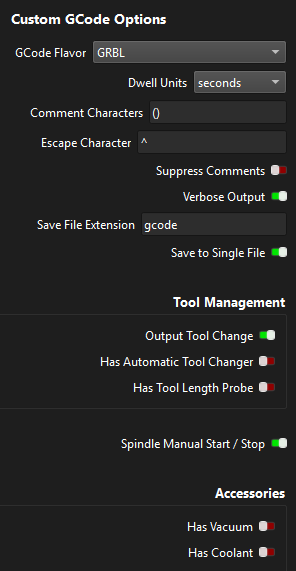

Any other tips and tricks for setting the LR4 up? So far I have added “gcode” as extension, and checked the save to single file box below in the custom gcode tab.
ok apperently there is a “user end script” and also a separate “job end” (script). So that explains the double end scripts.
I need to test this again but here is what I have. It looks like I need to try and get the tool number/name in the message again. I was back and forth on the Millmage forum to get some escape character issues resolved and it looks like I never got back to it after they fixed it.
Job Header: Blank - The default was sufficient.
User Start Script: This sets a variable saying it’s the first tool. Needs to use the escape character.
^#<_IsInitialTool> = 1
Tool Change: Again needs the escape character. If it’s the first tool, just probe and tell it that it’s not the initial tool anymore. If it’s not the initial tool, do the full tool change.
^(^Tool {tool}: {tool_name})
^o102 if [#<_IsInitialTool> EQ 1]
  M0 (MSG, Attach Probe)
  G38.2 Z-110 F200 P0.5 (Probe Down, Set Z0)
  G1 Z10 F900
  M0 (MSG, Remove Probe and Turn On Router)
  #<_IsInitialTool> = 0
o102 else
  $HZ (Home Z)
  G0 X0 Y10 F2520
  M0 (MSG, Change Tool and Attach Probe)
  G00 Z10.0000 F500 (Clearance)
o102 endif^
Job End:
$HZ
M30

I finally had some time to play with MillMage… was able to jog my LR4 in the shop from workstation in the office…. very cool…. and after about an hour, and without even running the machine, I am 100% going to purchase this (well, pretty sure anyway). :slight_smile: I used Lightburn to make all my DFX files prior to setting tools in estlcam. this appears promising.
once I got the hang of working with the material dimensions vs the table dimensions, I copied and pasted a backgammon board from Lightburn to MillMage… the dimensions were spot on.
used pocket for clearing and profile with 30* vbit for sharpness… then compared to using flute.. not much difference so when I do a test run, maybe the physical cutting will show any variations.

Could do that, only had the number because I have the LowRider3 (with Jackpot v1.2 and currently FluidNCv3.9.9) but yes, it could easily be changed to omit the number….less is probably more.
That ‘LowerRider3’ profile is 95% generic:
Nothing fancy, manual Start/Stop, no special tool change or tool length probing code. I did add a ‘@P Check spindle speed/revs correct? : {spindlespeed}’ for ‘Tool On’ , which is not really needed but I like to see what the spindle revs are programmed at for operations in the job and tweak them if needed. I also added a ‘Job End’ movement back to the G54 X0, Y0 position.
It defaults to USB connection, which is not how I use it, (I connect it to my wifi in station mode) but putting an IP address in wouldn’t have been any more helpful, and it’s easy enough to edit.
The profile is very much open for improvement though….

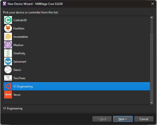

so I am in the shop right now. Getting cold already, but I am playing with Millmage. I kinda like it. I am surprised, I thought I saw a screen that labeled FLUIDNC, but I cannot find it. I selected Grbl, is that what everyone else chose, looks like it is working right now.
That’s what I have selected on mine
They also have a LowRider 3 listed. Either one will work.
