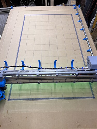

Wow, no lines at all. I think I need to tram my LowRider better as well. :smile:
That IS very impressive!
Thanks! Now I just have to wait till tomorrow to put the new ruler lines. Somewhere yesterday I ended up reading @vicious1 say something about .3mm pen. Well these will be here tomorrow. The felt tip I had was good but the lines tend to “run” and get fatter than intended. Hoping these pens will do better. Time will tell.

Thanks for that!! Everyone has been so quiet about it with all my crazy math I was starting to think I really did have it all screwed up. Thankfully you and @Tokoloshe seem to think I did alright lol. Never noticed anyone else post about doing it that way. Just seemed like an easier way than eye balling it. Plus even if you only have a regular trim router you can pick up a 1/8” tig rod that will chuck in and do the same thing that my #12 ground wire did

I built, for the LR2 and never got around to needing it, a “math free” tramming gauge, which I will do once again for the LR3 if ever it gets finished! :wink:
Basically if the dimension from the centre of the collet to the “tramming mark” is the same as the distance from the bottom of the collet to the “shimming spot” - you can just measure the discrepancy with a feeler gauge and that’s the thickness of the shim. The neat thing is you only have to measure at three points too.
I use this method to level the drill press table so I expect it will be fine with the cnc.

Man that .3mm sure is a thin line
And they don’t like MDF LOL
Well sucks the .3mm pens didn’t work. But I’ve been wanting to try some drawings with the machine anyways so they will definitely come in handy for that!!
Made a 100mm x 100mm grid and now going back with @jamiek ruler perimeter. Didn’t get the lines exactly like I hoped for but I was seriously giving myself a headache trying to figure out all the offsets to get it right. For no more than it’s off I’m ok with it. Not like I will ever use it for serious measurements. Mostly it’s just for the look lol.
