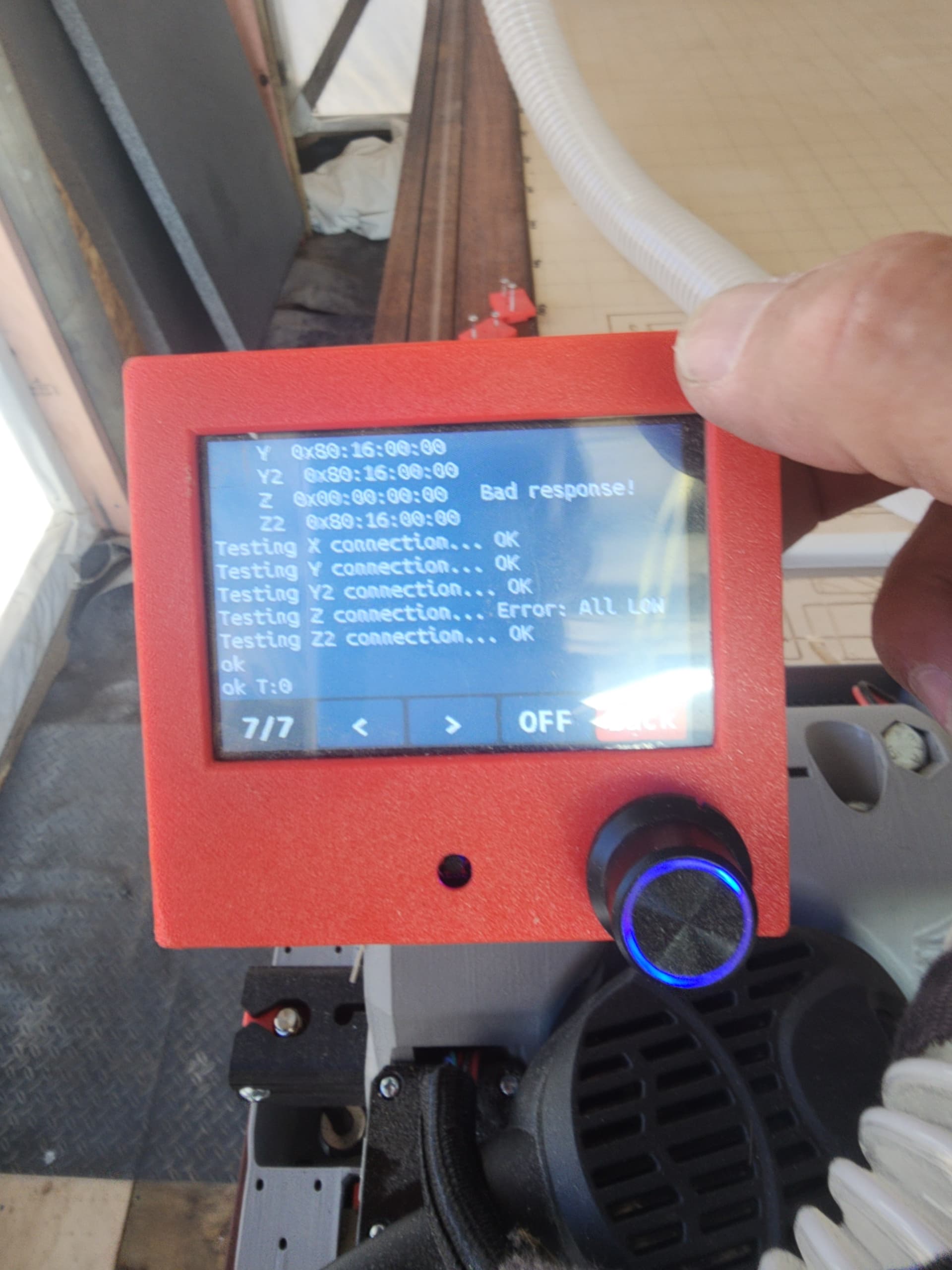

All low warning
right from first time i turned on machine with skr board , it comes up with all low waring , what does it mean
It means you don’t have steppers plugged in, but usually.

Run an M122 command, look for any error or “bad response” messages
3
4
how and where do i enter that M code
Go to the Terminal menu

finally got chance to do the m122 test thing this what i got
z axis moves up and down sweet as,
homes correctly and does everything its meant to when cutting out a file ???
Interesting.
Power down completely, swap out the Z driver with any other and see if it follows, doesn’t, or goes away.
changed wires and still get the all low warning, would it be a board issue
Could be that, or could be a stepper driver.
As @vicious1 suggested, power down, swap the failing driver with a different driver, and see if the problem follows.
that should help to narrow the source of the issue.

Can you put a multi meter on your power supply to make sure it is working right.Chack all three fuses.
All low usually means the drivers are not getting power.
