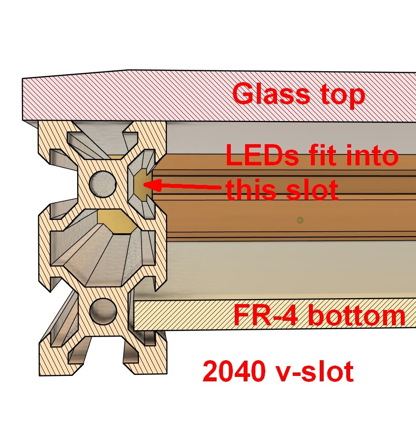

I used 5mm glass for the bottom in Arrakis 2.0 and 3/16” FR-4 sheet for the bottom of Arrakis 3.0/3.1. The FR-4 is almost as rigid as glass so there’s no problem with sag and it won’t ever break unless a truck rolls over it.
Before I built Arrakis 3.0 I did some research into glass table tops and found that 2’x4’ is a very common size, very low cost, and readily available from multiple sources. While you can fit a glass top into a slot in a box frame, you’re going to want to be able to clean the underside and to redistribute the sand periodically. Glass is heavy enough that you can just set it on top of the sandbox and it won’t go anywhere, and can be easily removed when necessary.
I used 2060 t-slot to make the sandbox in Arrakis 3.0/3.1 with the FR-4 bottom fitted into the bottom slot, and LED strips inserted in the top slot. The glass just sits on top. I’ve been meaning to paint a black frame on the underside of the glass to block direct view of the LEDs like I did with Arrakis 3.0, but haven’t gotten around to it yet.
The 2060 pieces of the sandbox are just butted and screwed together using M6 button head cap screws. I drilled tool access holes and tapped the axial holes in the extrusions. This works best if the ends of the t-slot are milled square and lengths are matched so you get square corners when the pieces are screwed together. If you can’t mill them, making 3D printed corners should allow for imprecisely cut pieces of t-slot to bolt together squarely anyway.

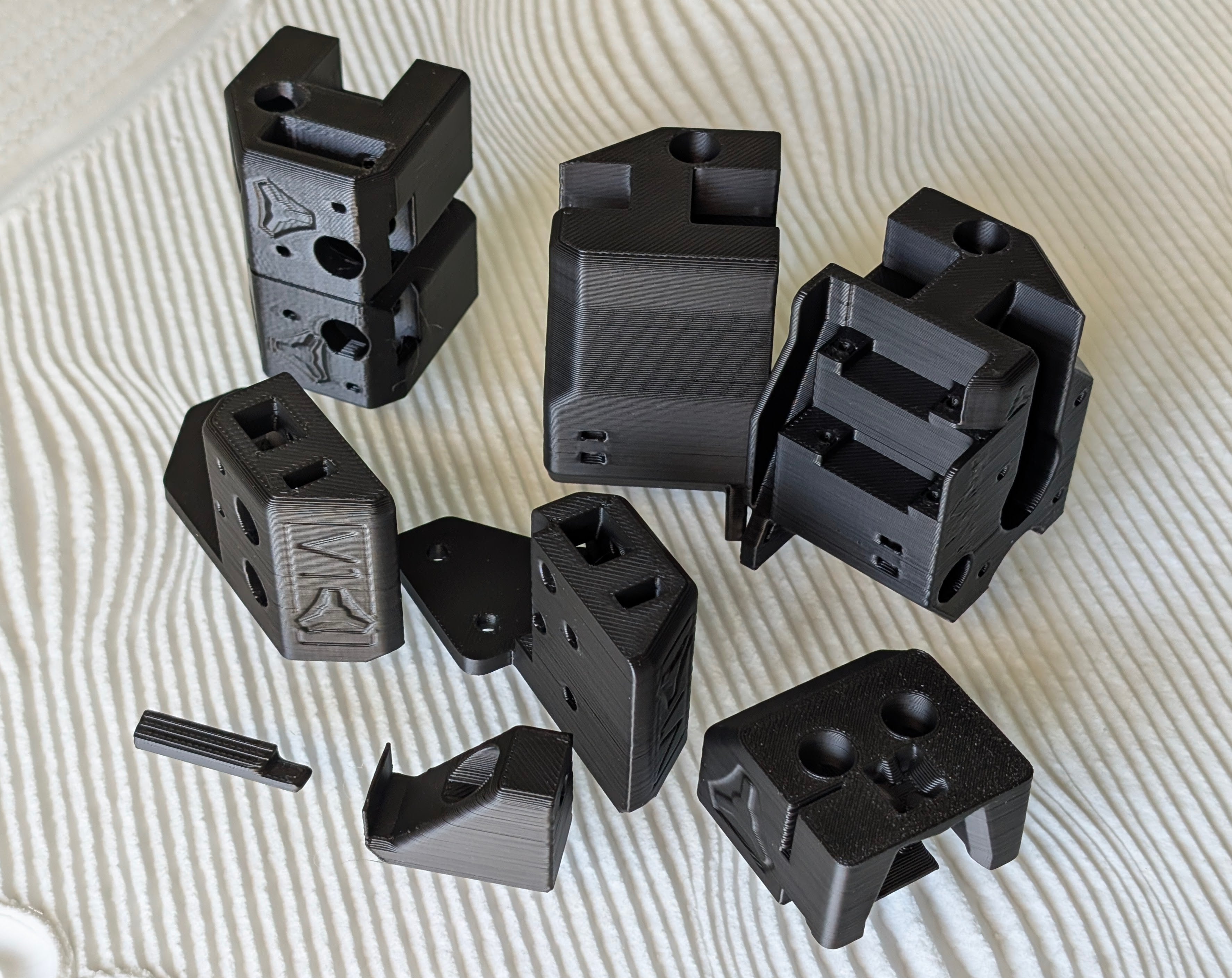

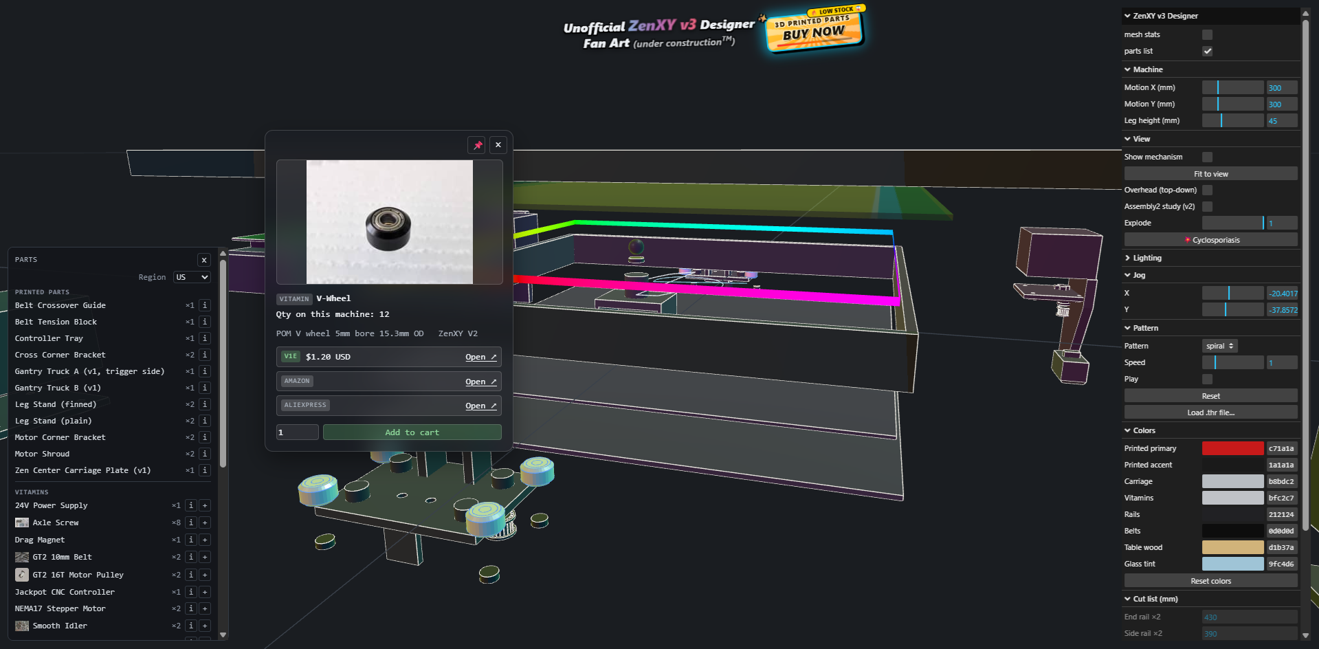

Since it’s Friday… updated the fan art at https://v1e.makergalaxy.com with a cursed TEMU style buy button for the 3D printed parts :grimacing:
Added exploded part views too…
I’ll switch over to the actual ZenXY v3 models if/when they’re available.
If ZenXY v3 parts aren’t intended to be openly shared at this time, then, I can decimate/downscale the original meshes so they’re useful for on-screen rendering, but intentionally not good enough to 3D print.

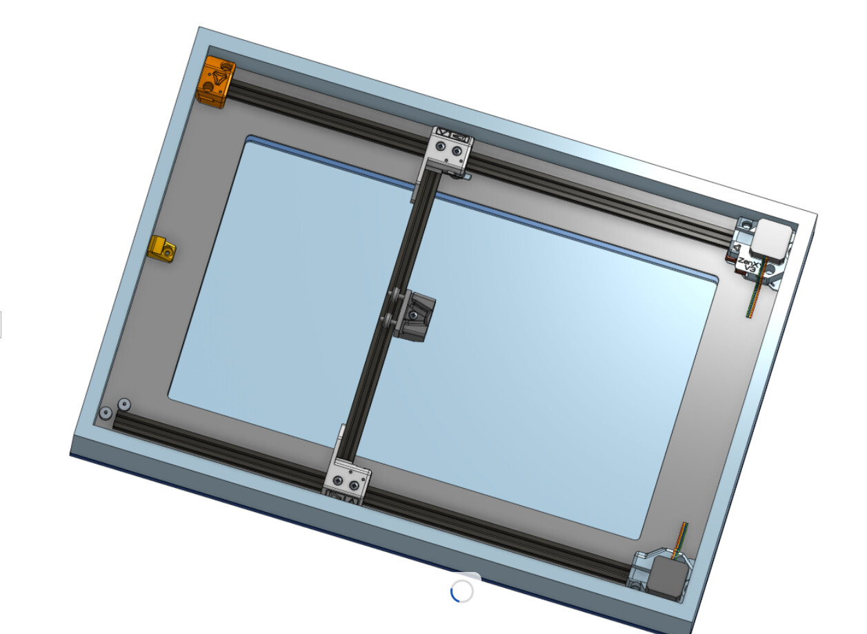

It’s getting closer, just making sure the CAD is in good working order.
It is kinda hard to make a generic set of instructions so I am going to lean heavily on the CAD for people to get a closer look at the ways to build one. Or I think it will be easier to show things in CAD versus me building a bunch of tables and trying to take good pictures.

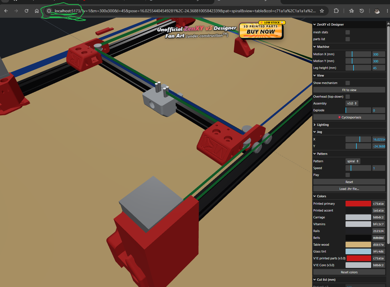

Experimented with reduce mesh render, I have not published (and won’t until if/when files are publicly shared). Shared repo access with Ryan/Jeff/Jamie back when I started messing with this.
Fable’s first attempt at incorporating reduced mesh official models with Jamie and my assemblies… Decent start, but orientations are off, I can fix, or… just import the onshape CAD when that’s available.

Fwiw, AI and “I” also wrote scripts to export OnShape parts and assemblies, not fully parametric, but that’s one option for projects like this.
I have the full CAD coming.
