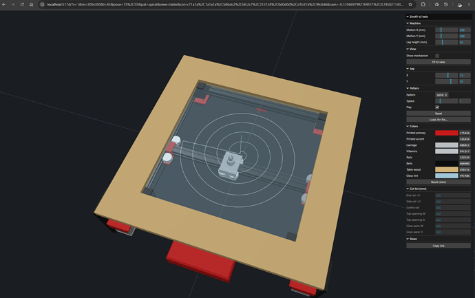

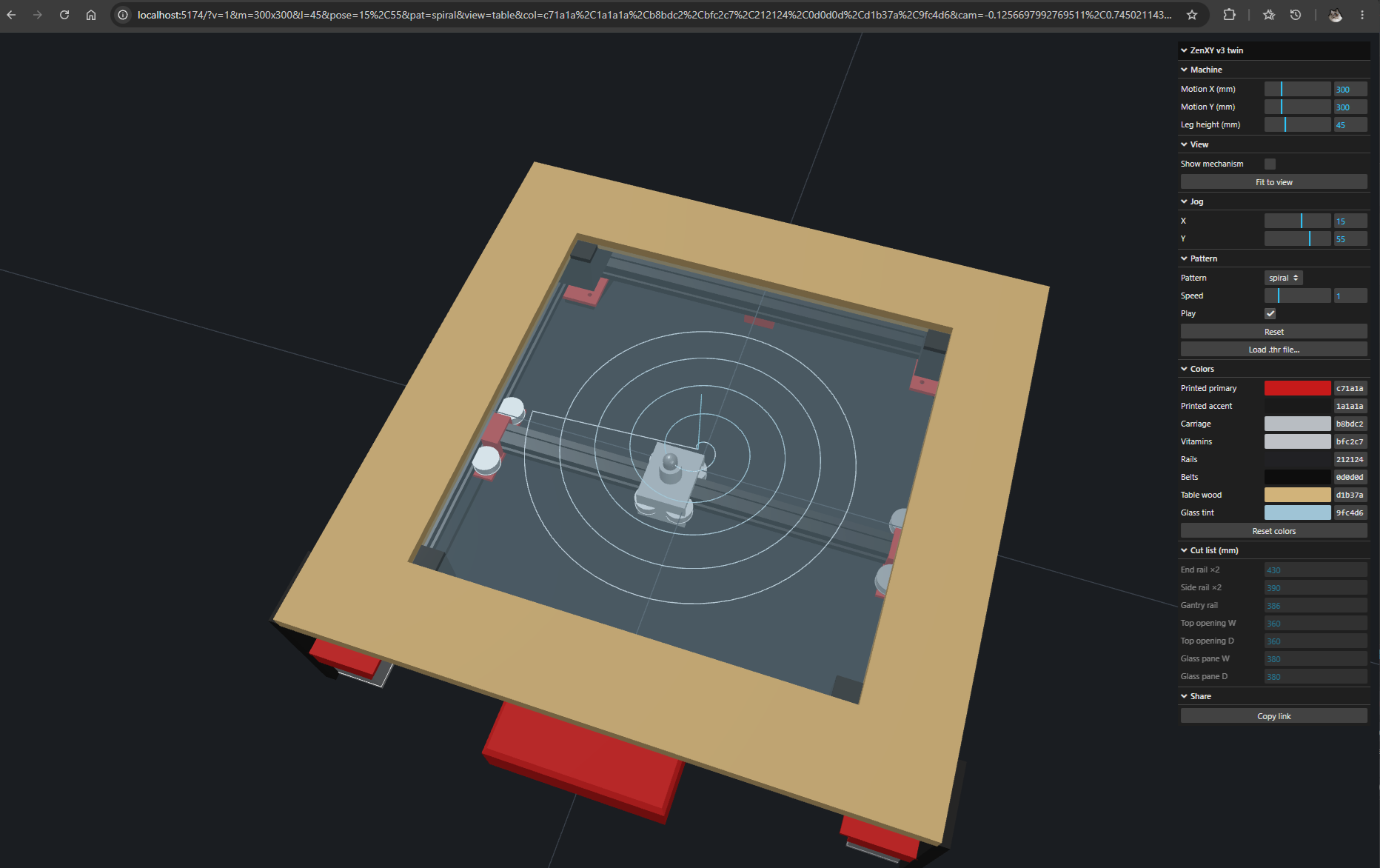

Mechanism and parts way are off, but, not bad imo given the starting point was Ryan’s unveil pic and v2 stl models.
Builds on @jamiek’s big_arm CAD twin and some other projects I’m working on.

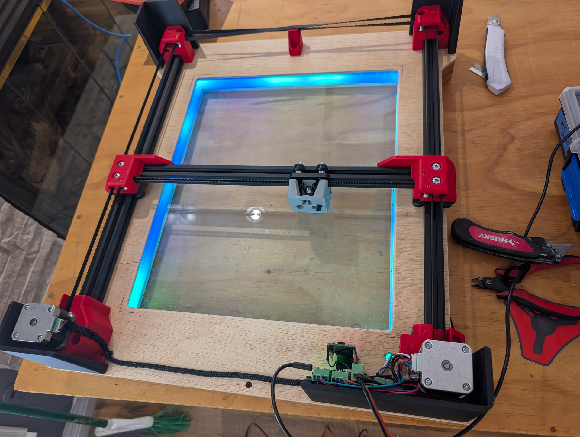

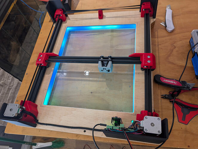

Just to give more detail now that I know it works for longer than some short tests. I tried to make this easier to build, and easier to put in a table, and more importantly, easier to set the endstops. While the endstops and belt stuff is simple, I still do not think it is elegant. I am done with it, though, since the belts and endstops only get fiddled with once. This is what I could do with the time I am willing to spend on this. I am excited to start testing another hardware project so this needs to get wrapped up.
It does have a 20mm smaller footprint so I am going to make some v2 to v3 spacers for anyone updating a v2 table.
I don’t think this needs a “beta” round, but I guess I will find out when I release it if I caught all the little gothcha’s. I started getting parts for an initial round of kits so hopefully when the files are ready the parts will not be too far behind.
For those intending to build it is 6mm belts, 6 smooth idlers, 2 toothed, ~20- m3x20 screws, 6- M5x20 or 25mm screws, 2 of the smaller 50x50 vwheel blocks, and vwheel extrusion, same optical endstops as the previous zen.

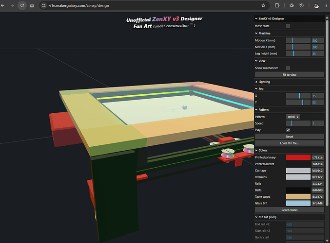

@vicious1, you sure you’re ok with this? I was thinking of adding wait list, and/or, link to your v1e shop kit when they’re available.

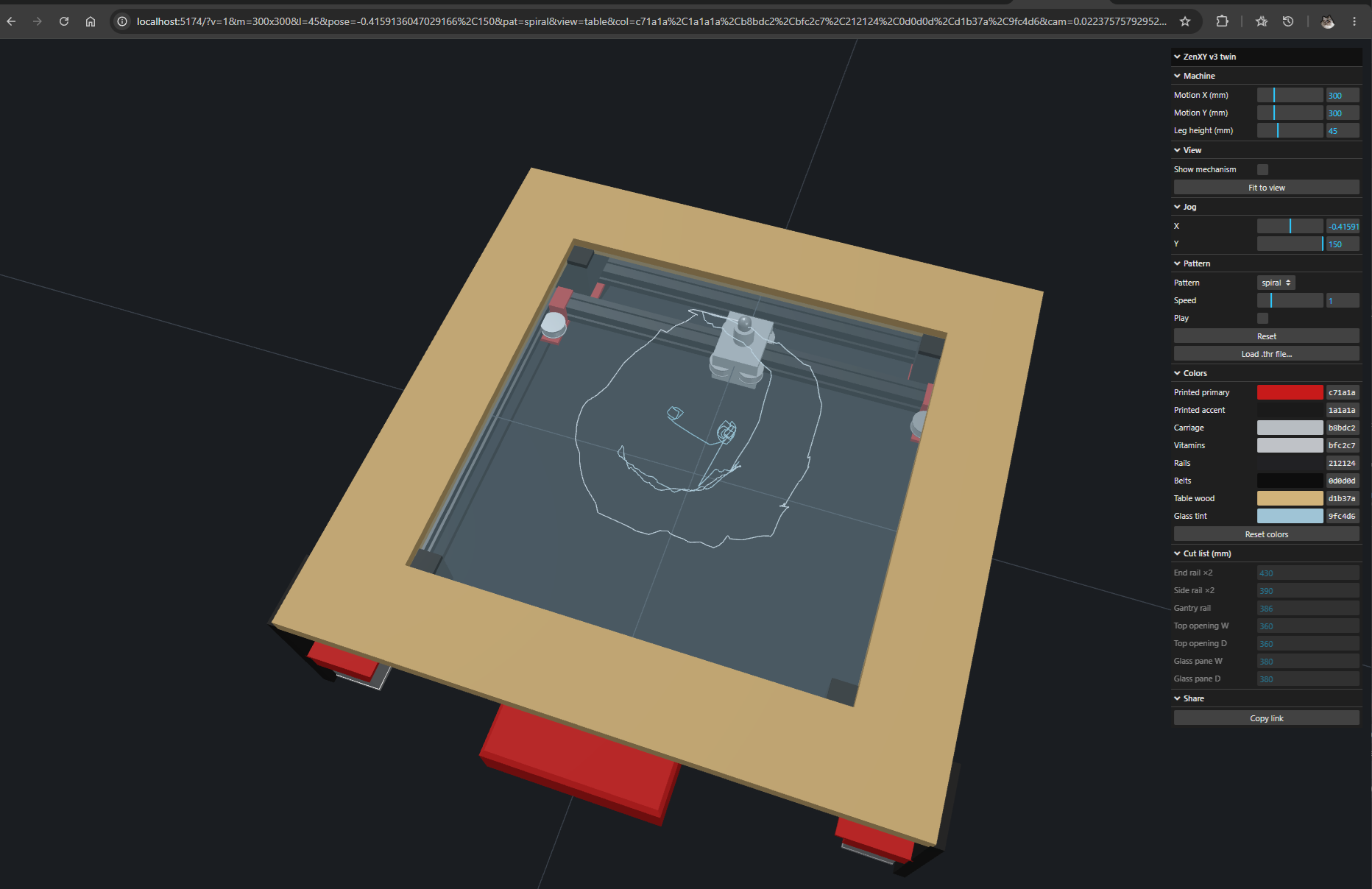

Can mouse/finger-pinch zoom in to drag the ball around.

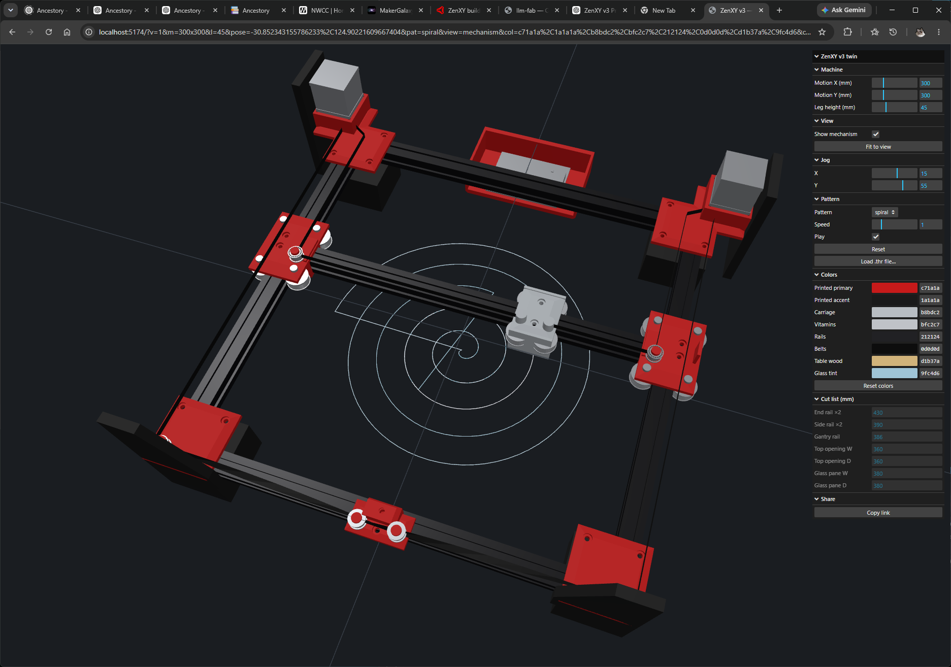

Will update my simulated and actual build as more info becomes available :man_bowing:t2: :grinning_face: . No rush, I appreciate you’re balancing a bunch of stuff.

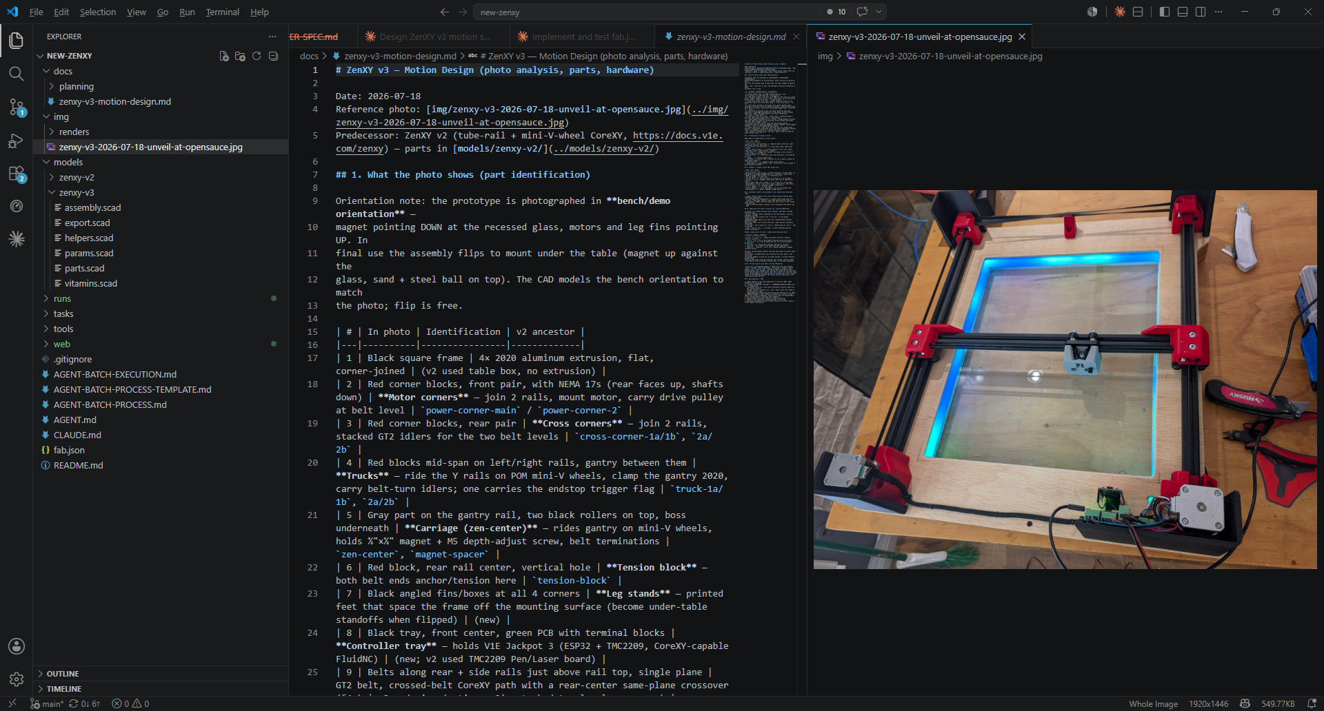

Live stream looking at Aza’s repo:
LOL, I’m honored :slight_smile: I’ll catch up in a bit, currently trying to use fable before limits reset in ~hr. Thanks again for sharing your https://github.com/vector76/big_arm work, you can see the same pipeline was use here. Code is a hot sloppy mess, I’ll share more broadly when it’s less embarrassing. But you’re welcome to dig around and chat about it. Feedback is always welcome, and greatly appreciated!

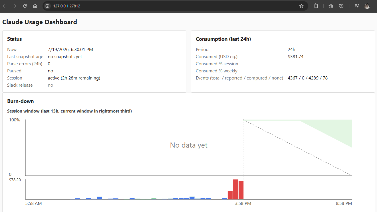

@jamiek, cheers for ptr to https://github.com/vector76/cc_usage_dashboard you created and shared…

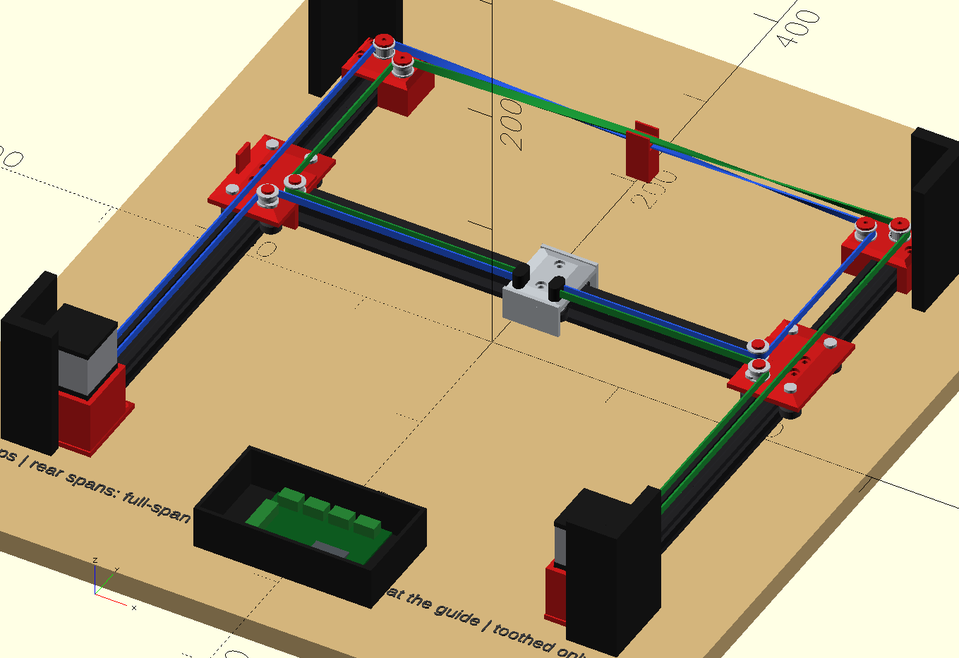

I like how I was able to get twisty belts :smiley:
Will you update the BOM into a table and maybe links to the shop or to affliates?
Guessing Ryan will update docs when he’s ready to share final design.
My guess of BOM parts that try to reference V1E shop links are probably very wrong/incomplete, https://github.com/aaronse/v1engineering-mods/tree/main/zenxy-v3#bom–parts.
