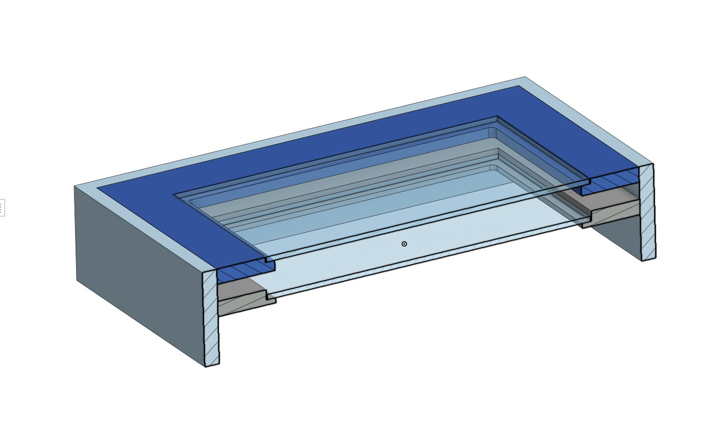

You know it is hard to come up with the simplest basic zen table box that will make it as easy as possible for others to use my CAD. There are a few ways to hold the bottom glass.
Anyone have any pictures of what they think is the most basic box?
The most basic, I think, is a routed in lip to hold the glass for the top and bottom, and 4 sides, like this one.
If you wanted to get more basic you could get 2 identical blocky picture frames and screw them together, but I don’t really see anything else simpler than what you built there.
I think this conveys all the important stuff?

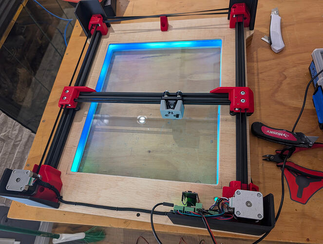

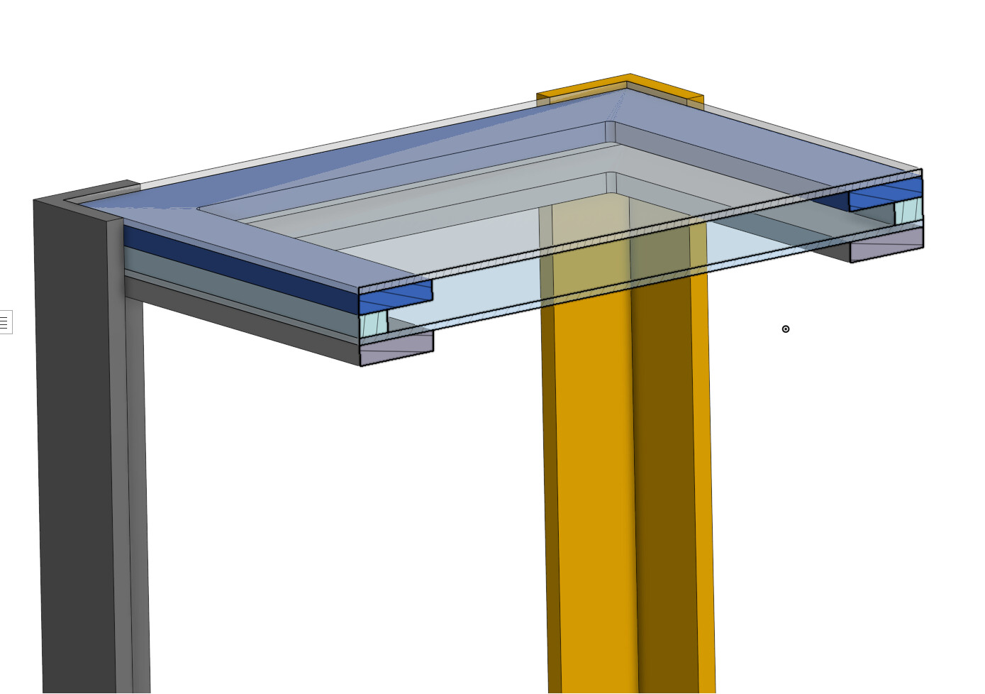

I think I should show an example of my large table with the edge to edge glass, just in case.
If someone has only a jig saw maybe they can make it this way with printed brackets?

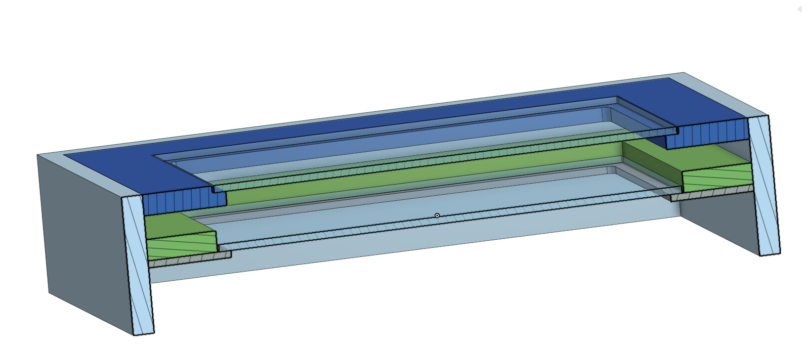

The one I brought to Open sauce was actually a 1/4" sheet of ply, as the glass holder, and a 1/2" ply sheet to catch the sand.
So I guess I need a third drawing.
Still need a router for the top, unless you find a sheet the same thickness as your glass…or a second larger sheet of glass.

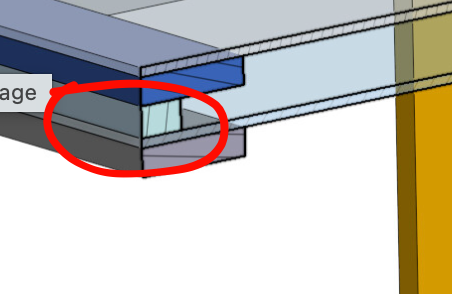

May want to keep your glass from going all the way through.

I think I see the process now, looks like you can lift the sections easy like a car hood. That is a really clean design, I like that a lot.
