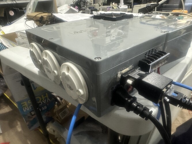

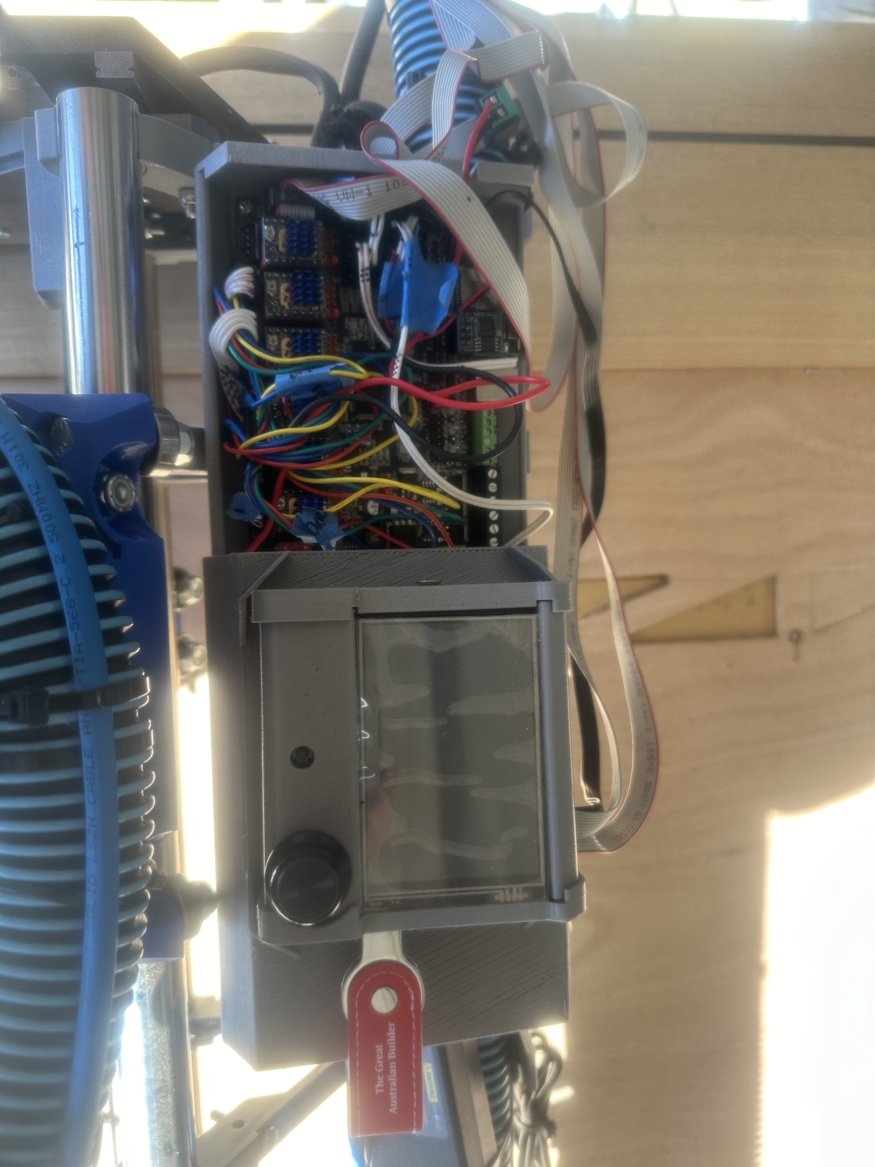

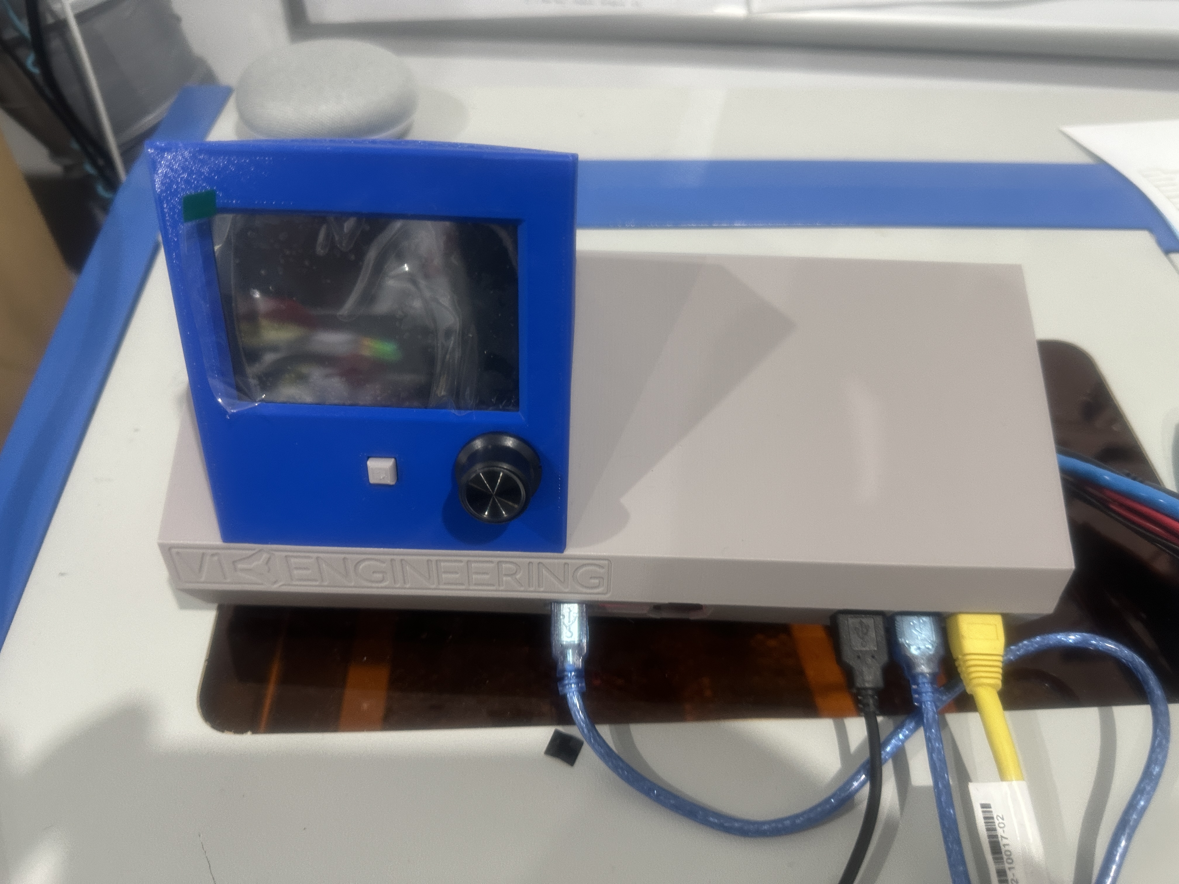

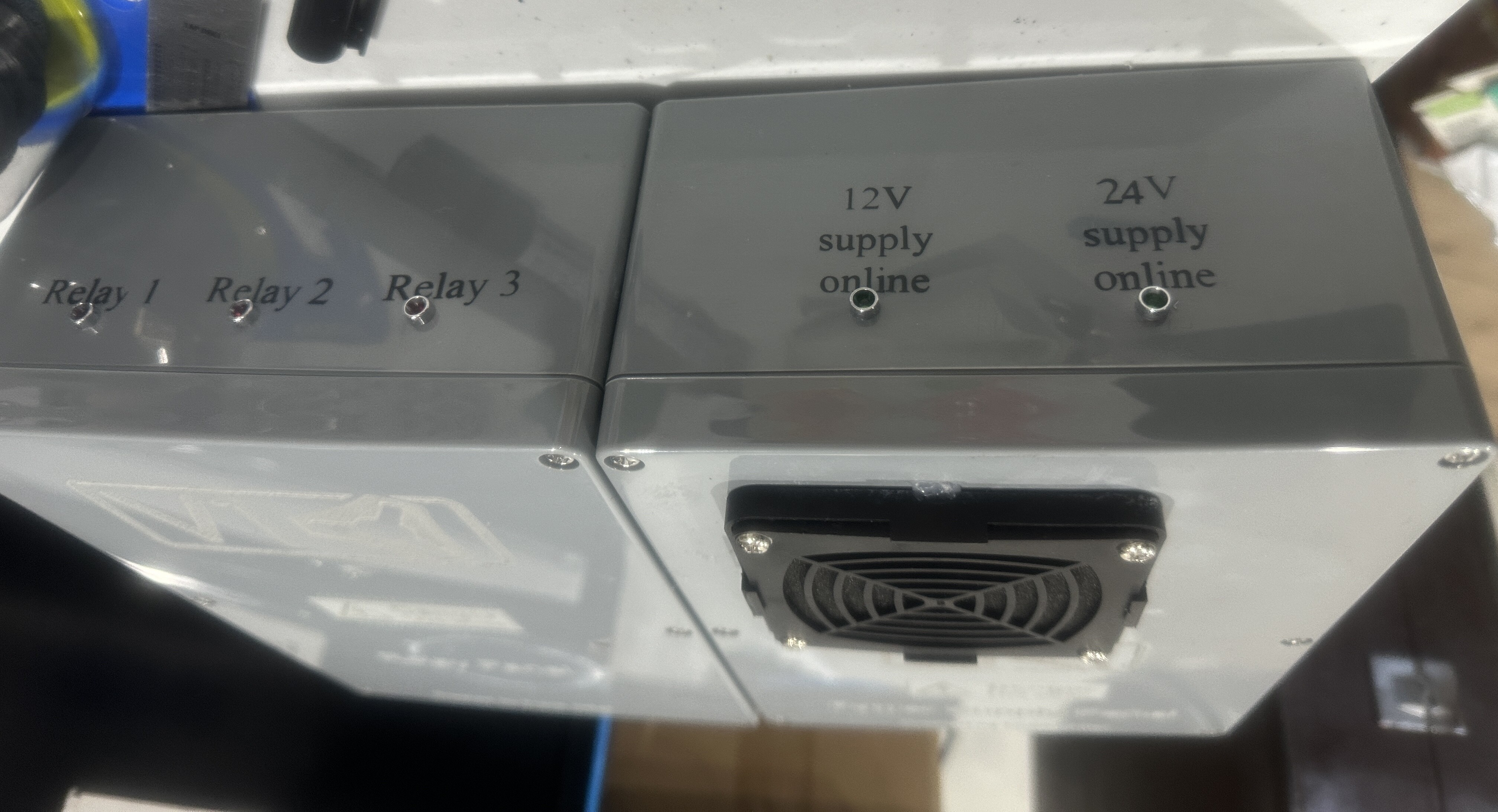

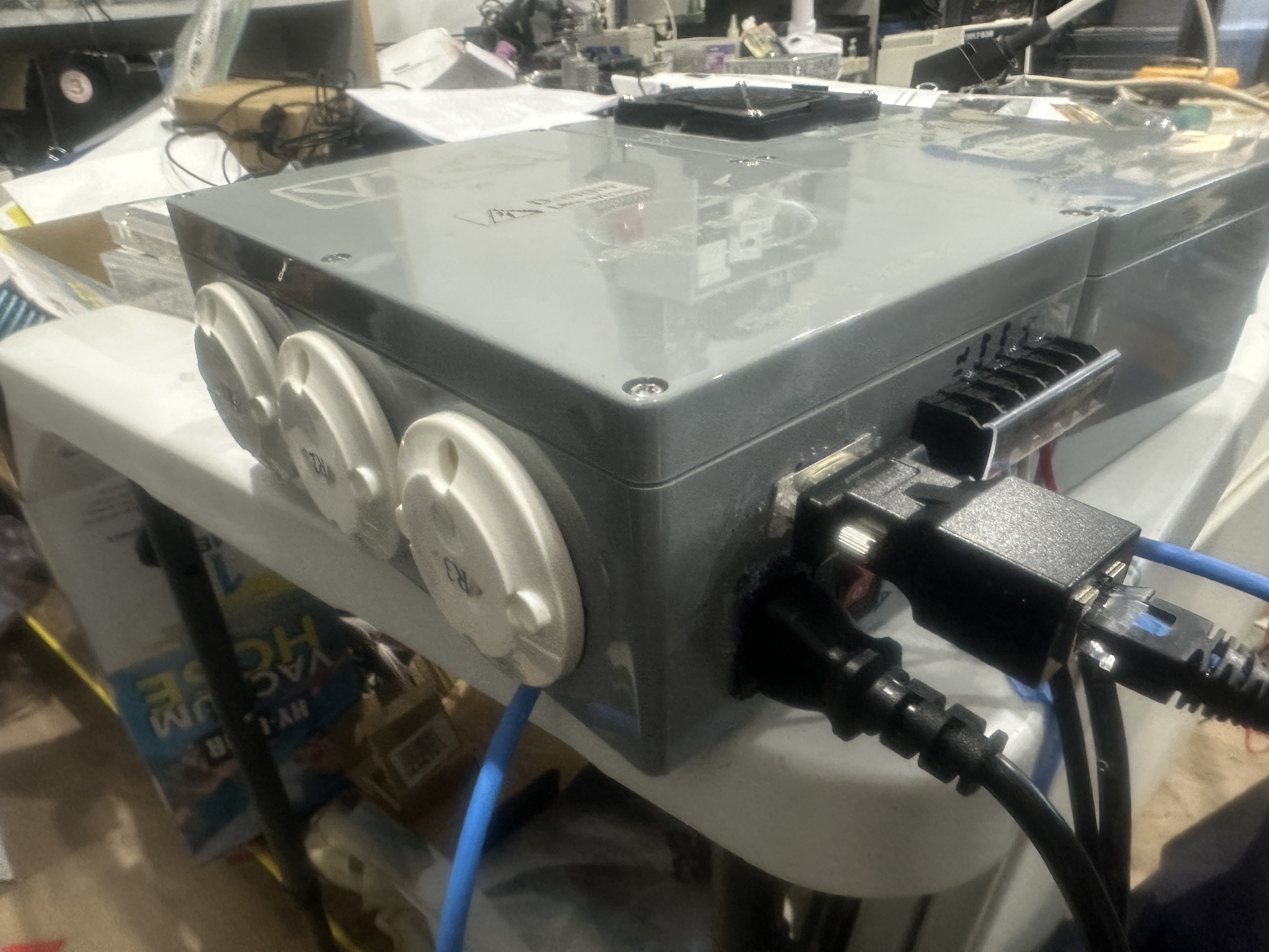

My controller (skr pro) is currently a mess lol, wires everywhere!
I have another skr pro in my test lab which is also connected to rpi. Once the struts are printed I was going to transfer this to the lowrider. As the skr pro in there now is just to get it going for now.
Still it’s the same skr pro v1.2. But just wanted one for a test bench for testing purposes, who knows might build another lowrider in future lol
The test bench skr pro, I have it wired to another control board which turns on relays, with dual supplies, etc. but wanted to get the one in the lowrider going first before I go to advanced mode lol

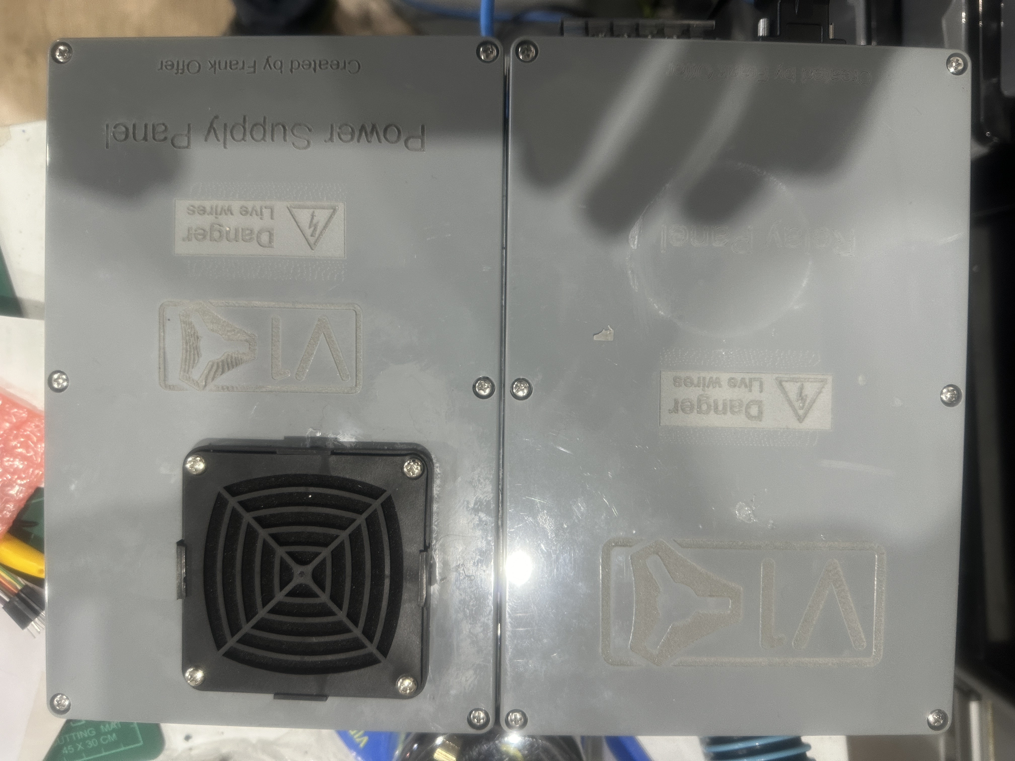

Here is a pic of my test bench skr pro, which will eventually replace my current setup once the struts are done.

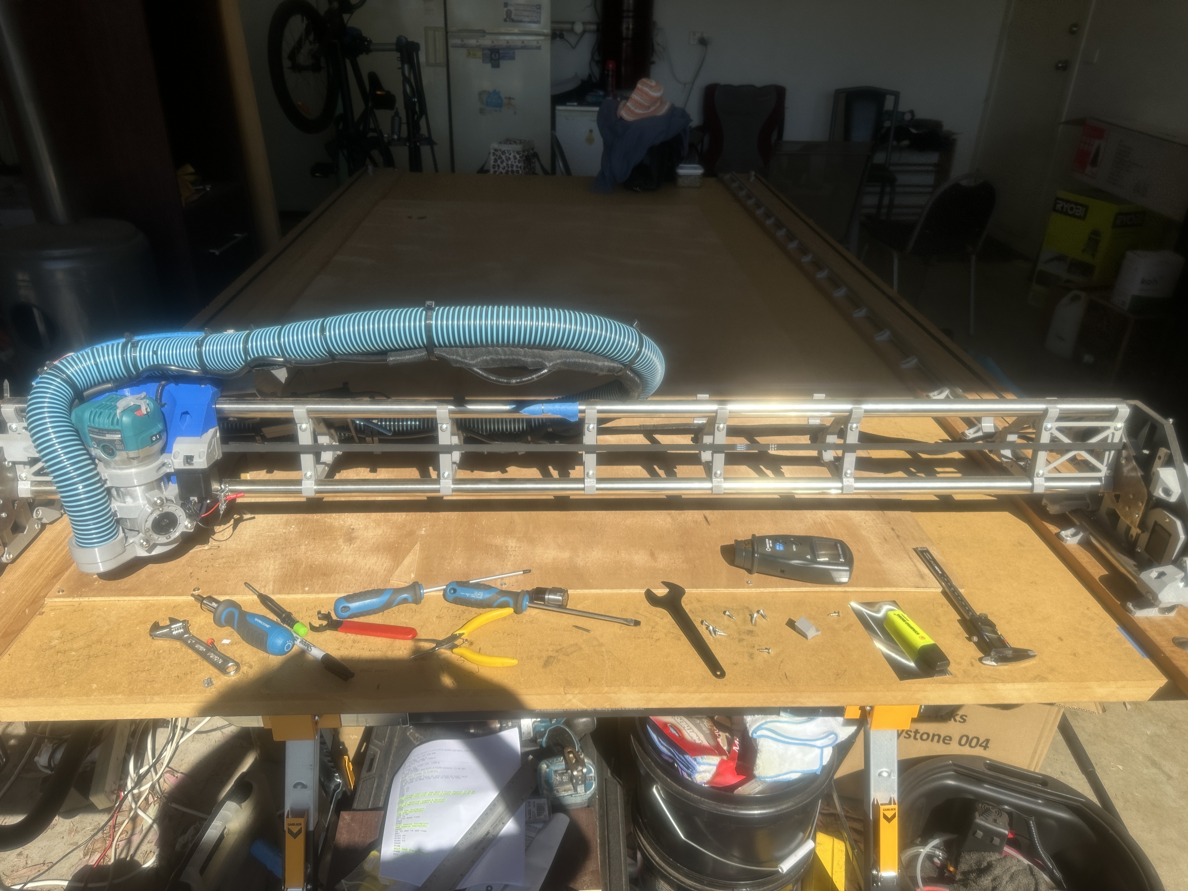

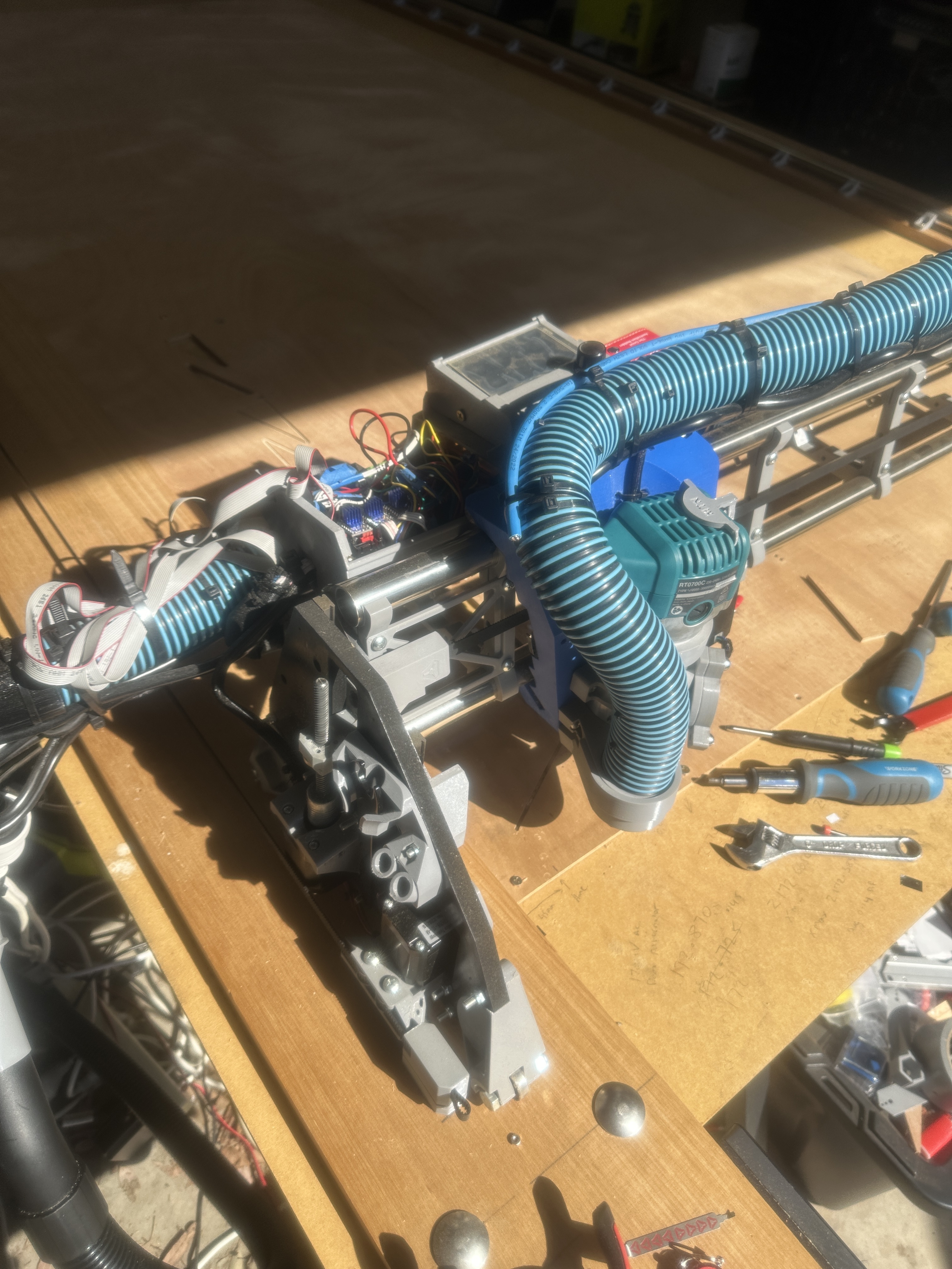

And this is my current (mess) setup lol on lowrider3

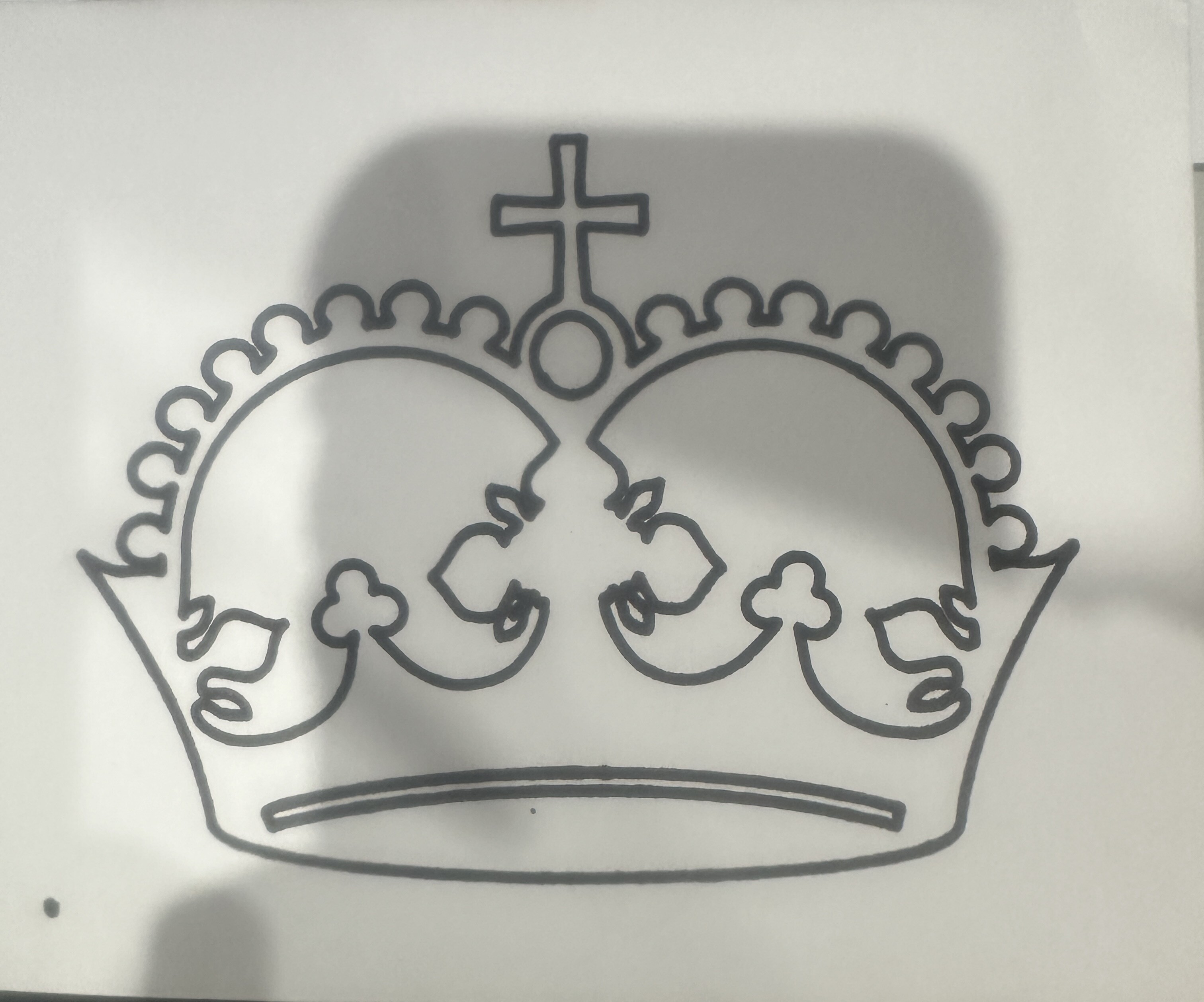

So i guess this rules out PP for now? I have everything set up on estlcam as per the Estlcam Basics & Milling Basics on V1E setup.
Have done my crown (paper did move slightly during the drawing), here is a pic:
The only thing i can think of is maybe my bed is way out, intially during the drilling, it had a clearance plane of 2mm which did hit the surface when it moved to drill. Hence why i changed clearance to 30mm.
Maybe this is the issue why its drilling deeper? as where im probing (HOME (Xmin/Ymin) maybe a low point from approx 100mm towards Ymax and 100mm towards Xmax? But when i sit a spirit level on the bed its all reasonably level which throws me out?
Ok I think that is the problem. Xmin/Ymin is lower approx 6mm from roughly the centre of the sheet.
It sinks down approx 6mm about 200mm towards Xmax.
So I’m gonna try probe Z where it’s level. And see if that’s the issue
@Ryan so I used upcut bit, set Makita on 1 and it seems like it’s struggling to cut plywood.
Does this need to be set higher on Makita?
I found the downcut was cutting nicer except for the depth issue which I think I may have found the cause as per my last post.
It struggled and pretty much seized in one spot.
I’m going to get rid of the collet extension as I think that’s just another variable.
So will need to add another bed as per my plan to get height
1 is too low. Use 3-4, don’t go too fast, plywood is hard because of all the glue. :slightly_smiling_face:
Are your legs the same lengths? Mayne one didn’t get seated to the same depth? I hade one move when i plunged without the router on and pushed the whole x y o ut of alignment. Not sure how that would happen to a lowrider
Legs?
I know mine sometimes is temperamental.
Like if I sometimes click home on the tft. It plunges down all the way, popping the leadscrew nuts.
Not sure why it does it only sometimes, most times if I click home it does what it should. Guessing some sort of bug in the firmware.
