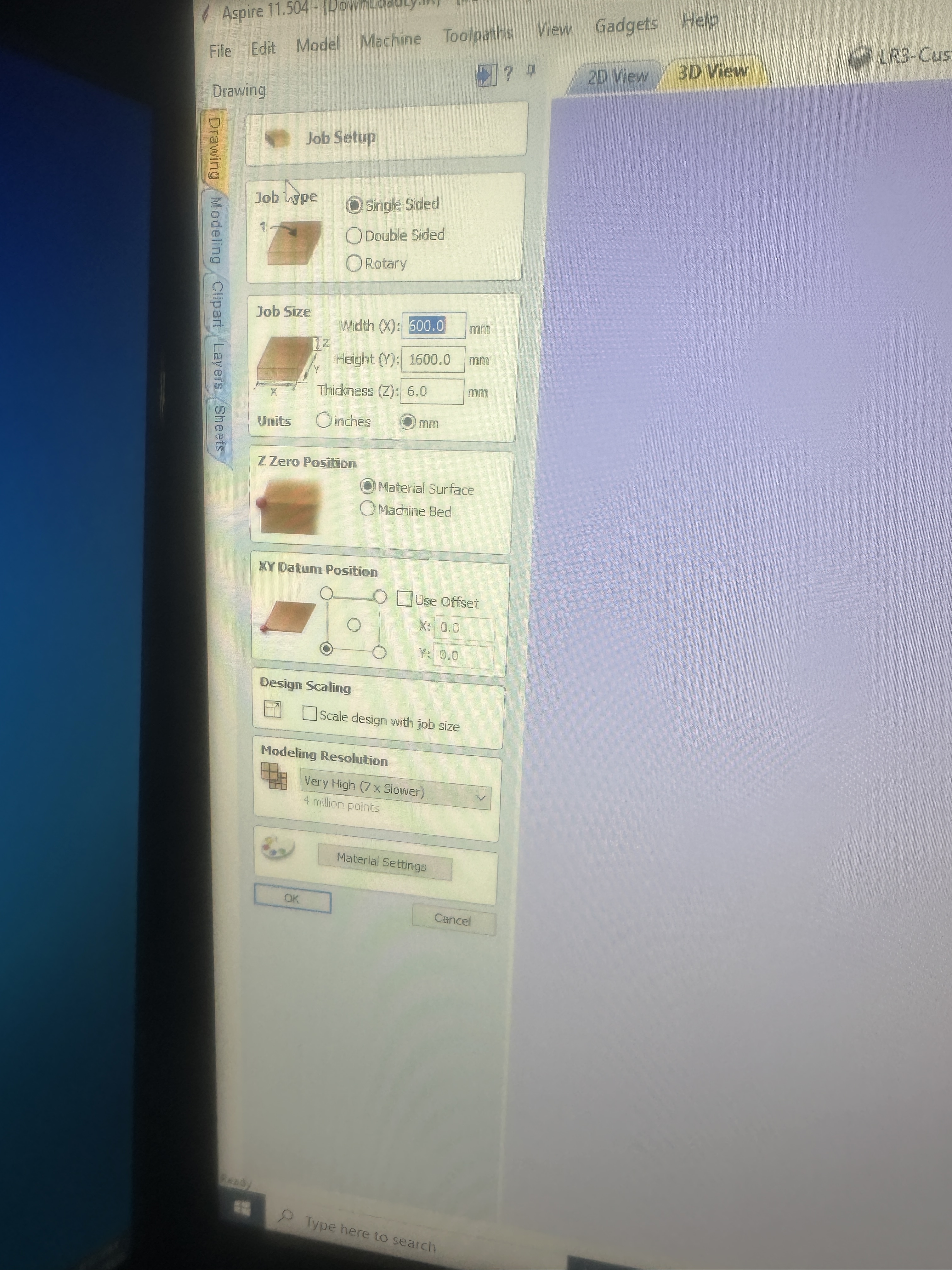

Not sure what I’m doing wrong here.
Using vcarve I set material 6mm and cut depth 6mm.
However when I’m cutting the strut and doing pilot holes.
It’s drilling 13mm. (6mm material + 7mm into spoil board).
I home Z, then use touch plate on top of material and have vcarve set to Z on top surface.

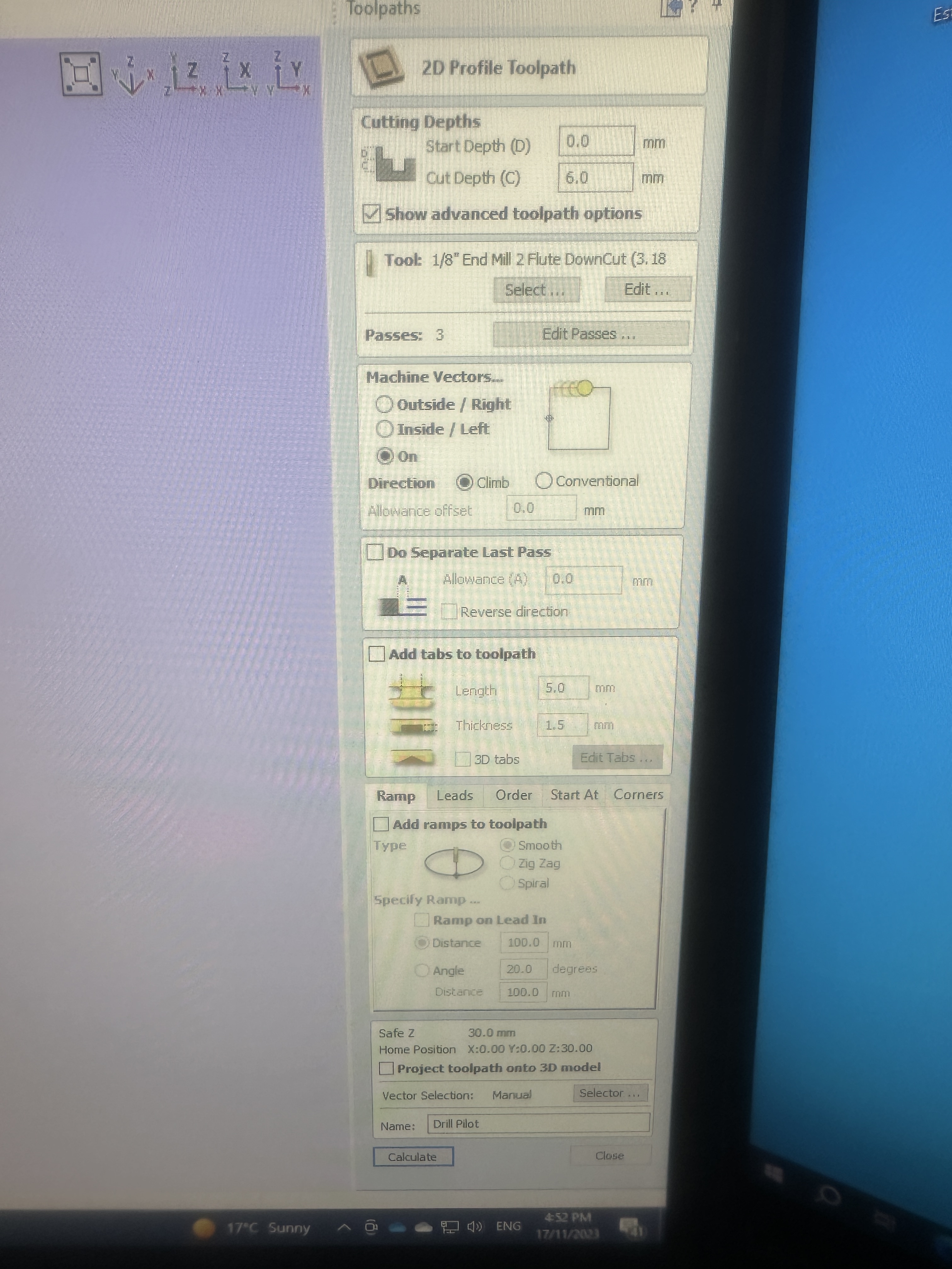

It must be in the vcarve software then. Maybe some screenshots of your settings? I’m not familiar with it, but others here are.
Not sure what else settings you need
But that’s one tooltpath, all other tool paths are set the same

Okay. Check vcarve gcode. Use a gcode preview program and see if it shows double the thickness cuts. This should quickly tell us if something is wrong with the CAM software
OK using NCviewer. it seems correct.
3 passes Z-2.00, Z-4.00, Z-6.00 for all toolpaths
So if im probing from touch plate on material surface (sets at Z0) it should go down 6mm but its doing nearly double?

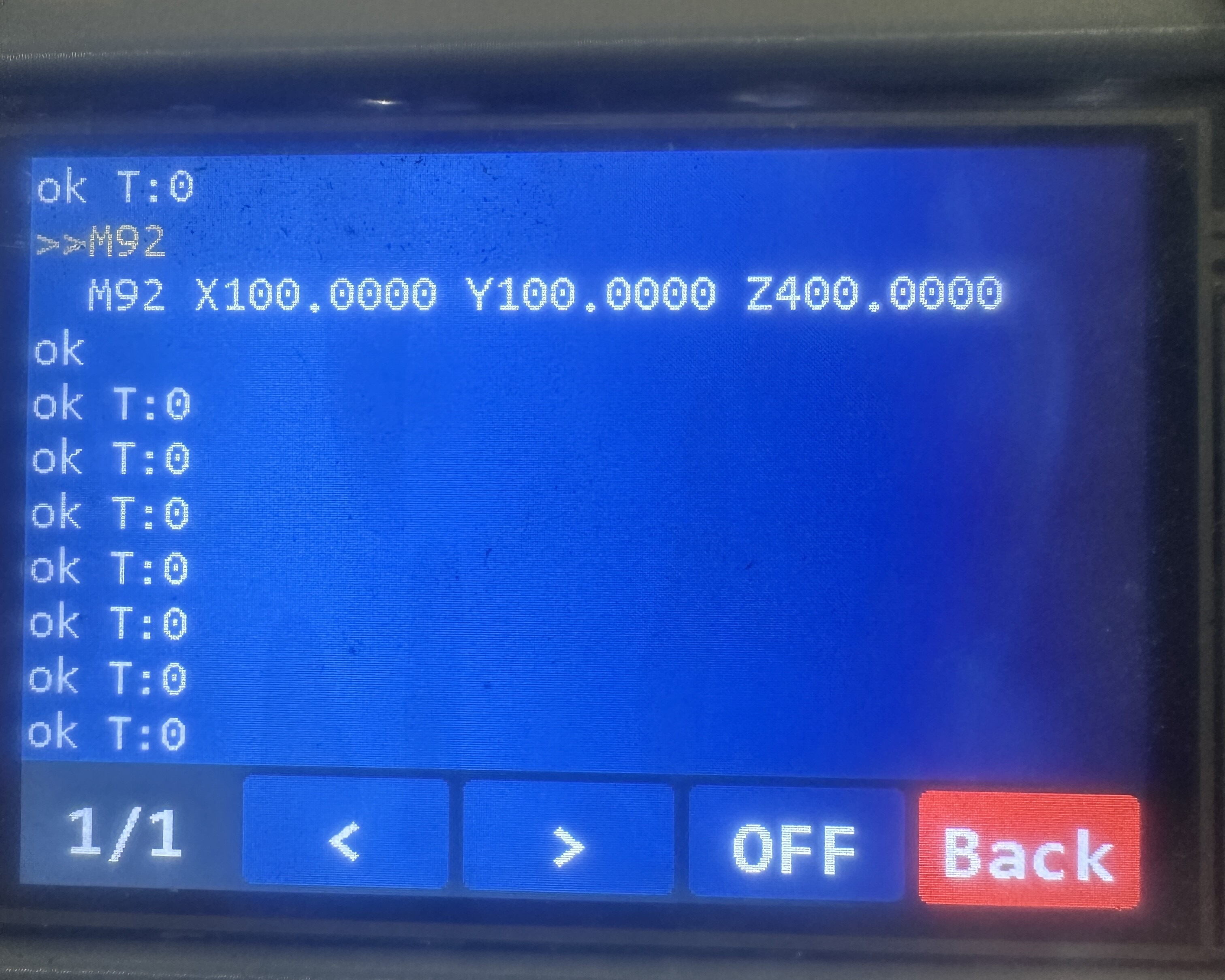

I have the T8 4start lead screws.
Might need to check firmware if this is set correctly, but it should since if I move 10mm or 50mm from tft screen it does move accordingly.
What should my settings be if I do a M92
