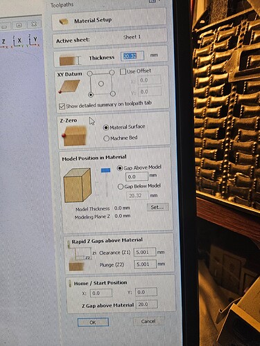

Z levelling

This is for vcarve not fusion :wink:
That means it is one of your CAM settings. Check your Z speed and Z rapid speeds. Starting level, Setting the Z=0 anything relating to height.
Yeah I have re-adjusted all that, will give this a go and see its depth and will report back :slight_smile:
Ok so I have slowed everything right down, and still goes down 12/13mm
This is on the tool path materal setup side make sure that the model position iis still 0.0
How are you setting your Z zero for each job?
Using touch plate
G38.2 Z0
G92 Z0.5
This is at start of gcode.
Can you cut and paste the first section of your gcode so we can figure out why it is not working. There has to be something before or after those two lines.
Check the setup on the toolpath side these are on the drawing side

That’s the gcode.
Yeah it’s set as gap above model, 0.0mm
Just making sure i have had that problem it is like setting a start depth
Yep, I wish it were that cause that would explain everything.
