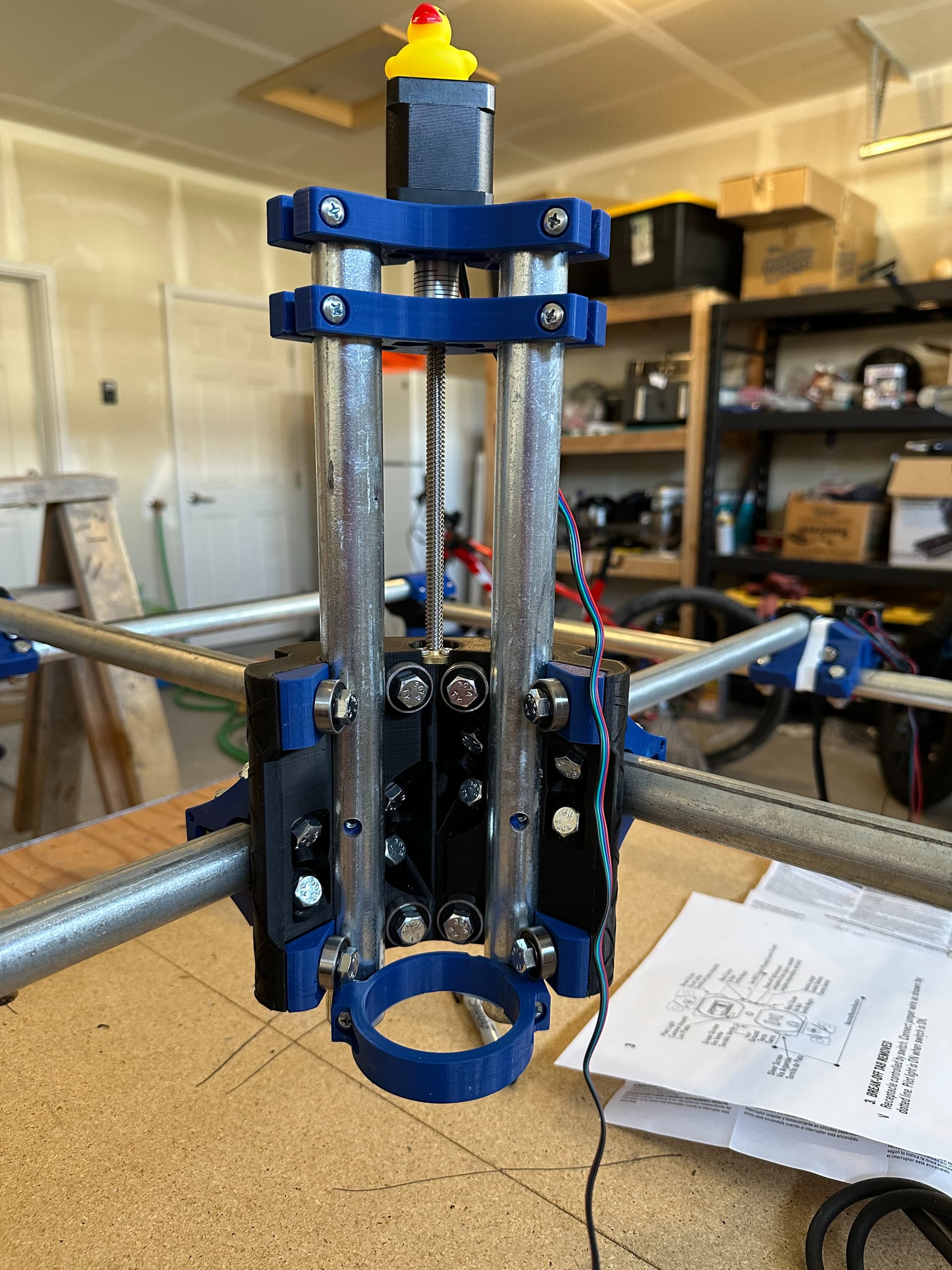

I got everything put together and was testing out movement. My Z axis would only go down a little and I saw that the tool mount for my router was hitting the bearings on the core. So I thought I just needed to remove the mount and lower the Z till the mount would be below the bearings but that only gives me about 5cm of travel on the Z axis. I don’t know if I’ve assembled it wrong or what the deal is.
Here you can see that if the top mount is installed, it will run into the bearings going any further down.
With it all the way up, but that only gives me about 5cm travel. And if I position the mount below the bearings, it will be the same, only about 5cm travel.
That doesn’t look like the correct tool mount for the Primo. Which router are you trying to mount?
The Kobalt one. It was the only Kobalt mount I could find on Thingverse.
Yeah that one looks like its for the LR3. Try this one…
https://www.printables.com/model/632967-kobalt-mount-for-the-mpcnc-primo
Make sure you have the 2 plates that go behind the mount as well

@Mahola419 are you sure you are looking at the right size printed parts? If you have a Kobalt I assume you are in the US and most of us use 3/4 EMT so that would be the 23.5mm parts
I was pretty sure that’s the one I was looking at. It’s 3/4 US Right? I completely missed the kobalt option. Thank again everyone. You guys have been extremely helpful to a newb
