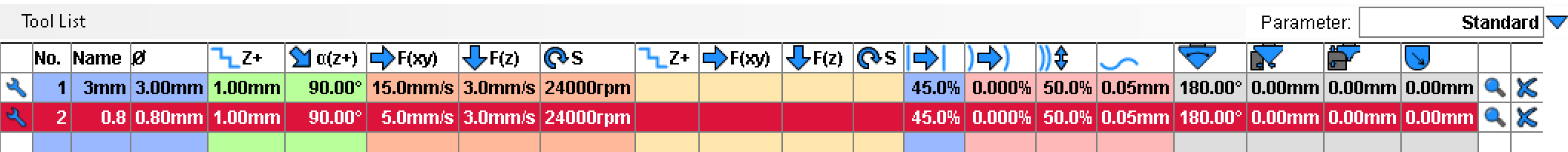

Sorry to resurrect a 4 year old post. But I’m having this issue today in 2020. I am using the latest version of Estlcam 11.224h. My machine was working flawless for weeks until now, and nothing has changed as far as I’m aware except the Estlcam version.
To troubleshoot, I took the t-screw completely out and greased it and I still randomly get this plunging problem.
Do I need to upgrade my firmware? I still have the original Marlin firmware from back in 2016. Maybe it’s a power issue with missing steps?
Settings below:
Not sure where to start to be honest.
Is the Z travel speed set, and do the G0 Z commands have a speed set on them?
I have the Z travel set in the tool settings in Estlcam.
And it looks like the gcode has a G0 Z command has a feed rate on it at the beginning.

Each time this has happened it has occurred at either the beginning or end of the print. But it also happens randomly. Sometimes the cut will come out perfect. Other times it will drill deep into the workpiece into the spoil board and break the bit or cause a fire hazard.
That first move is F2100, or 35mm/s. If that has a Z move involved, that is too fast. F480 is 8mm/s, which is usually fine, unless you’ve got extra resistance in Z.
Do you have any F2100 moves at the end of the gcode?
Yes, there is a drill move at the end of the GCODE: G00 X90.0000 Y0.0000 Z5.0000 F2100. Any idea why Estlcam wouldn’t inherit my tool settings for the Z-move when generating this GCODE?
Colts1mm-blackcut.gcode (10.4 KB)
It looks like that speed is for Z positive and is inheriting that number for the rapid feed settings in ESTLCAM. So it’s going 35mm/s upwards, but more slowly (F480) when it goes down. :face_with_monocle:
Weird. Is it hard coded in the start/end gcode?
