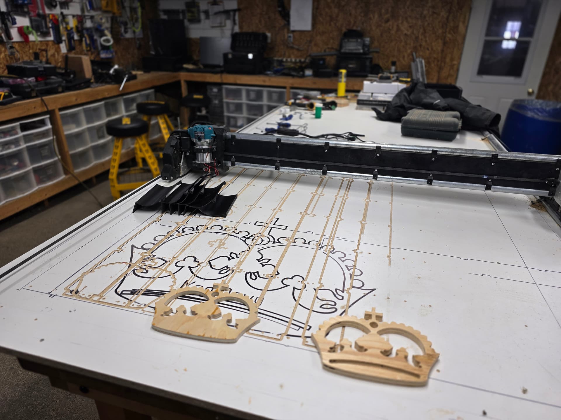

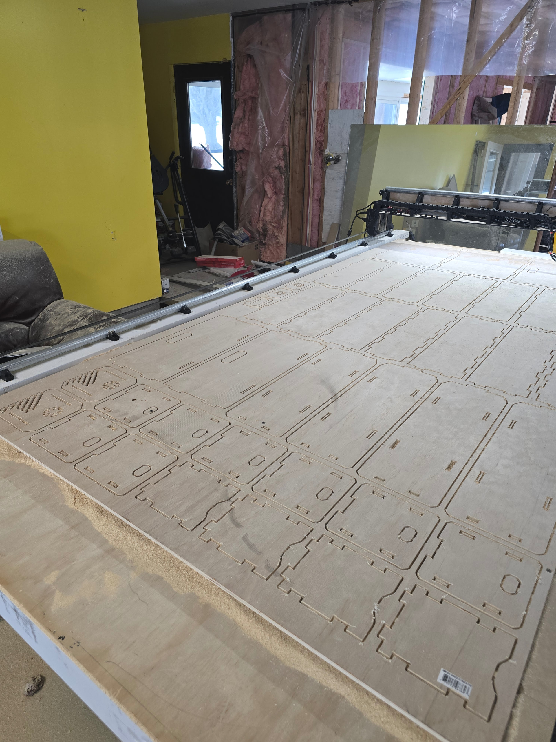

Update: Well it only took about 12 tries lol but I finally got my strut plates cut
Have to say after taking things apart and reassembling numerous times (Brilliant Design Ryan )
Made a number of test cuts that at least I am pretty impressed with lol 1/2” and 3/4” ply crowns cut edges are nice and square
I hope to improve as I gain more experience but I think I am almost ready to try massacring some plywood shop cabinets.

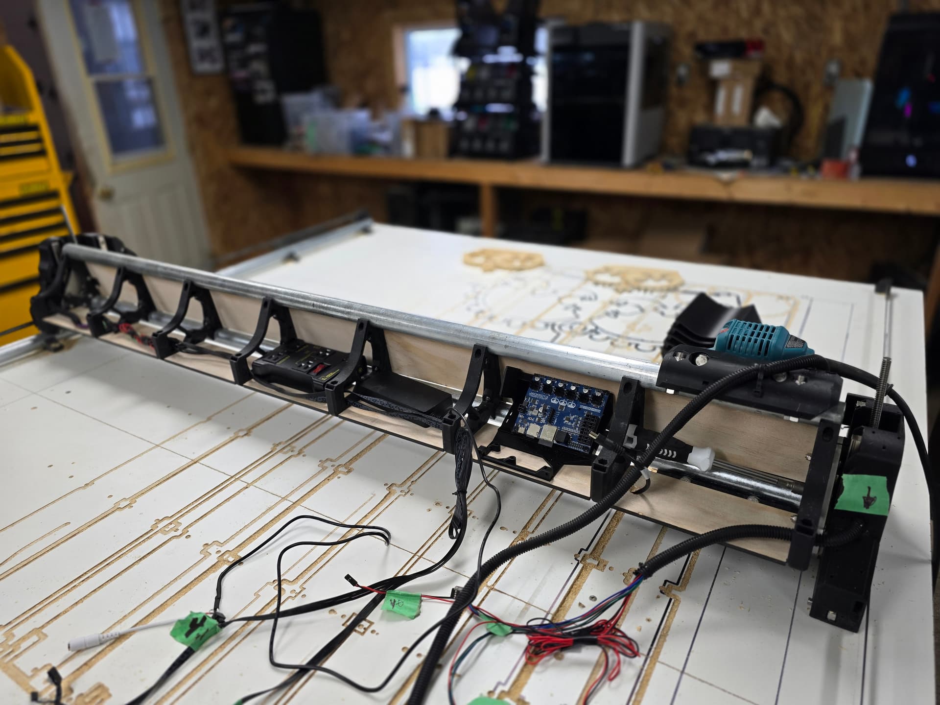

I am ready to finalize gantry wiring but because I have had to remove my side plates a few times (taking the core on and off) and expect I will likely have to do so again in the future. I wasn’t going to mount the jp3 on X0 end (so the 3 lil plate nuts are accessible you can see my nut driver in the pic).
I also purchased a Digital Loggers IoT relay and am just not quite sure how best to place and wire them all up so that everything functions well and is hidden in the gantry.
I definitely will want to add drag chain setups to all the wiring after I finish the table.
So hoping not to having to move things around too much later.
I humbly ask the pros how would you lay this all out and wire it up
I also would like more info on the JP3 specifically the 4 Outputs, 5V(full PWM capable) or 24V(PS input level) outputs (only basic PWM).
  • Are these always on at 5v and 24v or are they determined by boards input power?
  • Are they triggered by firmware when called or always on?
  • What is the USB C port used for?
  • What is the 7 pin riser used for
Also where the green tape is I have my wires all in a loom but they keep sliding up is there a mod to affix it to the side plate.

one side is always 5V, and the other side is whatever voltage your power supply is (12v-24V). one output pin severs both at the same time. so if you turn on pin 0 both pin zero ports go high. Most will only ever use one voltage per pin, and that is the way it was designed, although you can use both is you want and are not using PWM. make sense?
You trigger them with macros or gcode. you can set them to be on or off at boot.
Flashing the esp32 if you have issues with the OTA stuff.
There are links in the instructions about this, they are fluidNC modules. Bart Dring makes a whole assortment and there are a few others. Links in the instructions.
You can just loosen the brace top screws and slide the top rail out a little bit. Core comes right off, you do not need to take the side plates off.
That also needs to be prominently stated in the build documentation with pictures showing it.
