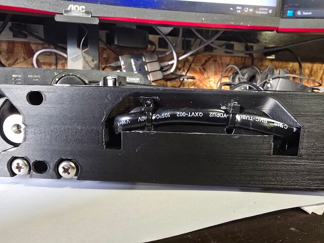

Thank You both great simple solution with the tape dan :+1: Im looking forward to it too but have a ways to go yet. since i have busted the flaps I am considering drilling a couple tiny holes and using mini zip ties to keep them in the pocket I think it may work but ill update on my progress. Have great day all

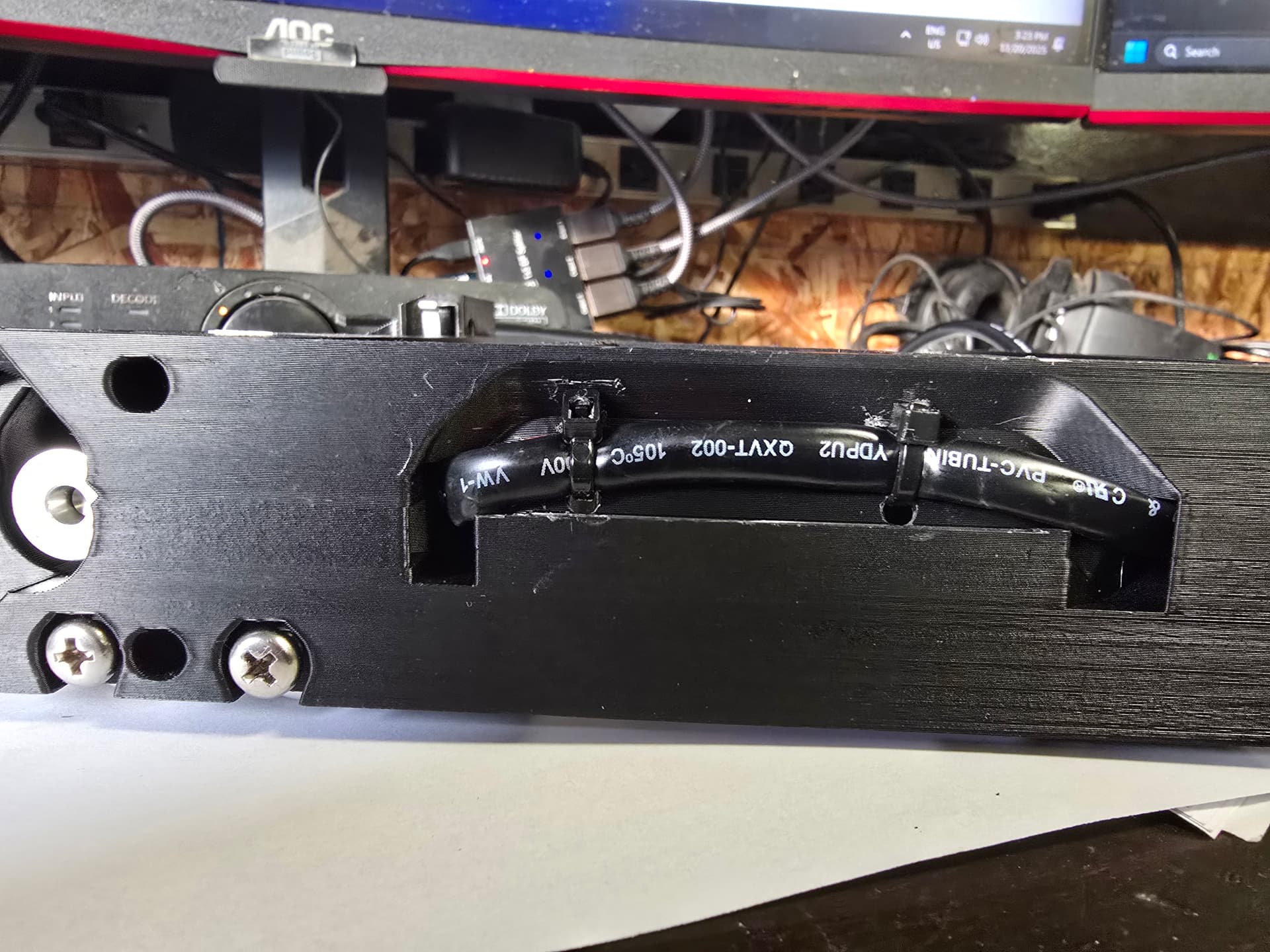

Ok here is my quick fix. lol I know its ugly but I think it should work unless it gets hung up on some part I have yet to get into. the zip ties are not sticking out past the bottom. Any thoughts?
Or should I just print a new part and remove the sheath from the stepper motor cable
I’m not going to be able to run my shielded cable through there I take it? hmmm :thinking:
Well unless you like reprinting parts :frowning: then you are prolly better to take the shielding off and go with the guide method
If it’s stupid and it works it isn’t stupid… :smiley:
Lol nice one Phillip almost makes me feel better about my hack
Story of my existence :slight_smile:
That will work fine.
Lol i feel you jim thank you for the feedback
That’s not ugly! It’s custom!:rofl: Those zip ties are fine no one will see it once assembled.

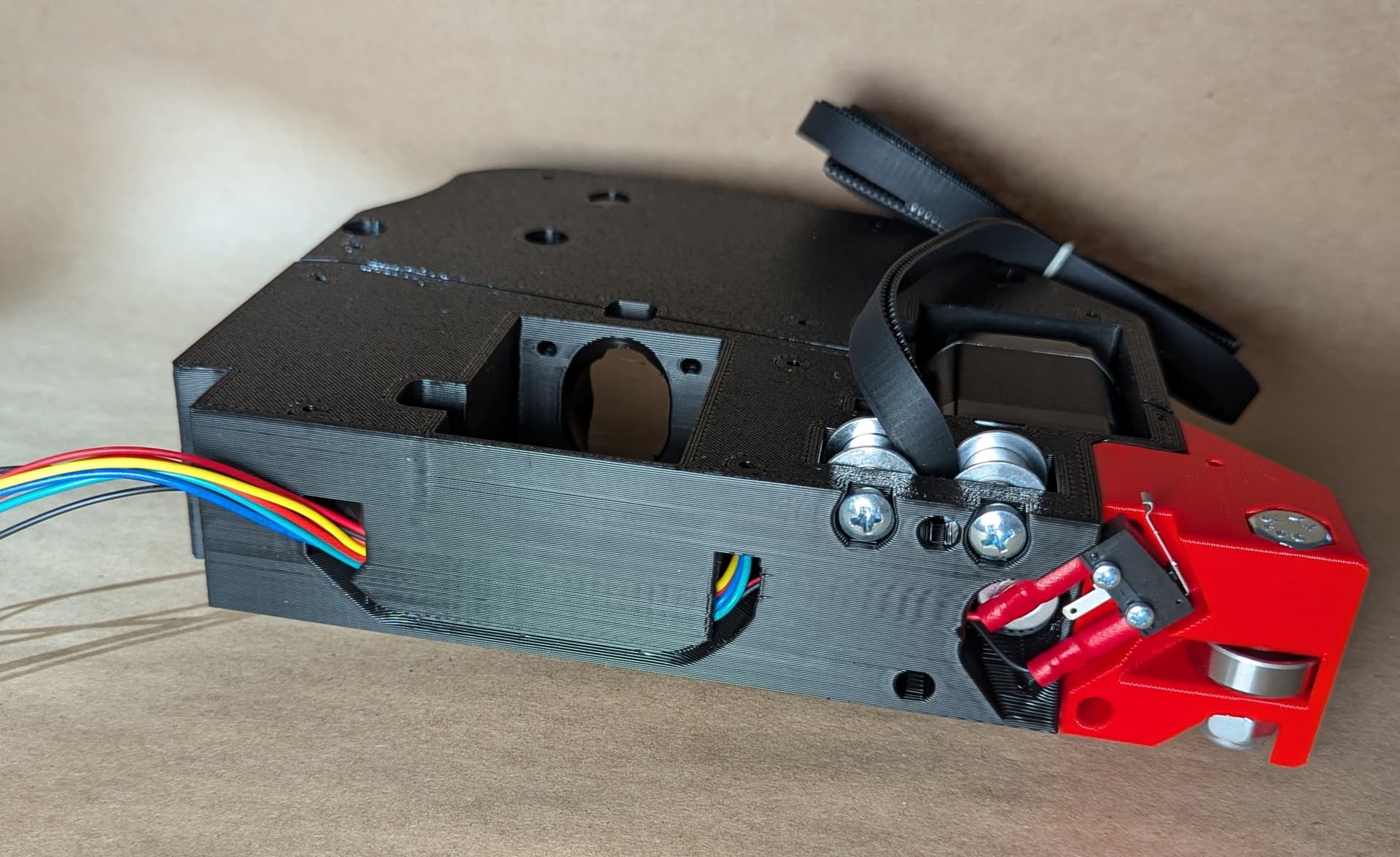

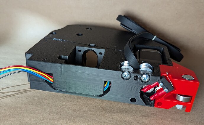

While I am waiting for parts I printed a new PETG-CF core and as I am switching parts over to the new piece. I rewatched the video closer at the 3:45 mark
https://www.youtube.com/watch?v=KLDDJx-OUmQ
In doing so I noticed that the limit switch in the video has a little roller wheel. I do not have any limit switches that look like that in my kit.
Is this an upgrade option for all the limit switches or just used on the core?
am I missing these pieces?
Should I order some and replace them all with the wheelie bar ones?
Thanks in advance
The ones with the rollers are worse, I used them first because they are easier to get but have since switched.
