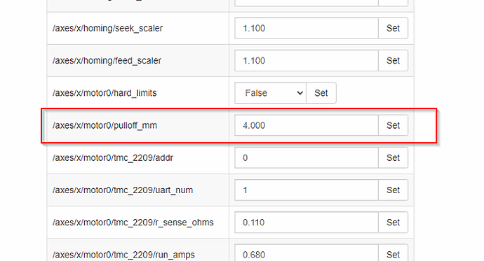

Yes I have quite a few times but I’m just not getting this part Auto Square “editing each endstop”
By what method do I determine the correct values to edit into the config file
I have the pulloff value set as shown.

Auto Square
Auto Square on this board is as easy as editing each endstop individually directly from the “Config” section of the WebUI (or directly to the yaml file).
!CONFIG WebUI
From there you have a “pulloff_mm” setting for each endstop. This setting is how far the machine backs away from the endstop after it triggers it. This needs to be far enough to reset the trigger at a minimum and if your values should be within 3mm of each other. If they are not it is best to move the endstop triggers.
!CONFIG pulloff
Be sure to save your edits at the bottom of the config screen, and then by also using the red save button (macro) on the home screen!
Do you have a v bit? Best way to do it is put down 4 pieces of blue painters tape (or whatever tape) and manually drive your machine to the farthest 4 corners of the table. Go down in Z on each corner just until the bit touches and leaves a tiny mark. Then measure diagonal to see how in or out of square it is. From there we can help you make the pull off adjustments.
For Z you home Z and move down and probe with the touch plate (if you have one) on each side X Min and X Max. Then see which side is moving farther than the other, take the difference and add that to the pull off on the size that moved farther. For this one probe a few times and take the average. Do your best to not move the touch plate at all.
I am sure someone else can explain this way better than I can. But I did my best :partying_face:

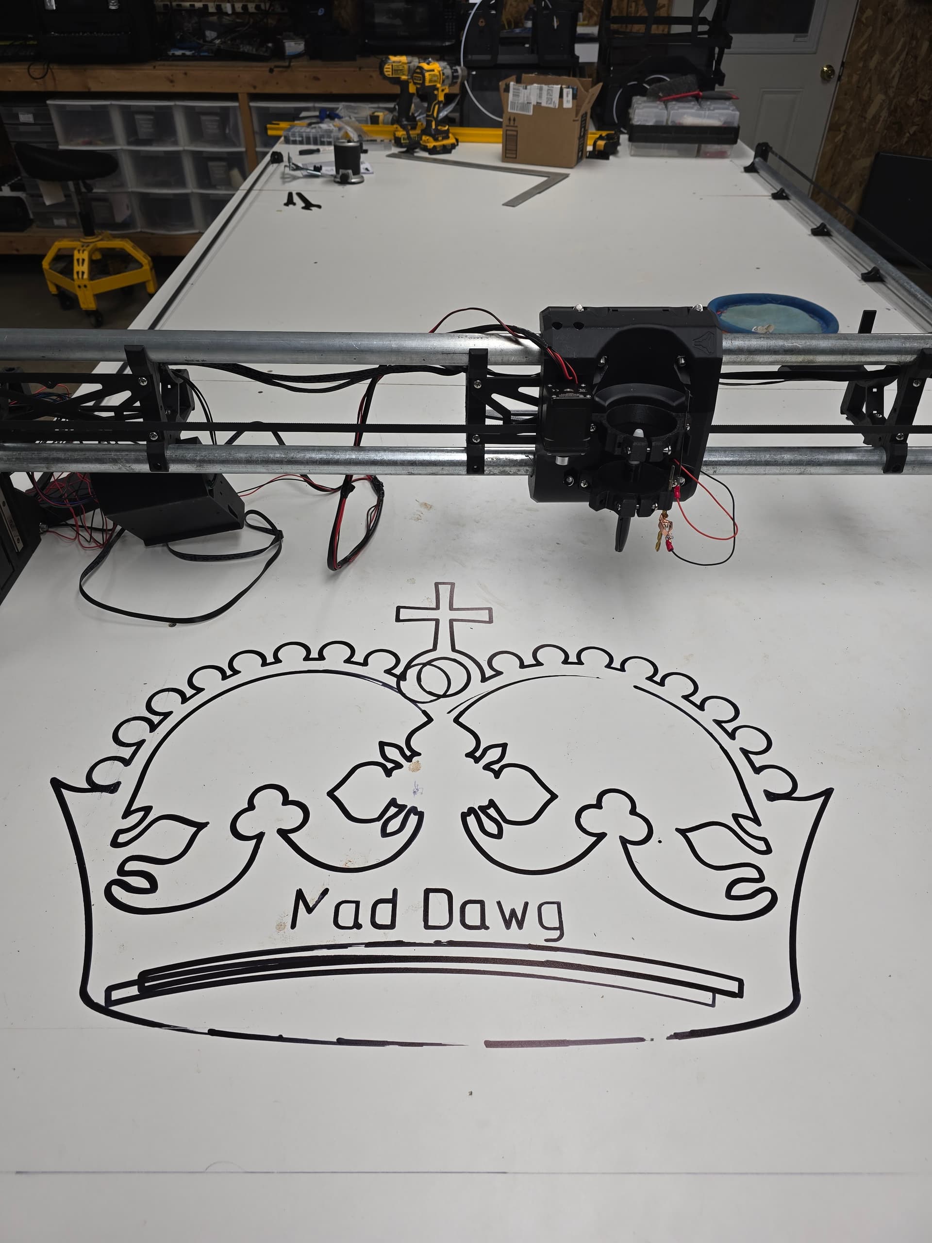

I don’t have any bits or even the makita 701 yet its all ordered just haven’t arrived. I was going use a marker with the makita mount I 3d printed.
Since there is no Z probe working I guess I am hosed until the router gets here unless there is a way to visually/ manually set it.
You can use a pen. That will get you close. Fine point and barely touch so it doesn’t skew. Once you get your router and some bits you can run it again to get it even closer if you want.
Makita arrived just as I was leaving for the day
Its Alive.
Had a few bumps but had some success. Thank You to All
Waiting for bits to give it a test run
Awesome big crown! Great to see it running! Now you can get ready to cut your struts!
Thanks Jonathan gotta get a spoiler board going the marker showed that my table has some humps lol. Then the strut plates and followed by a table. I truely appreciate your and others assistance
Anytime! Keep posting and showing us what you make with it. And as always ask any questions you have along the way!
Congrats on the crown! You will be able to make much progress now in getting last few things done to get active on making!
