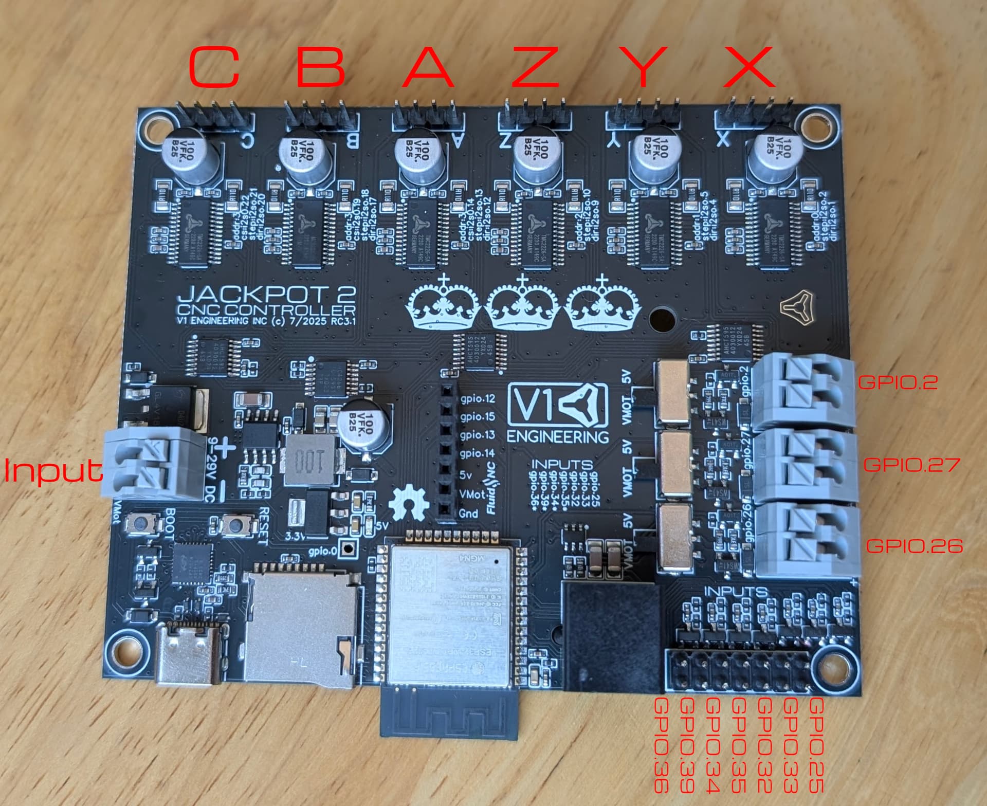

I’m stuck on Limit Switch connections to a jackpot3.
Does any one have a pin out or wiring diag. for the the jackpot3
I cant seem to locate one, I would also like to know what the other connectors could be used for.
Thanks in Advance…im getting close :slight_smile:
Have you looked here?
Admittedly, Ryan should have labeled with the same CBAZYX on the endstops instead of the GPIO numbers to make it easier. It should be the same as the jackpot 1. Same right to left, then skip one and then probe.
X - GPIO25
Y - GPIO33
Z - GPIO32
Y1 - GPIO35
Z1 - GPIO34
PROBE - GPIO36
Just to be sure I did verify this with the JP3 config and it is correct
Thank You much that was the key piece I was missing
I saw the image but I had no axis for reference to match the gpio # :+1:

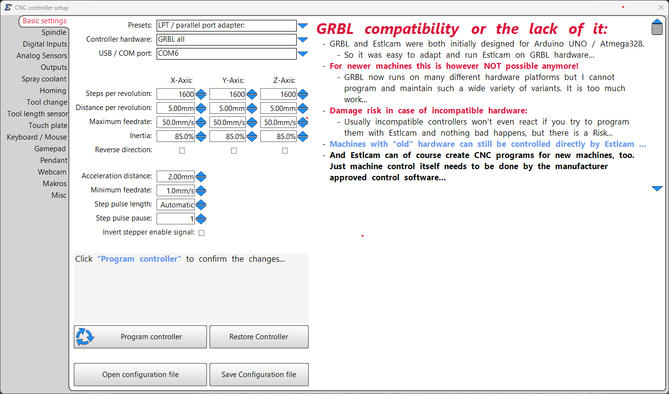

FluidNC settings are as per the below instructions (Note: My WebGUI on my new jackport3 does not show a controls icon upper left like this document image does) but everything else appears to be the same . My JP3 came with WebUi v 3.0.0.6 does it need updating if so. How?
Estlcam is installed and configured as per the instructions here

  1. When I try to run the crown file it wants me to input controller info. (screen shot attached Not sure what all to put here) I am connecting wirelessly to the JP3 from my Desktop PC which is also connected to the internet via ethernet.
