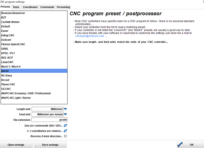

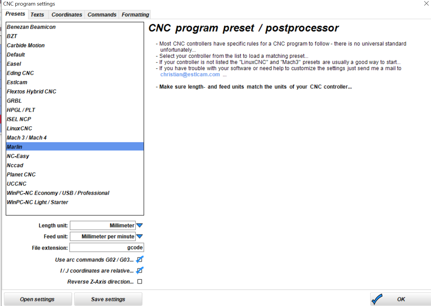

Not sure on the board drivers.[attachment file=85706]

At a minimum, your rapid rates are too high - they are all F3000 and the z-axis really shouldn’t be higher than F480. Something in you Estlcam process isn’t working right because the gcode does not match settings you showed in one of your earlier posts. Did you inadvertently select the wrong tool when you saved the CNC program?
In that file the rapids are correct it is the feedrates and plunges are set too high. Some of those moves are not making sense, x is moving 400mm and Z is moving 40? I don’t have an endmill longer than a usable 15.

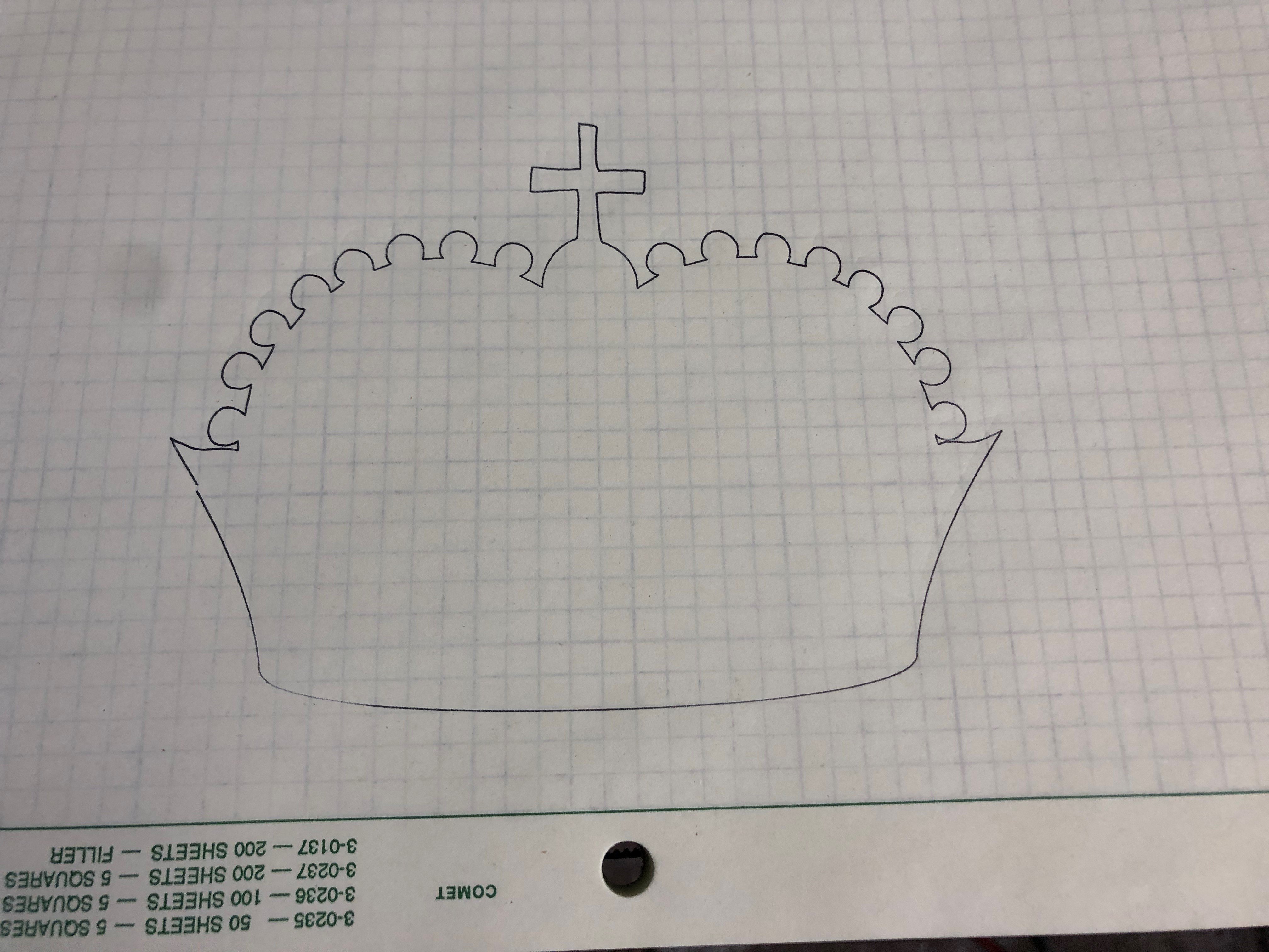

Can you verify my Crown gcode works as expected on your machine. There is nothing about your gcode that would not work, so now we are back to hardware/firmware.
I can. I am sure it will, all the other 2d stuff I have done worked fine.
Ok here is the crown. I only did the outer tool path. There was some wobble of the pen, I only had painters tape to secure it, so the tip wandered a little. Everything looks fine to me.[attachment file=85749]

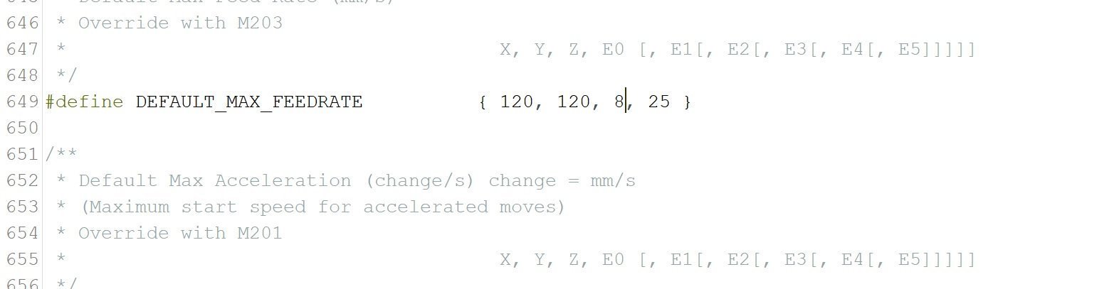

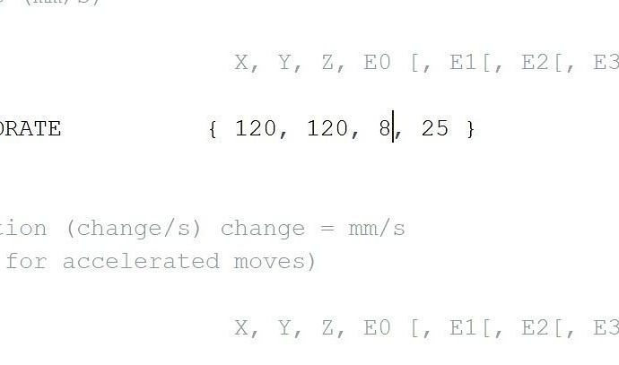

OK I think I got it to work as expected. I changed the max Z feedrate in FW to 8, and it ran perfect. Thanks Jeff for the suggestion. I think for anyone with a LR2, this would be a good thing to consider changing if you have issues with the Z axis skipping during rapid movements. [attachment file=85753]

Haha. I think this is a fine fix for me, for now at least. I like the idea of the firmware being limited for at least my build of the low rider. Ryan, I am willing to help out in any way I can, just let me know what you would like me to test. All of this is for a set for my sons play at school. I am making the pillars shown below. I am treating the foam like crown molding, and cutting a miter into the back side. In fact, I need to get over to the school now, set build is going on without me. I will post pictures of the final product if anyone is interested. Thanks everyone for your suggestions, we eventually got it to where it needed to be for the immediate fix.[attachment file=85760]

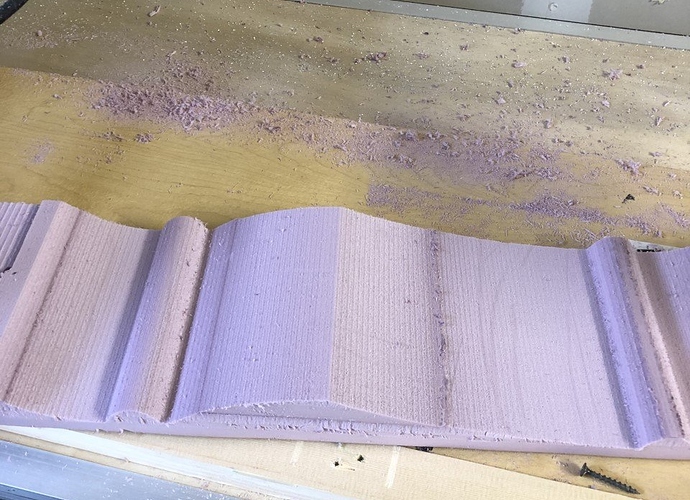

SO…after all that, here is the first cut. I had a couple issues with this first piece, and had to do a recut. I am fairly happy with the result considering this is the first time I have done any 3D milling, and also the first time using foam.
SO this was done using F2500 70% step over on the rough cut, and F3000 25% step over on the finish pass. I did notice there was a little jerkiness at the start of each new pass, but I set up the cut area outside the size of the work so it was fine when it actually made contact with the foam. I tried a couple spindle speeds, and I found on the Dewalt 611 the lowest setting was best. At the higher setting I had some minor melting.
For cutting the actual pieces, I will prob drop down to F2000 and F2500, it seems fine in the foam. The only real issue I had was the bit I got was a little long (6 inches), and a 4 inch would have been better to reduce tip walkout.
