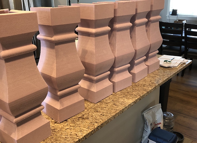

Final update:
For anyone reading this far into the thread, I completed 24 of these, so I feel like the settings are valid. I want to restate, these settings were selected for cutting HD foam as the final medium, not just for testing.
First I changed the max default feed rate for the Z axis to 12 from 30, and the default acceleration to 300 from 400 in the firmware. This prevented the Z axis from moving too quickly and skipping steps. The default acceleration seemed to keep it from being jerky with the high feed rates.
I used a 1/4 inch ball nose end mill, 6 inch total length (It was good being able to get the vac nozzle under the gantry to remove the chips). I found that the lowest speed setting on the dewalt 611 was the best for foam. I made a Z DOC at 39mm so it could clear the most material in a single cut. I set the rough clearing at F2500, and the finish pass at F3000. Once I saw that those speeds were ok during milling, I used the fedd rate slider in repetier to push the roughing to 125%, and once the rough cut was done, I pushed it up to 150%, and even 175% at one point. I know this is much faster than most people like to move the machine, but in foam it was great. The only issue I had was the vacuum can filling up with so much foam debris. (small shop vac) It was smooth movement and a clean finish.
Any pictures of your mountain of foam parts?
I didn’t grab any of the pile, but I did take some cool vids if anyone is wanting to see the cutting in action. Pretty sure the files will be too big to upload directly, so I can post to YouTube or something else if anyone has a better option. I will also throw up some photos when the set is complete showing how I used them.
[attachment file=88770]

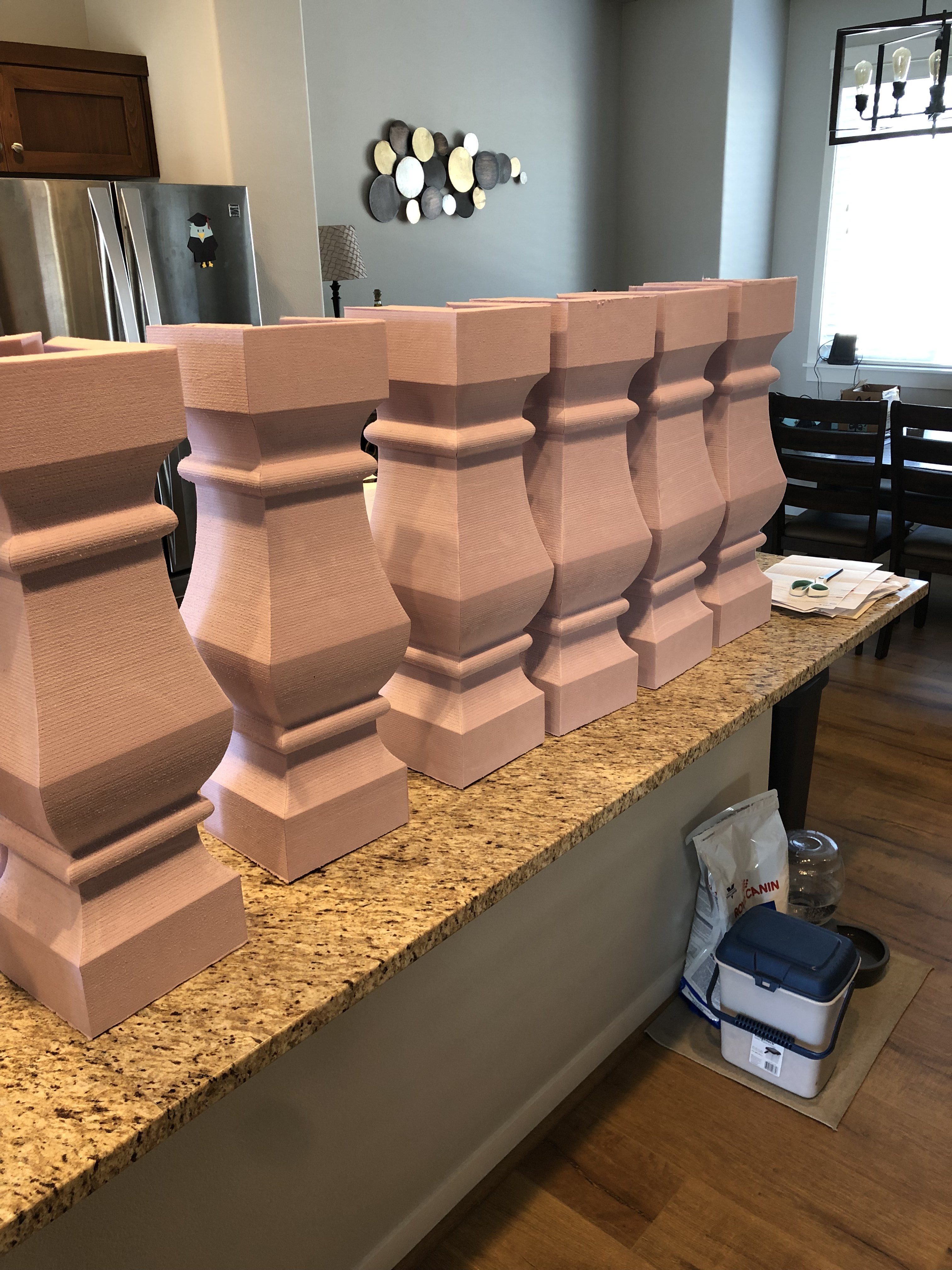

Ok here is the finished product. Turned out really good I think. Thanks again for the help.
Dude! That turned out nice!
That looks great. Good job on the miters too. Thanks for sharing.
Those came out amazing! That gives me some ideas for sure.
Jeffeb3 I made a hot wire like you suggested. It worked amazingly well for the miters. Once I had the correct temp dialed in, they went through very nice and smooth. Once they go up onto the set and get painted, I will post another pic.
We had a heated wire in the shop class I took in middle school It cut through foam really well, and it left a good finish. Glad it worked for you.

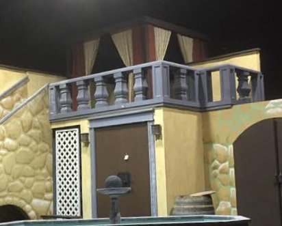

[attachment file=89702]
So this is how they ended up. I am happy with the result.
Me too!
