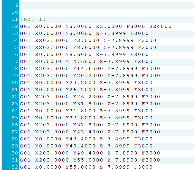

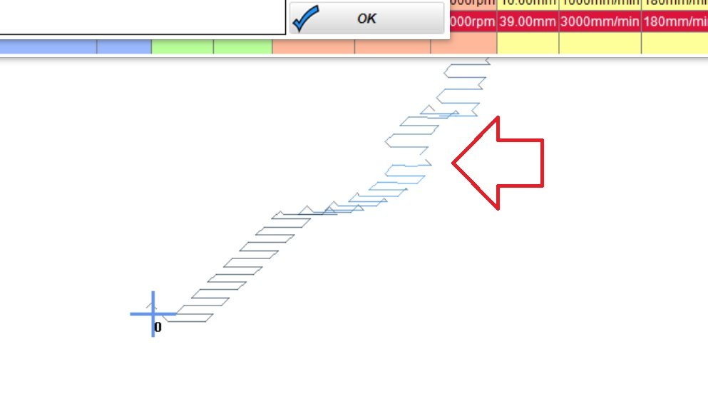

So I am trying my first 3D cut, and I have an issue with the feed rate being too high on the Z. Instead of using the F(z) plunge rate, it is using the F(xy) rate. I am doing a contoured cut, but it is flat along the x axis, and I am cutting foam, so I would like to use high F(xy) rates. Other than manually changing all the z moves to a lower rate, how can you prevent the xy feed rate from being applied to the z rate when estlcam generates the gcode? The picture is the profile of the cut.
A contour cut is limited by the slowest axis. That doesn’t look like that contour would be effected by the Z axis speeds at all. Link to your gcode?
I have the xy speeds high enough that it causes the Z to skip when going up, and sometimes down. If I have to travel at Z limit it will take hours to complete the cut. Here is a screen shot of the code.
That first code snip was when I was trying different repeat values after reading some other posts with similar issues. You can see on the second line it is using the high xy feed for the z. Then later on once it gets into the contoured parts, the z is still getting the higher rate.
So ultimately what I want it to do is: start at zero and cut the full width along x fast, then move forward on y with high step over, and cut back to the other side of X fast. Drop what ever z it needs to, and then back across x, and so forth. It really shouldn’t need to combine the Z into the xy movements, but it is. If I have to do all of the movements at 480 that will suck. The foam piece is 8 inches wide, 24 inches long, and at the deepest cut about 1.5 inches deep. I have to make a bunch of these, and even with the super fast xy it still takes 33 minutes for one. I guess I can edit the gcode and rewrite the z on a separate line with it own slower feed, but that is 1300 lines of code to mess with.

If you orient the path 90 degrees there will much less Z movements.
I’m not certain what you mean Ryan? Like the z plunge angle?

Here is the start of the toolpath. It usually skips at the first big jump up.

I guess I don’t understand how this would be different than just changing the F(xy) to 480? It sounds like the xyz movements can’t be individually set for each axis. I need it to go fast in the x (3000) and slow in the z (8). It seems like if I set the max in marlin, then the gcode should do any speed up to and including the limit for each axis. In marlin it has individual limits, but I guess that just limits a movement speed along only that specific axis when it does not have a xyz command? If there is a multi axis movement, it can only go as fast as the slowest component ? Yuk. I may have to just separate out the lines manually.
So is it possible to have multiple feed rates on a single line? Or do I have to bump the z to a new line?
X300.0000 F3000 Z-5.0000 F480
Not directly. typically it is always a compound move simultaneously, so a 10mm move in X and a 1mm move in Z happen at the same time, so Z would actually limit you here. Set the cam as I suggest, adjust the direction of cut to a more suitable angle. I have no idea how to explain this without diagrams. There is a reason you can change the cut direction in the STL menu of ESTLCAM, a 90 degree shift can cut your cut time drastically. If I am not being clear make two test cuts and one should be significantly faster.

Do you mean the parallel to x or parallel to y milling strategy? Or is it buried in a menu?

Yes. Make it parallel to the lest vertical changing side. That way instead of continuously changing the Z, it only actually moves up at the end, that way XY feedrate will be the only limiting factor.
