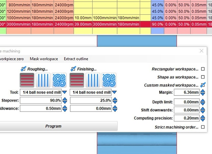

So I have it set to parallel to X. If it is parallel to y, it would constantly be changing z, and it takes much longer like you mentioned. It does make the z movements at the end of the row, they are just too fast for the machine to handle and it skips. Each x pass should not really need a z movement during the pass, it’s fine for it make the entire z movement before starting the x pass. That’s why I mentioned just making the x pass, move the step over amount in y and make another pass in the opposite x direction. Continue that pattern dropping the z to the desired height at the end of each x pass. I actually need it to operate like a 2d cut, but instead of a single depth, I need it to follow the contour. If the only way to do this is to modify the gcode, that’s what I will do. I can’t run the z at high speed, and I can’t run the x or y at low speed.

and have it move along x at 3000, and z at a speed that doesn’t cause the motors to skip. When I ran it with the F(xy) set to 3000, at the end of each x pass, it skipped. This is very much like linear pocketing, but with a variable depth along the contour, instead of just a final depth.
So hopefully changing the limit in firmware will do the trick. Really that should be set to a number that won’t allow the motors to skip anyway, as I will change the speeds for different bits and materials often, but the machine can only go up so fast and that will not change.

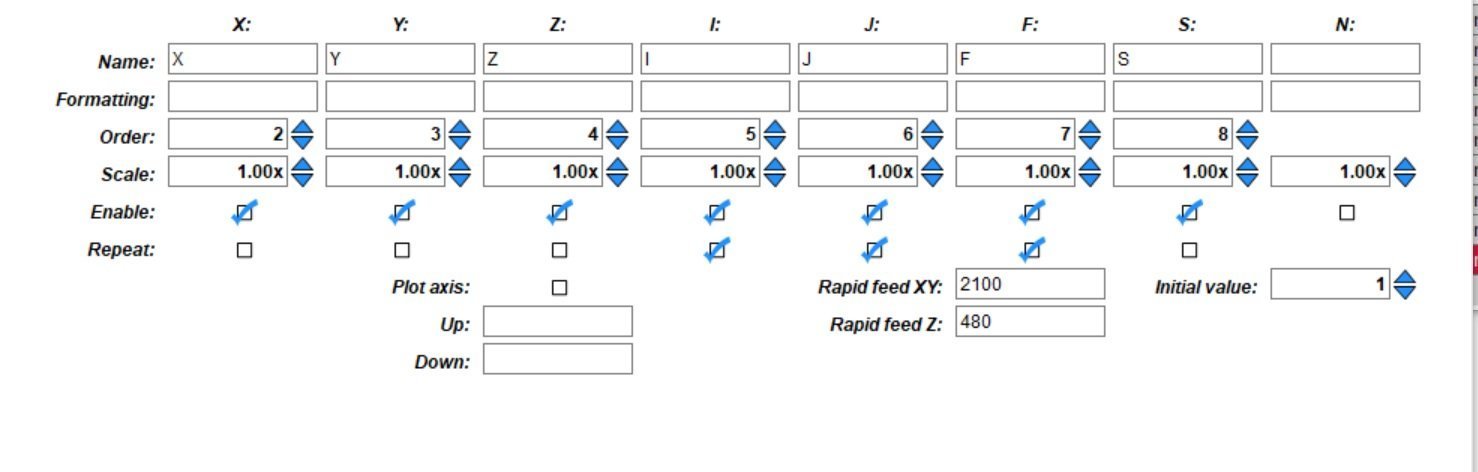

Rambo 1.4, not sure on step rate, lead screws from you, rapids are 2100 and 480 like the guide shows, and plunge rate in Estlcam was 180, at 39 mm depth. Again, foam is the material I am cutting, not just testing with.

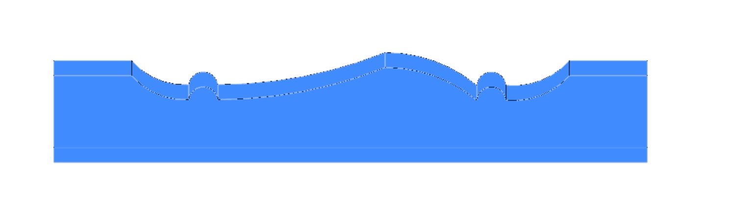

This is what I am making. It really shouldnt need to change z while moving in either x or y. Just change z before moving on the next x pass.

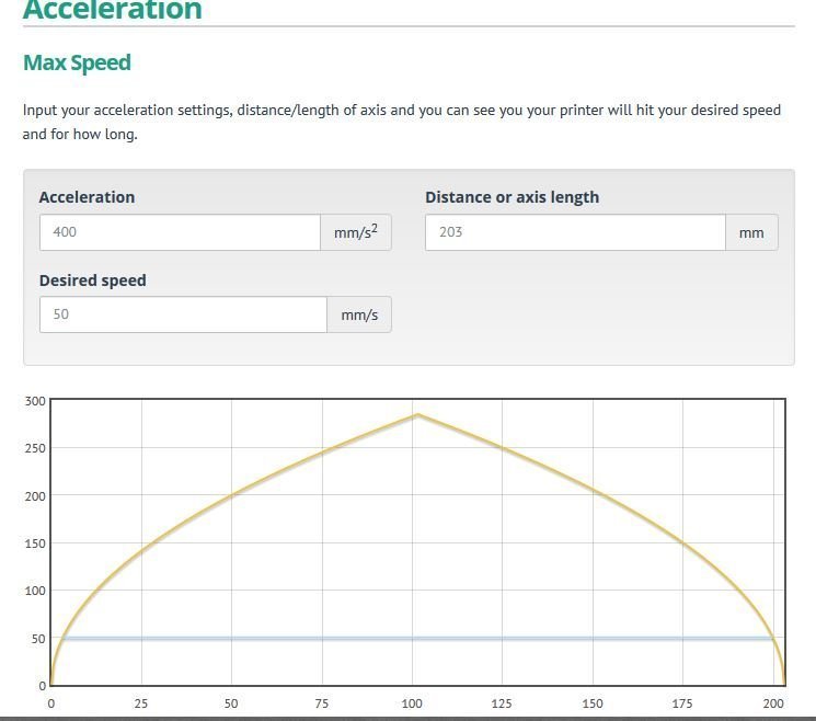

f3000=50mm/s Way too fast.
Why don’t you post a screenshot of your settings screen for this cut as that is not the right information.

Ryan - The gcode has F3000, but there is no way its traveling 50mm/s. The piece is 203mm in the x direction, and it takes about 22 seconds to cross that, so only about 9mm/s. Probably the z limit slowing it down as you said. I just kept bumping F(xy) trying to get the time down. Foam shouldnt put up that much of a fight.

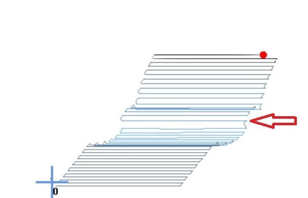

Really the issue here is that it is doing the entire Z movement at the end of the row is really fast, and when it gets to the part of the contour where it starts going back up, it loses Z on one side. I just want to limit Z going up, without limiting X and Y.

When I watch the preview, I am pretty sure I can see where it skips. It made a big jump when I was testing it yesterday. It does not appear to make any Z movement along the X pass, if it did, it wouldnt be a flat pass, it would slope along X. Ryan you keep saying it doesnt work that way, but why couldnt it for this specific case? Following the formula: cut along X, move forward Y, drop Z (if needed), cut along X the other direction, move forward Y, drop Z (or up for that matter), cut X, etc… I think this should work. That is basically what it is doing anyway, its just too fast for the Z. (and likely XY too since its probably not moving at F3000 anyway). If I split the Z movements from the X, and drop it to a new line, I can change the F rate to something Z can handle. It would be tedious, but I dont see why it wouldnt work.
Your gcode and pictures of your settings?
I think all of us are talking about different things.
The gcode will have to wait a bit, till I get home. The settings are two posts back.
What material is this in?
Your version of this page?
Cutting the pink XPS foam board. I don’t have my laptop with me, but that page looks just like mine.
