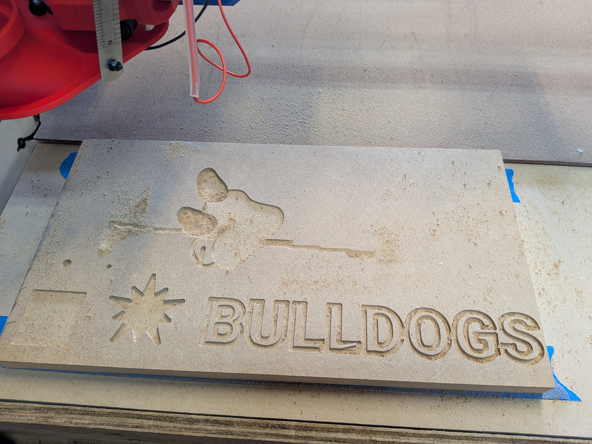

I recently completed the assembly of my LR4 running of a Jackpot 3 (3.9.9). I still have temp struts and need to clean up some wiring but I had it cutting. Yea!
The cuts at the bottom of the board went just fine. Then I sent a few more cuts and started running into issues. I drilled two holes (technically one was drilled and the other was a bore operation.

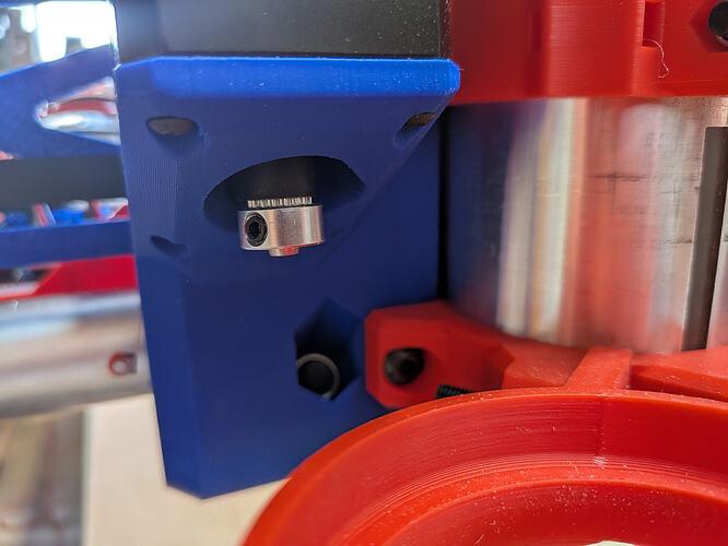

When it runs, for the short time it does, I can see the motor belt pulley moving. I thought the pulley might have gotten loose on the shaft of the motor but I don’t think that is happening and I checked that the set screws are tight.
The pulley is slightly misaligned with the belt but, because I can’t see the top of the pulley, I am not certain the belt isn’t still making contact with the teeth. The pulley definitely spins along the length of the belt when moved by hand.

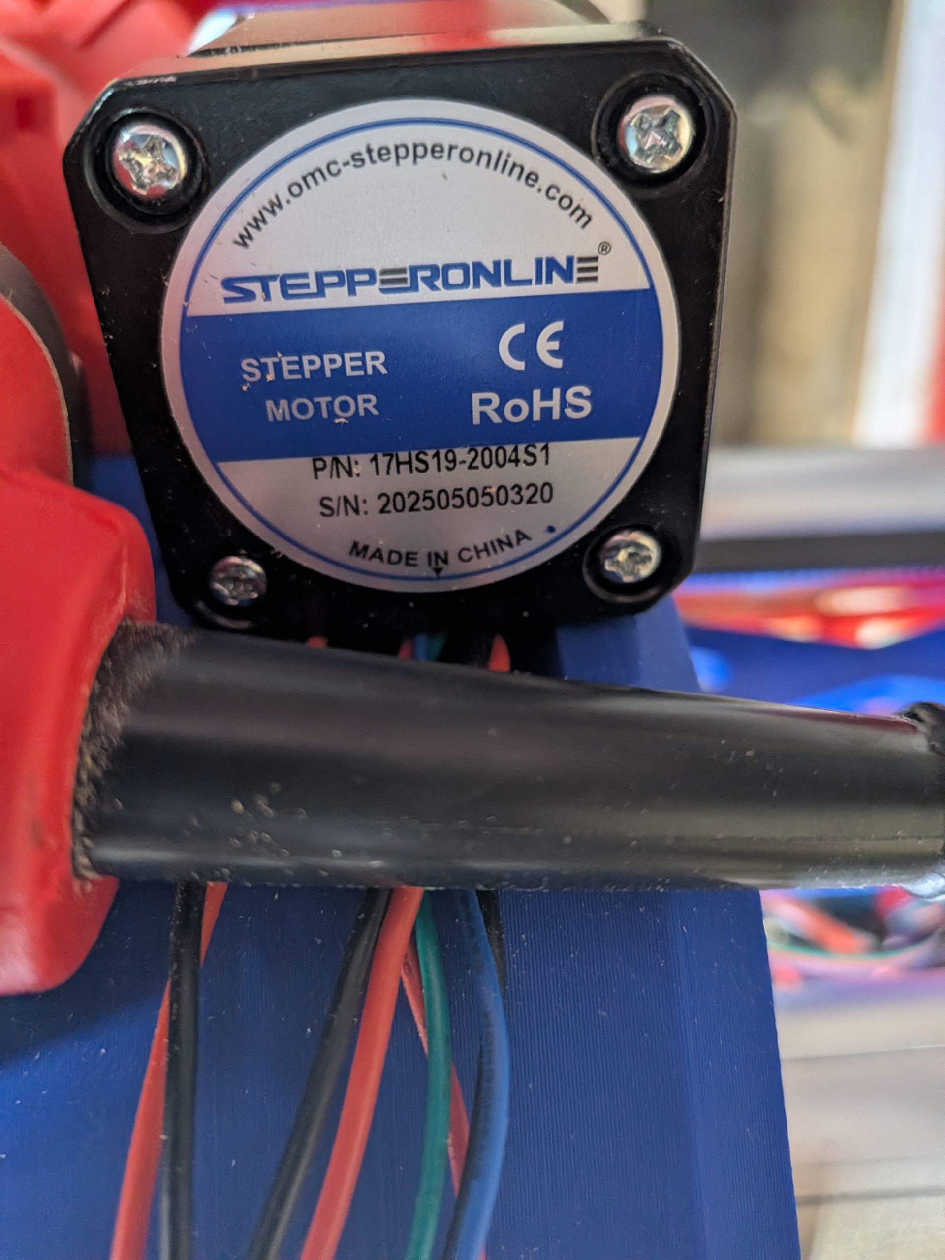

Here is my stepper motor -

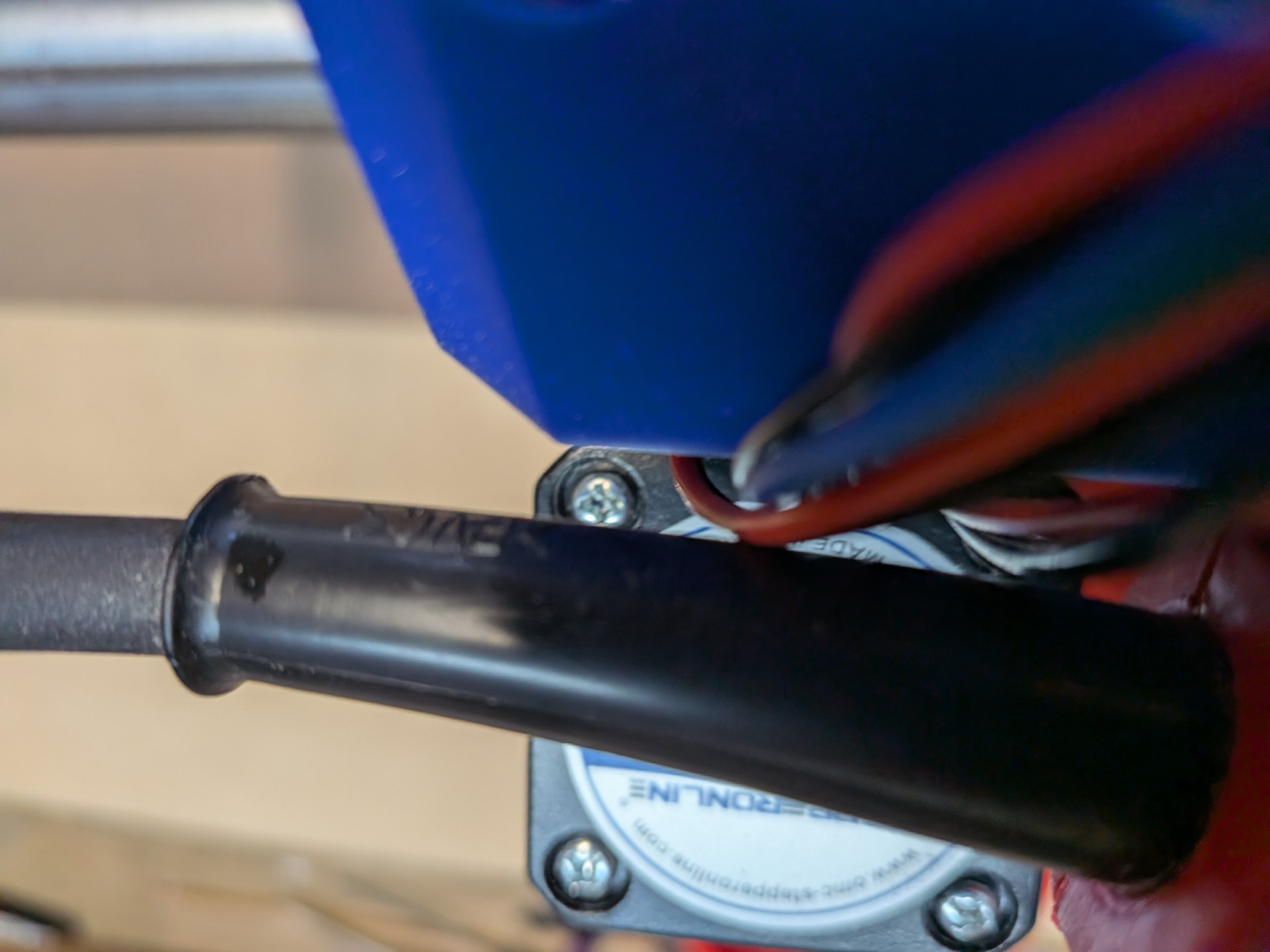

Can you get a picture of the connector where the cable plugs into that motor?
Not a good one.
