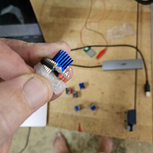

Do you think it has anything to do with bending the pin on the bottom ( like it said to do in the old instructions on the lr3 page)?

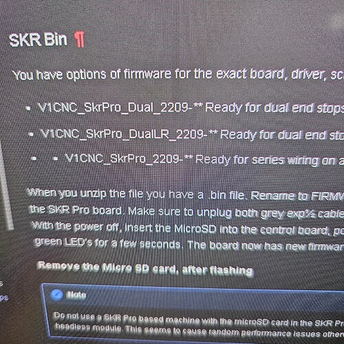

The SD card is used when flashing firmware, but the firmware “Lives” embedded on the board. Otherwise, SD cards are used to supply files for your jobs.
V1 SKR boards will have been pre-flashed with appropriate firmware. You pick at purchase time whether it is for a lowrider or a repeat printer.

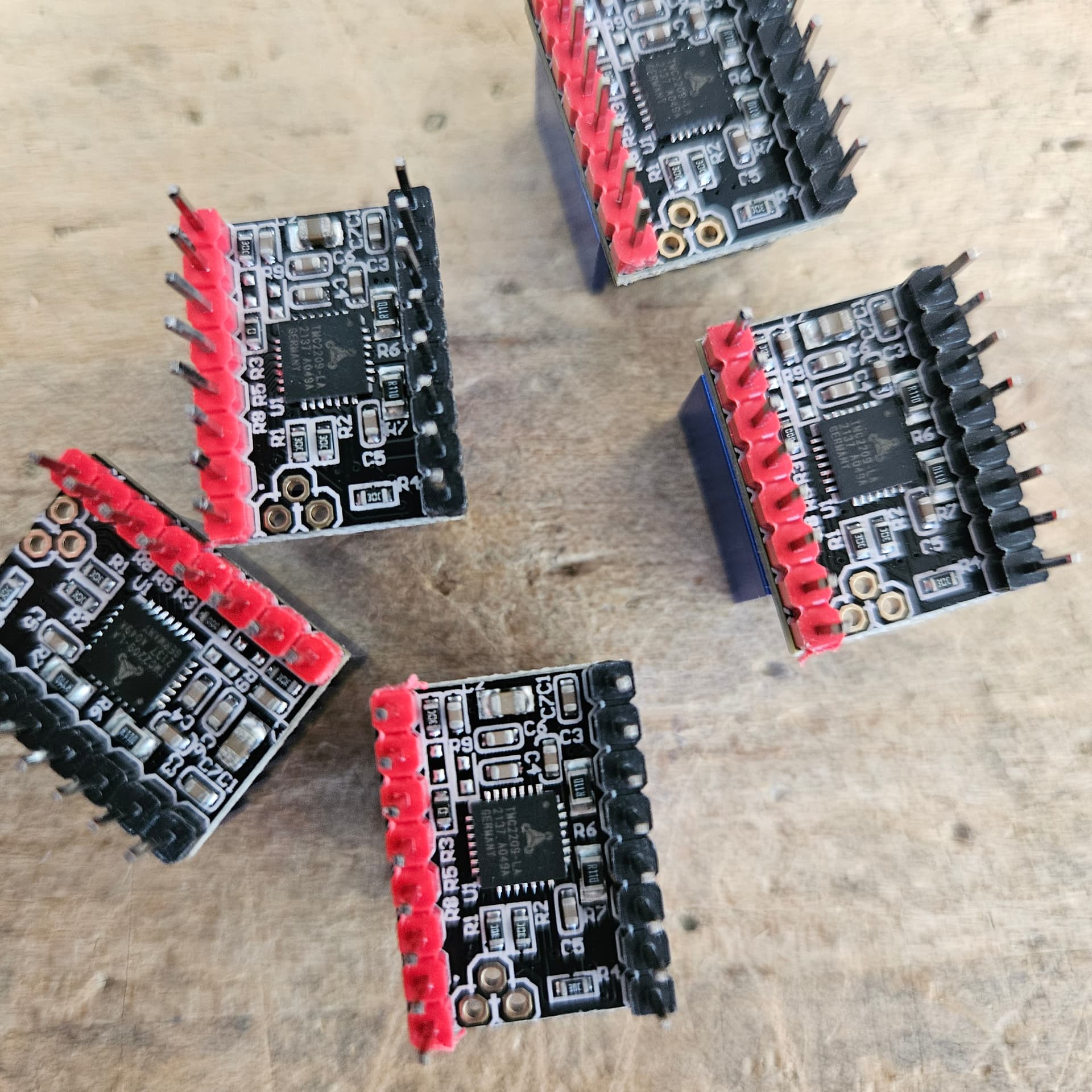

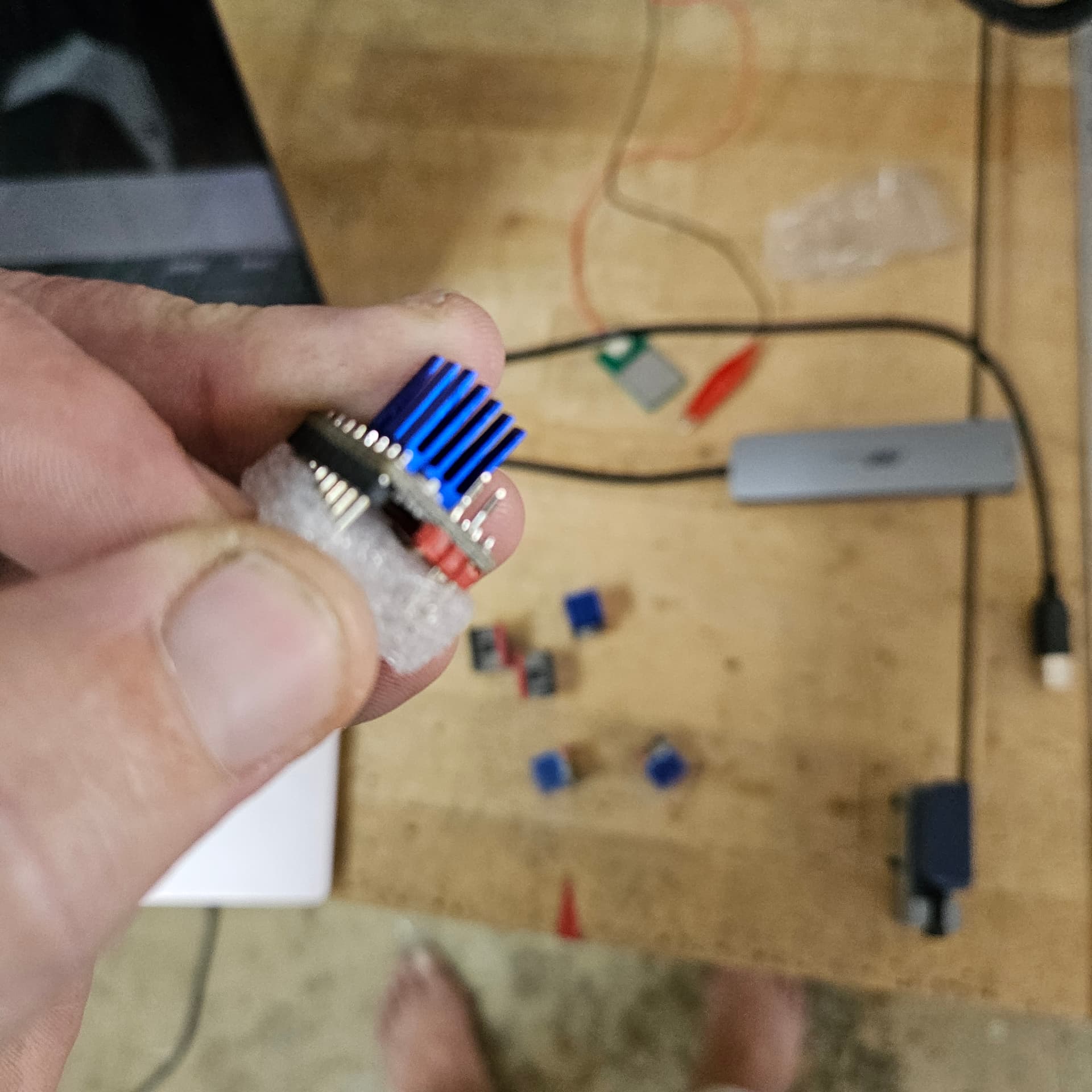

If you bent it in such a way that it can short to something- maybe. I trim the pin off on mine. Give us pictures of the stepper drivers with the pin bent.

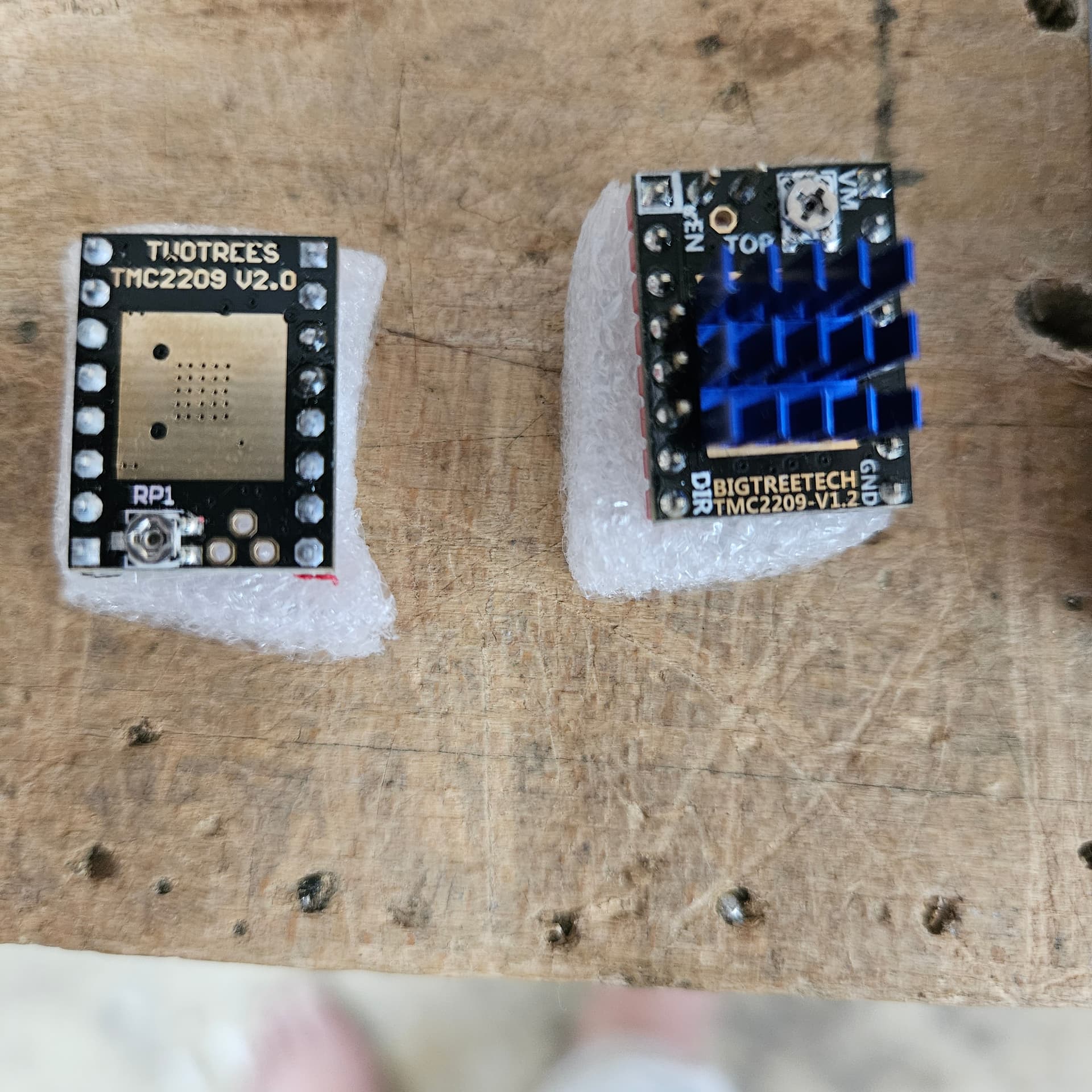

I swear i had different ones where i bent the pins in!??
Found some in the box
So i somehow mixed up and installed the twotrees 2209s and the bent pin btt2209s are in the box somewhere
One step at a time, we’ll get this thing up and running.
ok I found the rest of the BTT TMC2209 v1.2s and reinstalled them.

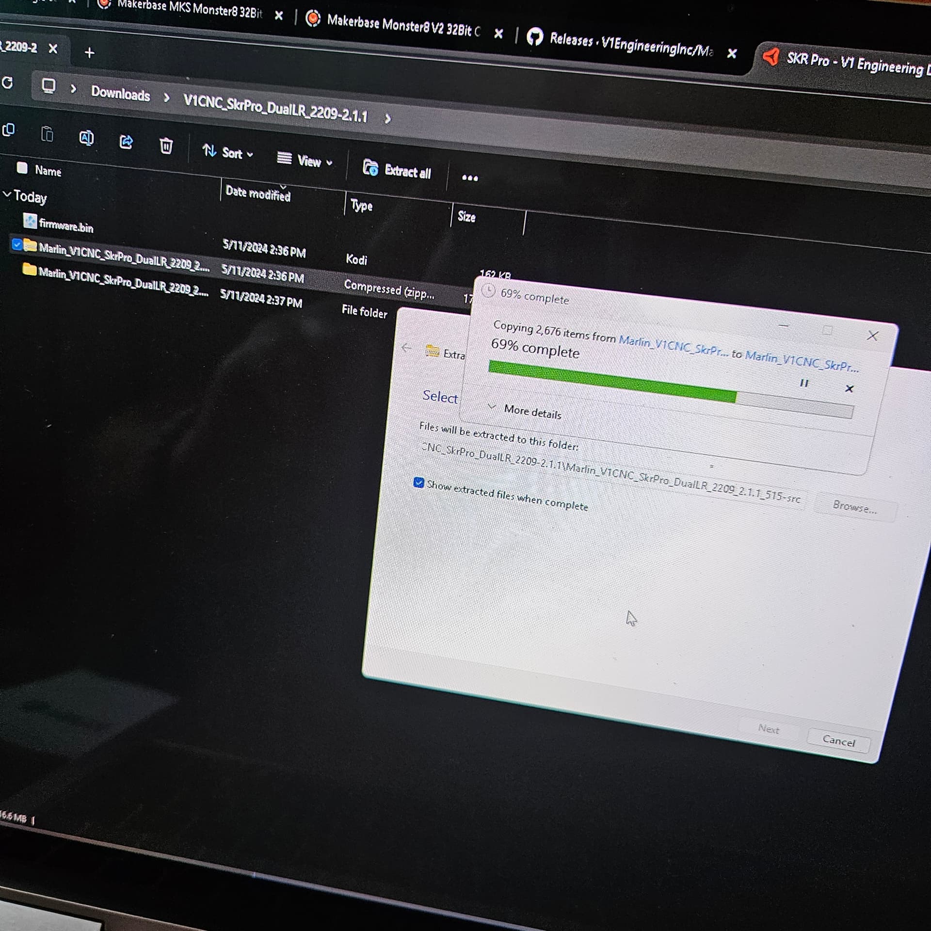

Next Im going to flash a sd card with Ryans software on it…
Then ill try powering up again.Simple
For the SKR, the SD card has to be formatted with FAT32.
Looking forward to seeing you get the flash on it.
When it works, the file will get renamed after the flash. That’ll be a great sign.
Similar for the TFT.

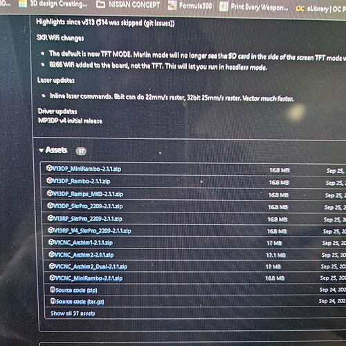

So I went to the v1 link Ryan sent.
I didn’t see the link the instructions say, but I followed the link and at the top of the page it says New Marlin 2.1.1
So am I flashing this?
I mean, do I find the board under the config folder for the skr pro and download that? It wouldn’t be preconfigured then would it?
Even still, should I still flash this?
Which one should i flash?
The instructions say a different file name.
found it…
