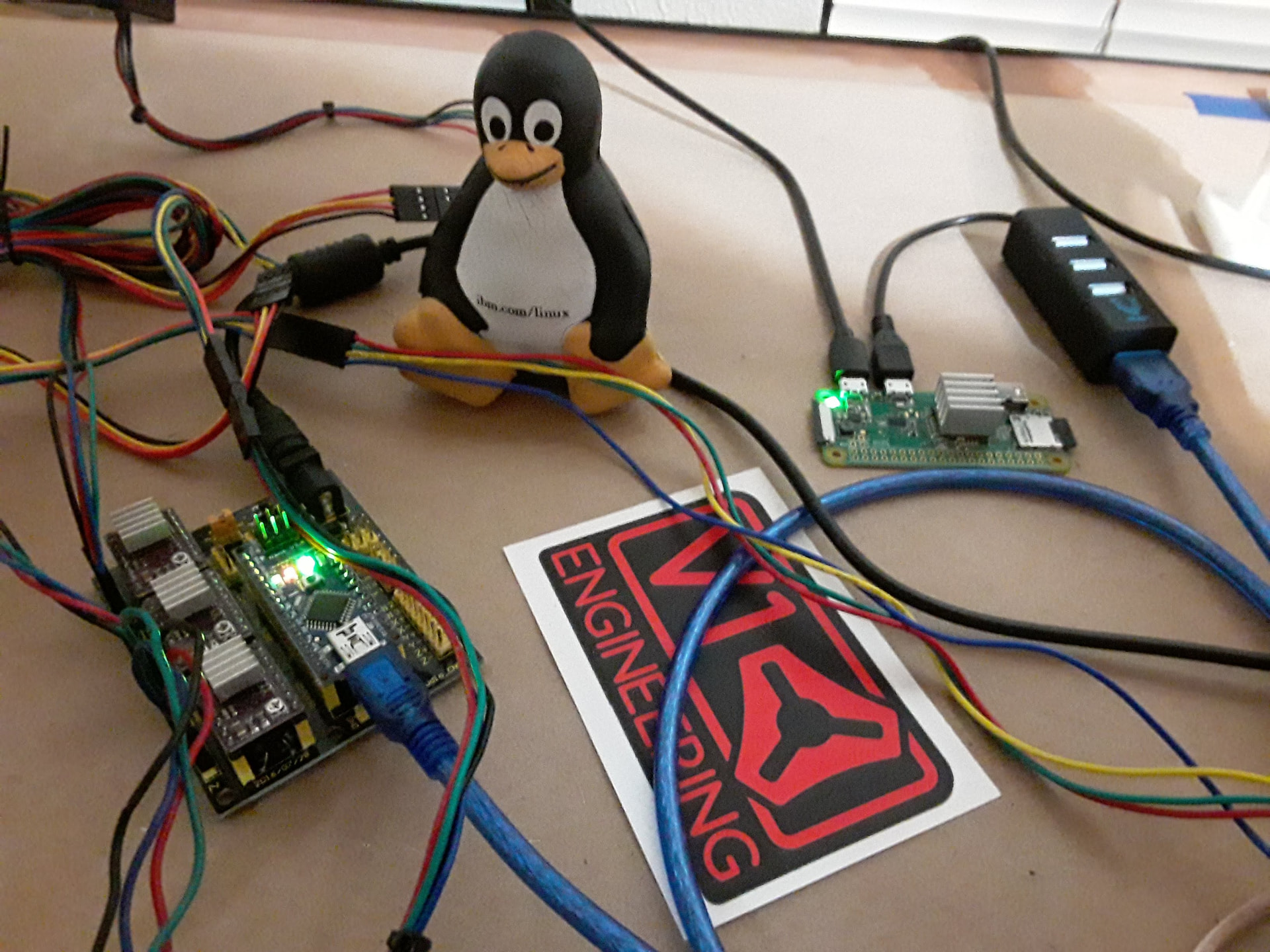

I prefer instead the addition of a headless RPi3/4 with Jeff’s V1Pi image and CNCjs or Octoprint (or, a headless mini-PC with RDP and any gcode sender) and connect it to the Jackpot directly thru USB. This allows any of several ways to send a complete job from your browser or with wireless file transfer to the remote device and sender… and then control the job without need of any further involvement of wifi during the actual job run.

Would a pizero work? I think I have one kicking around somewhere.
I’m familiar with using a pi to offload computing with Klipper, but I dont know if thats the same thing you’re describing.
Good deal. Thank you!
A Pi Zero W will indeed work with Jeff’s V1Pi image. Here, the little Arduino Nano-based CNC controller would be replaced with your Jackpot board.
