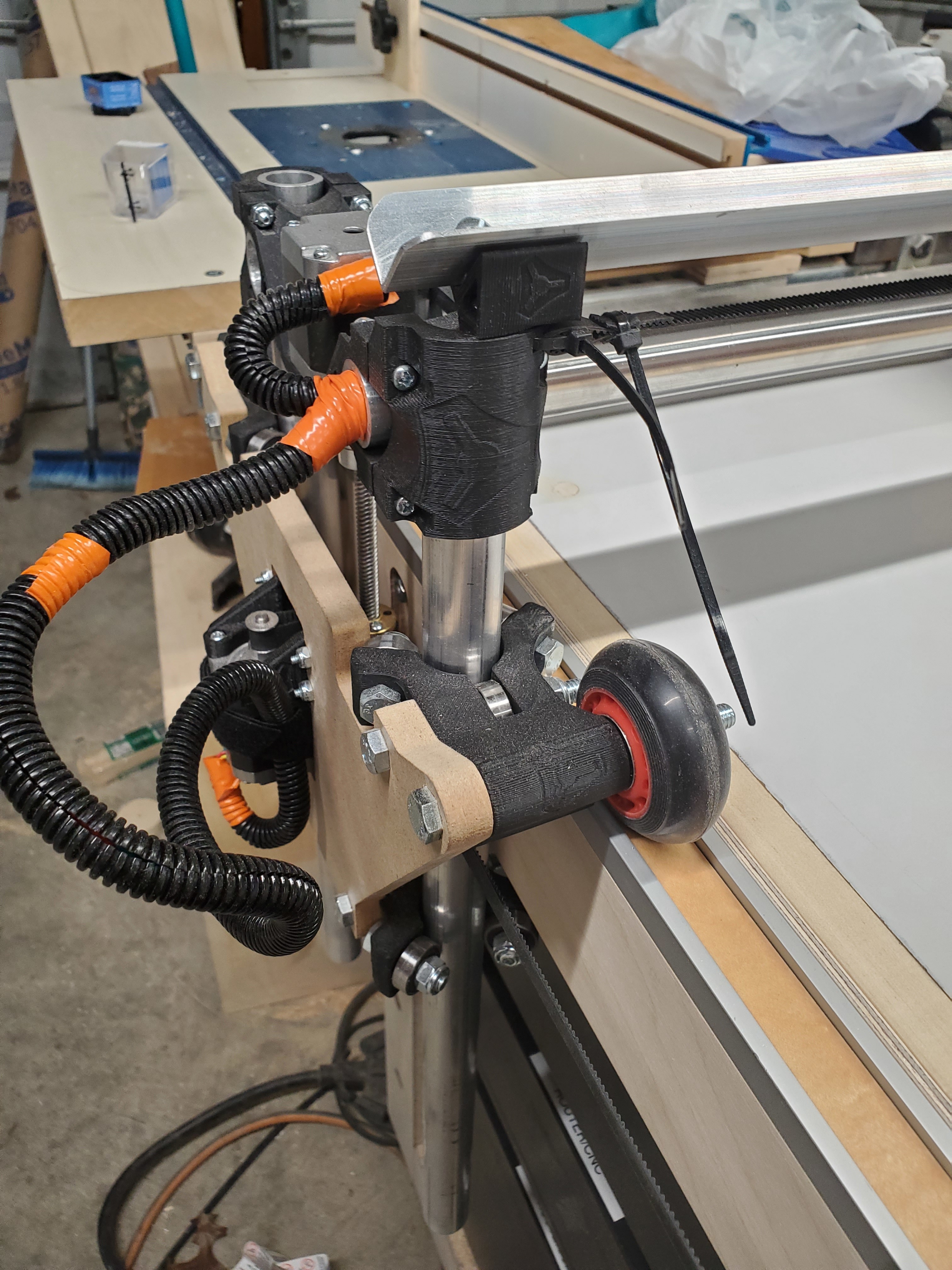

  1. nut access on the X/Z-Tube bolts ( the 4 little bolts that squeeze both the vertical and horizontal tubes is near impossible to gain access unless using needle nose pliers.
  2. belt tensioning - zip ties are not the way forward. note - There’s a great belt tensioner on Thingverse (a Primo / LR2 hybrid) .

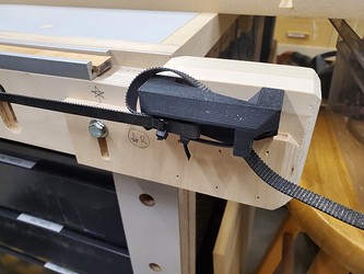

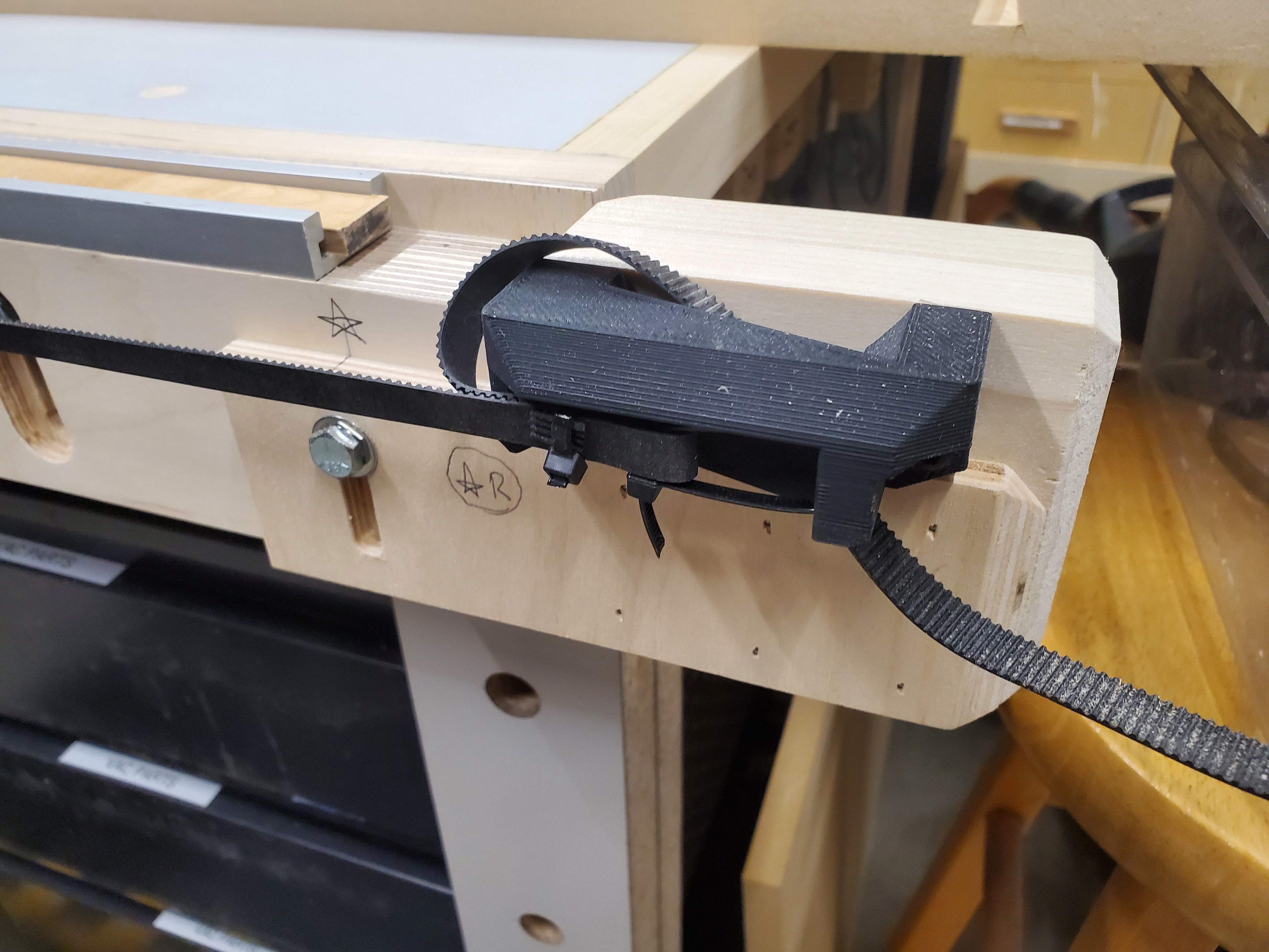

Here’s what I have done to accomplish this. I created a removable block to hold the belt and adjust height of needed (though once it was completed I don’t think height adjustment will be needed) this mounts on the end of rails that also can raise or lower for my multi-purpose bench top where I can mill sheet goods with my circular saw. There’s a miter track on the top of the rails where the wheels of the y axis sit (too deep at first, but I placed a .25 inch strip in there and it’s good) I’ll use that miter for circular saw and router sleds for case work.
