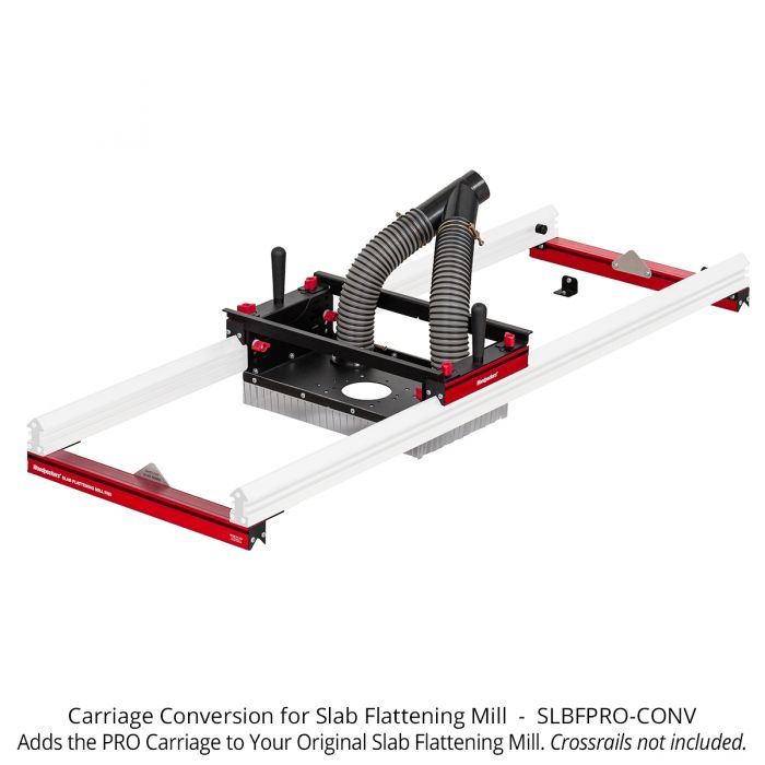

The gantry on this is one idea that looks like it could accommodate a swappable platform. Could see a default open base with different inserts for different tools, including a Router on a Z axis. Looks like it has locking knobs to fix it to the rail when needed which would be great for a panel saw-type operation. Guess they could be level adjusters but some locking concept could be added fairly easily.
In fact, that whole setup could probably be turned into a CNC rig in a number of different ways if you wanted to just pay up front for a certain degree of precision.
