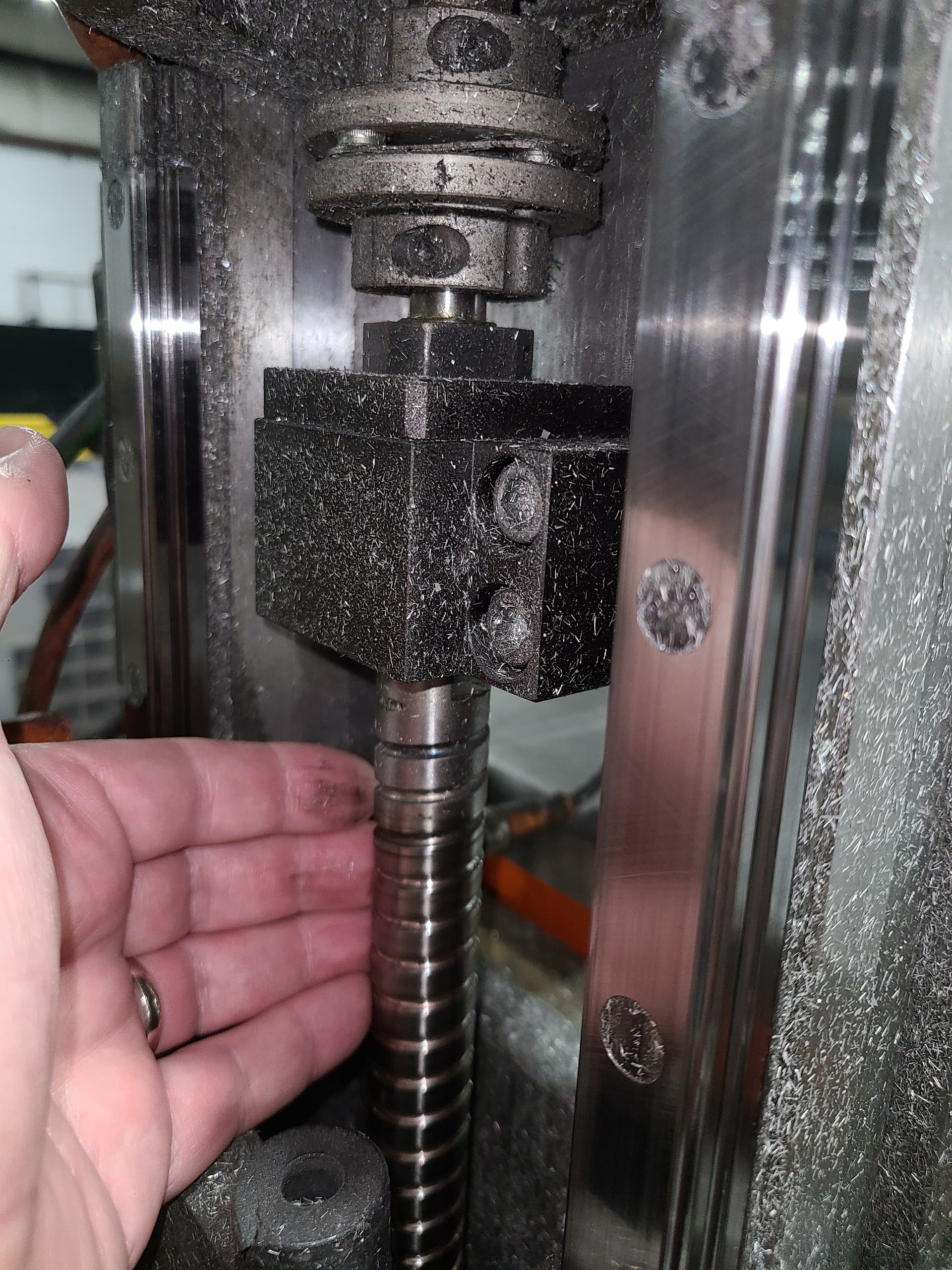

Very glad you didn’t try to go with ball screws. I have another one failing and that’s with routine pm. Despite best efforts, debris still manages to get in the balls and destroy them. The culprit here are aluminum chips.
On the few machines I’ve seen with ball screws, they were inside some sort of protective sleeve, like a bellows.
We have some that are under saw tables with shields around them. You’d be amazed how much crap gets on and in them. Even with preventative maintenance
The linear rails right next to the ball screw is not having any issues? They have recirculating balls in them as well, they just don’t move nearly as much.

The linear rails have wipers on them and we have very few problems with them if any.
