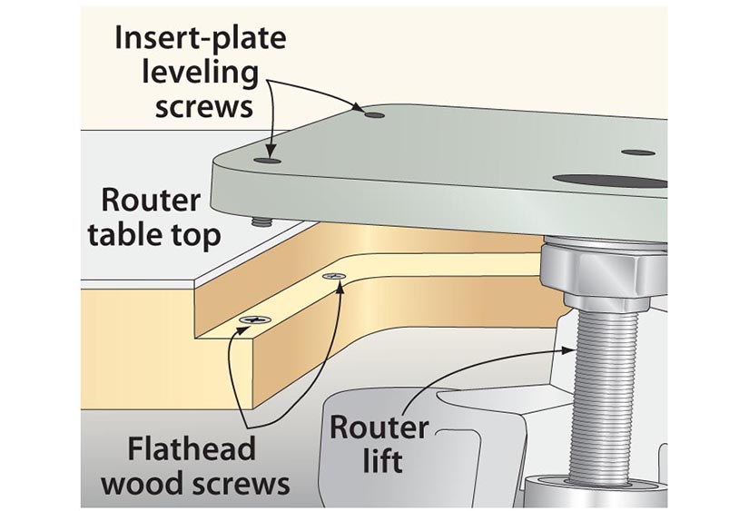

I’m picturing 3 or 4 set screws in the flat plate, like I’ve seen for leveling clearance plates in router tables…
Quick Change Mount for Makita on Thingiverse.
