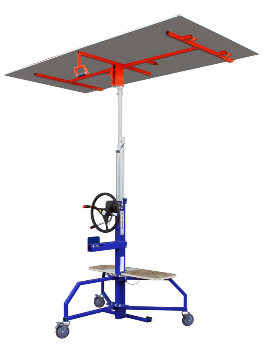

It would definitely need a good vacuum system to hold a 4x8 sheet in place… :grin:
And a whole new challenge to load your stock :joy:
