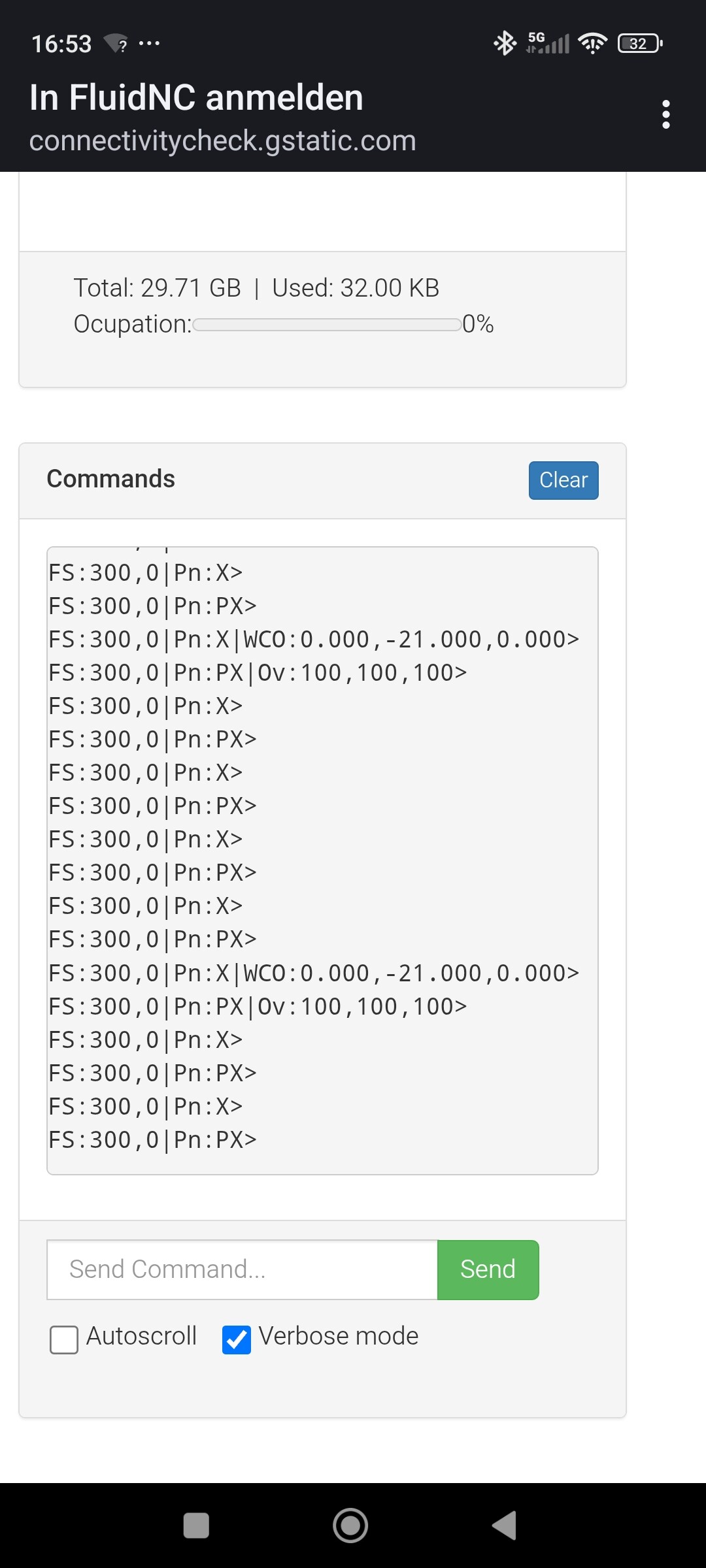

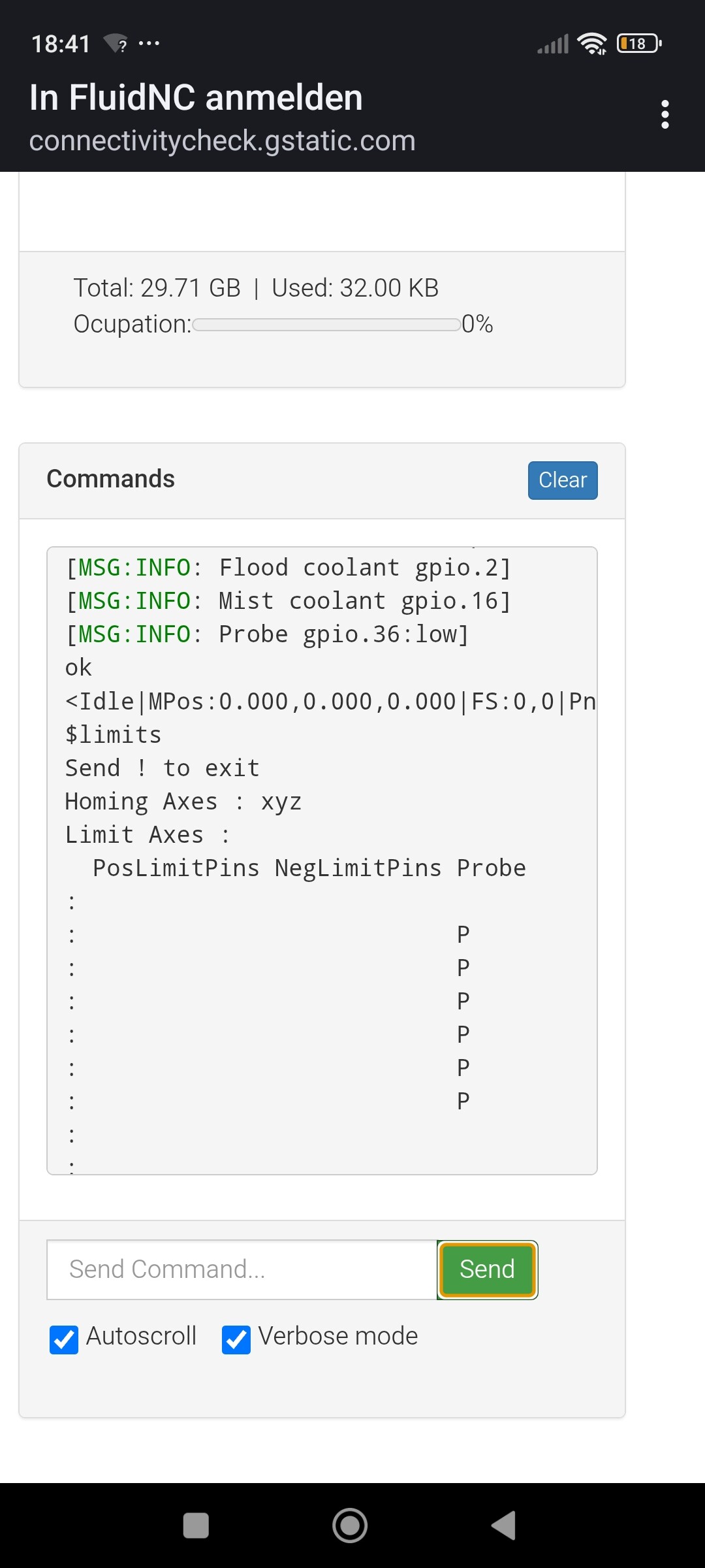

This is what keeps going in the console on and on till i turn the power off.

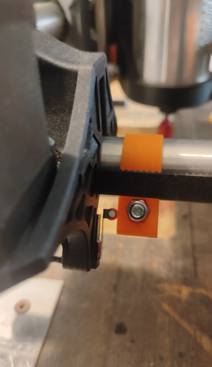

It would be best to Home Y, and take a picture of the levers position relative to the screw.
That screenshot did not help enough. Home the machine in Y so it is close to home, then home again and try to catch exactly what happens in the terminal. You can take several screenshots if needed.

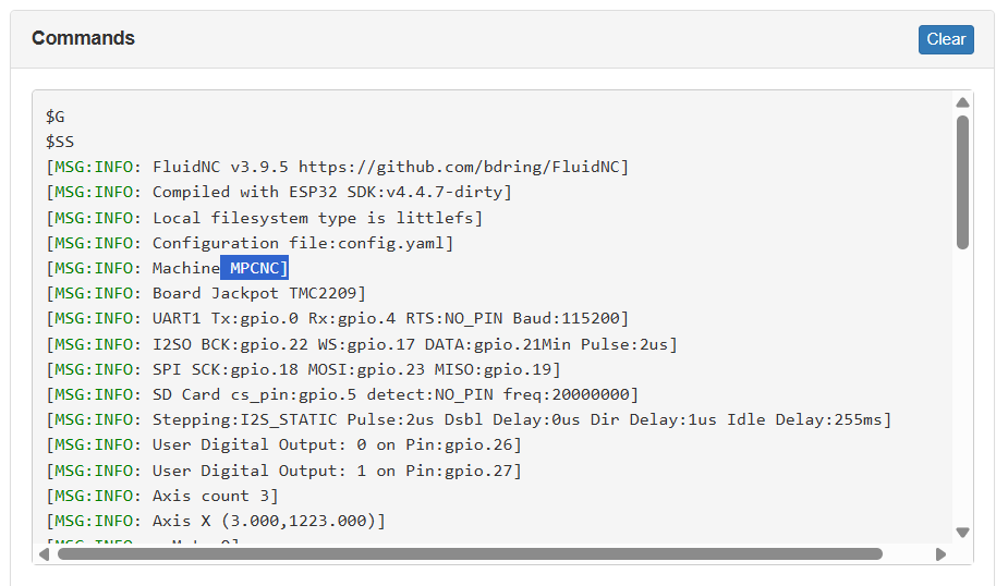

Also make sure if you type $SS into the terminal it says MPCNC near the top not LowRider.

Yeah it says MPCNC

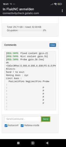

And this is all that happens in the console
The switches are clearly triggered after homing, how can i prevent that?
heres the triggered switch

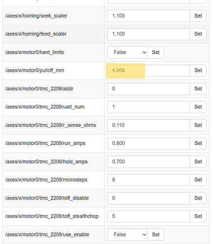

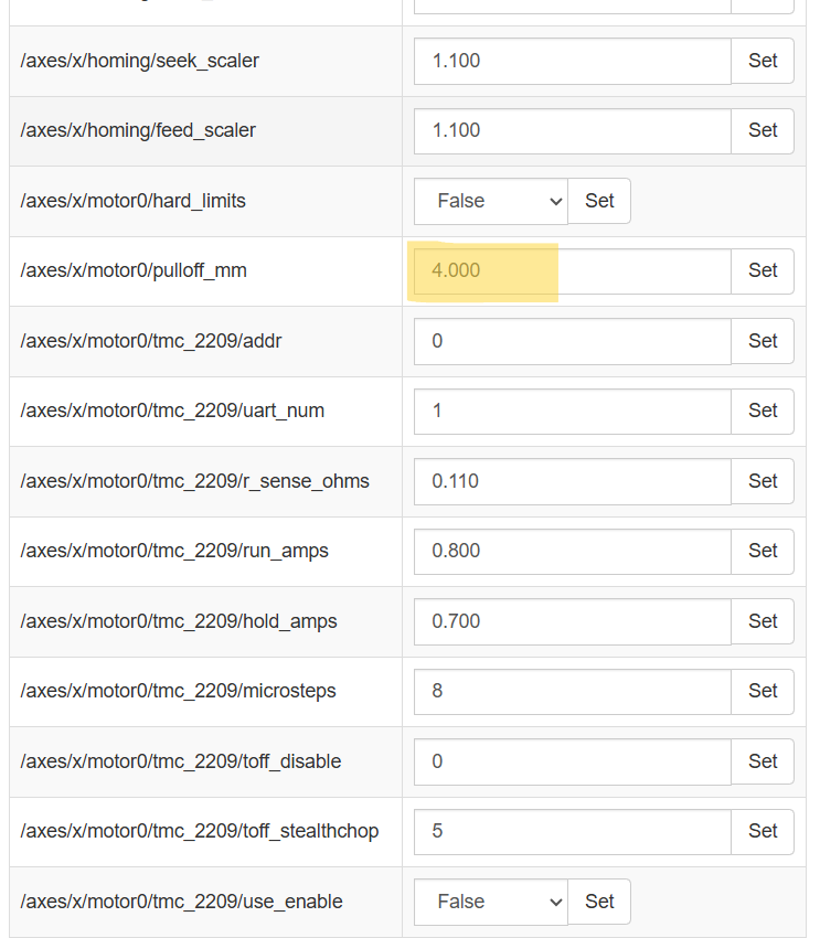

does 4.000 stand for 4mm? because my axis does no pull off so i am wondering.

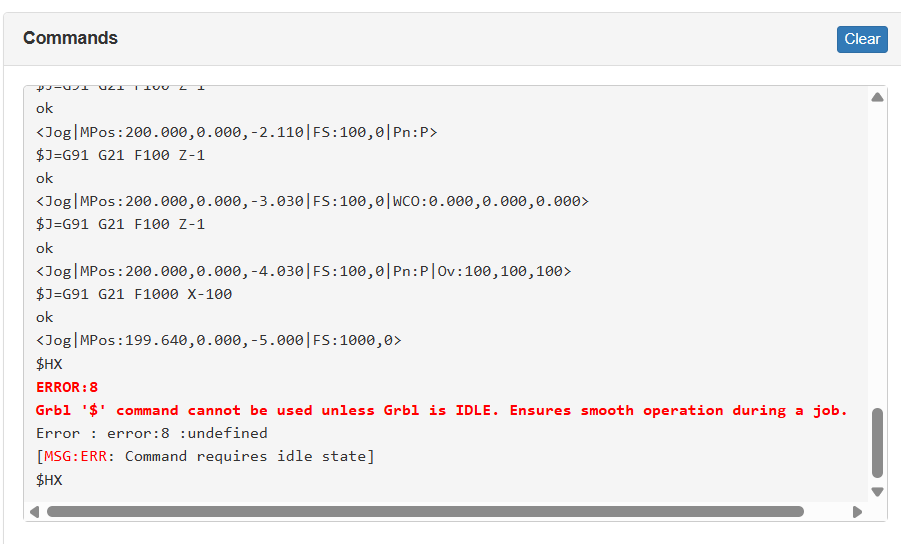

On x axis i got an ERROR👍
I need to see it not trigger, right after homing. Either way Those are very old switches and you need to probably have a longer pulloff.
Try 8 for now just to test it.

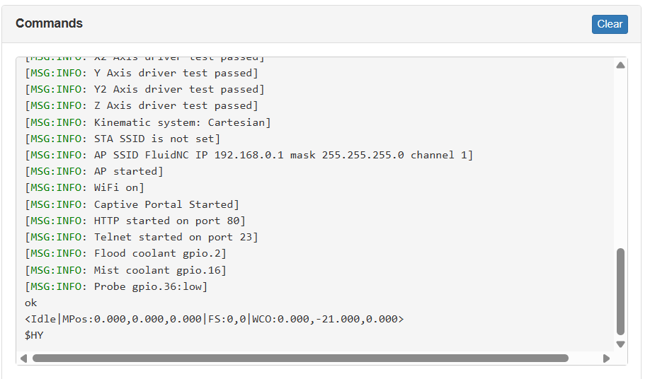

Try $limits in terminal to test each switch.
I need to see the top of this screen, the bottom does not have any info we need. I want to see if it is the correct jackpot version as well as the correct machine versions, and what actual version you are running.
That error says it was still doing something when you tried to home.
thats the the problem, they do not move back, they stop the in the moment they trigger the switches and then they do not move anymore, they do not pull off. I have set it to 8, tried and the same problem showed up it stays in the triggered position.
here is the top part
This was the test $limits
You need to test (by manually pressing) the limit switches while in the $limits mode to see if each switch triggers when expected.

Trigger each switch with your finger, hold it, make sure the screen indicates it was triggered. That is a live view of your switch state.
I understand this part. I have no idea how or why it would do this without showing an error. They should all trigger twice.
thanks, i did it right this time. Now i got two y’s and two x’s
