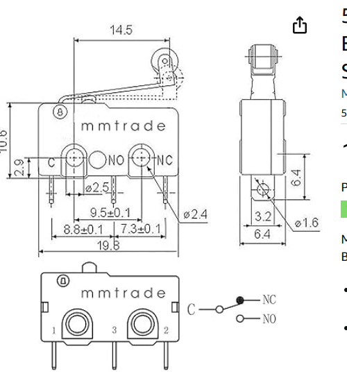

They both click on and off? There are actually 4 separate ones? You can click multiple at once to check.
If you hit X+50 your core moves to the right, and if you home X it moves to the left?
If all of that checks out I need a play by play of what you are doing and what happens.

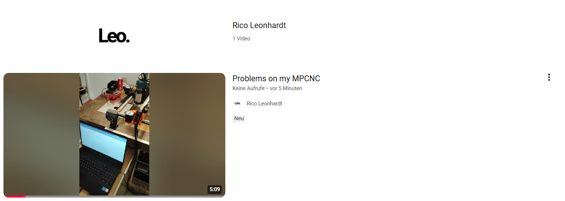

Make sure no endstops are triggered. In the terminal type $HX, click the enter button. What does the machine do exactly. Look at the terminal window does anything differnt show? Does the gantry stop when one endstop triggers or do they both trigger? do they trigger once or twice?
You can take a video and drop it in youtube if that is confusing.
Alright i uploaded a video on YT maybe you got the time to watch it.

When you use the jog keys to move 100mm, does it move 100mm?
Looking at your video it’s is jogging slower than I would expect, I wonder if the steps per mm is correct.
Can you also post a picture of the way you have wired your endstop switches - which pins are the wires connected to?

Did you buy a kit from me, a full kit or are you using anything not from me (those switches are pretty old).

I reuploaded it and published it so everyone should be able to watch it.
The forum says i can’t post links so here’ a screenshot.
maybe this picture helps to find it.:grinning_face:
I bought the Jackpot CNC Controller and the probe in your store, if i bought everything from it customs duty and import tax in germany would have killed me.

I edited your post so the vid is embedded. Browsing the forum a little will help you get past that initial hurdle and you can post links soon. We attract oretty smart spam bots and this rule helps keep them out.
I watched the video and read these comments. It certainly looks like the switches are wired correctly and the machine is built well. It may be hard to see in the video, but it doesn’t look like there is even a 4mm back up. I would expect some text in the console after the $HX too. So I am having trouble pointing at anything other than a software error.
Software doesn’t fail like that though. So the steps to fix a software bug are to make sure you have the right version of firmware on the jackpot and the right config file loaded up. That is what they are shortcutting by asking for the output of $SS.
The other big data point here is that this is a new issue and there are many hundreds if not thousands of jackpots being used. Setting it up from scratch with the known good config should be enough to make it work. I would guess most of those are on low riders, not MPCNCs. But there are definitely many on MPCNCs.
Philipp was suggesting that the X1 and X2 endstops or motors were switched. I liked that idea too before I saw your video. But this looks different. Mostly because they both stop on the switches.
So we are back to trying to figure out why your machine and jackpot are different than the others that work.
  • Where did you purchase the switches and jackpot (we aren’t playing a blame game, we just want to make sure we know more about them)? Did you purchase them from V1E, Philipp, elecrow, or self source them from somewhere?
  • The top of the $SS says v3.9.5. Did you flash that yourself?
  • I have had trouble making sure a new config actually gets loaded. Yaml is very perticular about whitespace characters. Editing the file in something that doesn’t respect whitespace can be faulty. So loading a copy of the config from GitHub without changing it is ideal. But to make sure it is loading, you may want to change one of the strings (like the name from MPCNC to MYCNC). Then $SS will show that your new file actually is being used.
Peculiar problem. It probably doesn’t help to know that this is a confusing one for us. But I think that’s a good sign that we will be able to figure it out.
Never understood it as blaming :+1:
  • I purchased the Jackpot from V1E and the switches did i purchase at amazon
I connected the wires to pin 1 and pin 2 on the switches. I measured all 4 and the worst one was 3Ω resistance. Also they break the circuit if triggered. (I know they have a long trigger way :sweat_smile: )
  • No i did not flash v3.9.5. by myself, it was delivered this way.
  • And the last one: thats a nice tip, thanks i will do it that way :+1:
can you discribe me whats wrong there so i can fix it?
