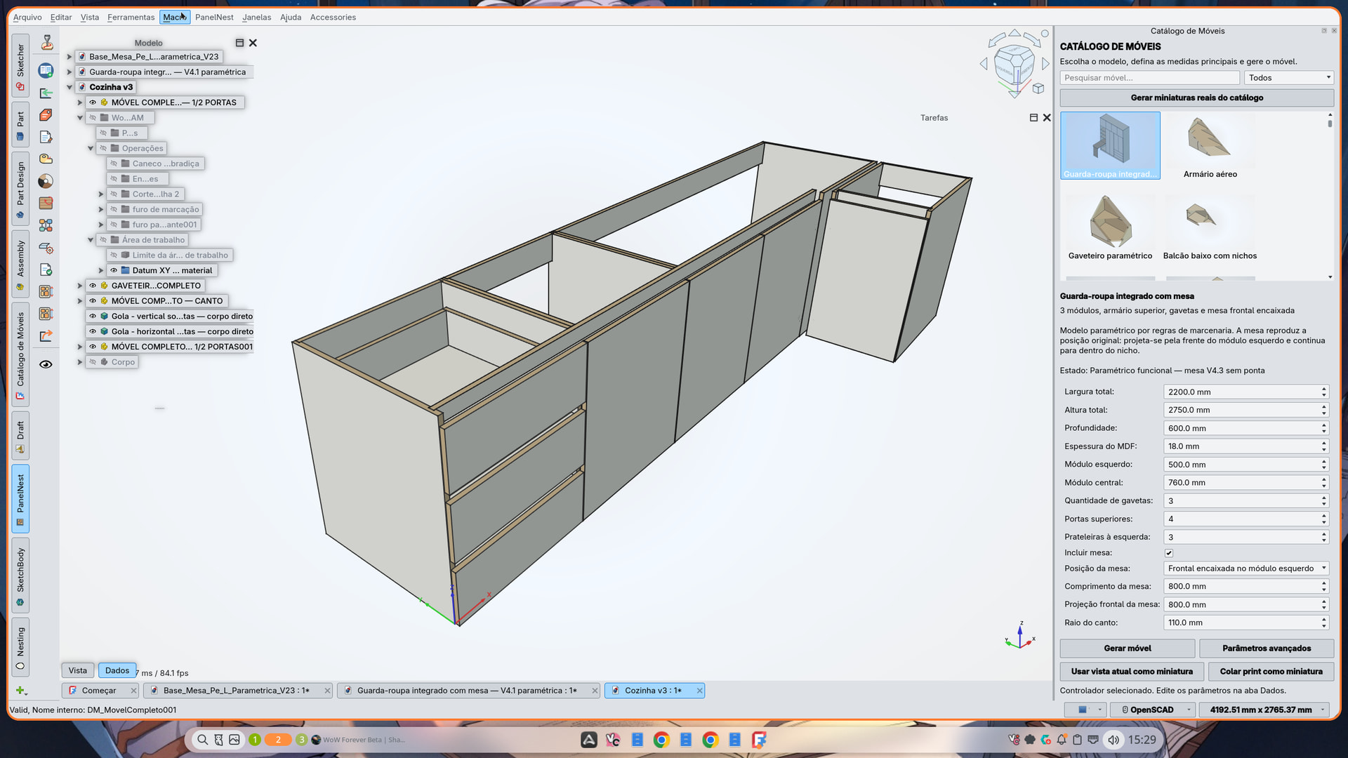

I developed a FreeCAD workbench around a similar idea. If you find it interesting and it’s feasible, one feature I’d really like to see in freazyKam—either adapted from this approach or developed from scratch—is nesting that strictly respects the spacing we define, for example exactly 4 mm between parts.
Another very useful feature would be common-line cutting, where adjacent parts can share the same cutting line. It would be great to have an option for the toolpath to always follow one direction only, or alternatively allow back-and-forth cutting.
Common-line cutting is especially useful for CNC work because it can save a significant amount of material and machining time. I think that, combined with accurate nesting, would make the workflow much more efficient.
I do this when I nest. I set the parts to be the tool diameter + two finishing pass widths + 1mm or so. So for a 3mm endmill I nest to 4.6mm. Lots of common line cutting.

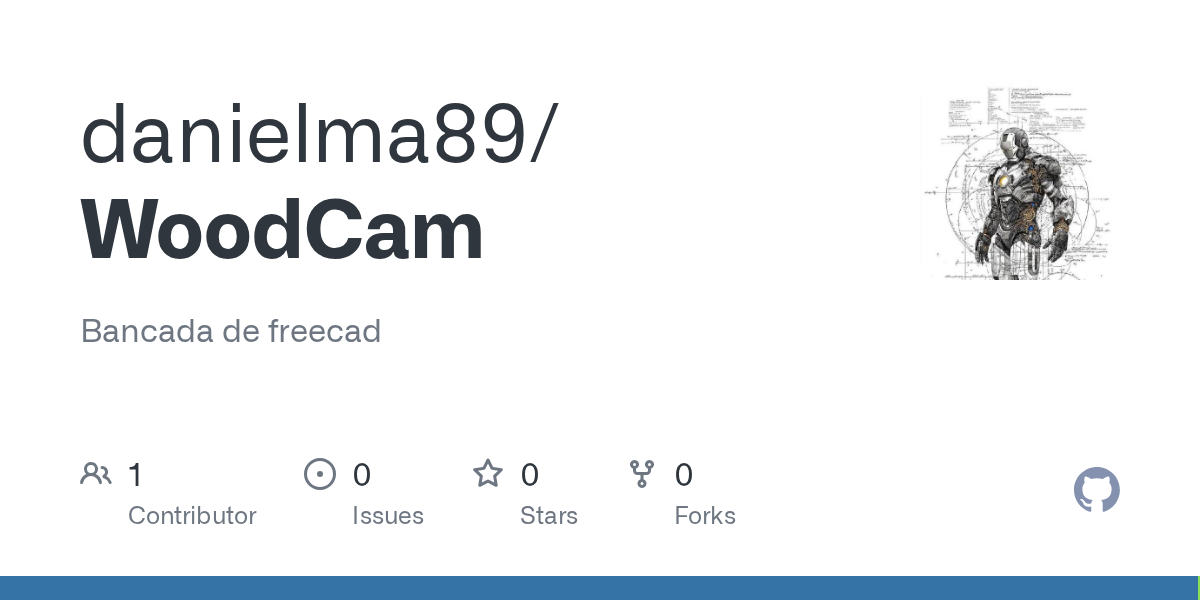

The version I uploaded to GitHub is currently outdated compared with what I am using now. If you find the project interesting and would like to test it or even contribute to its development, I can update the repository with the newer version.

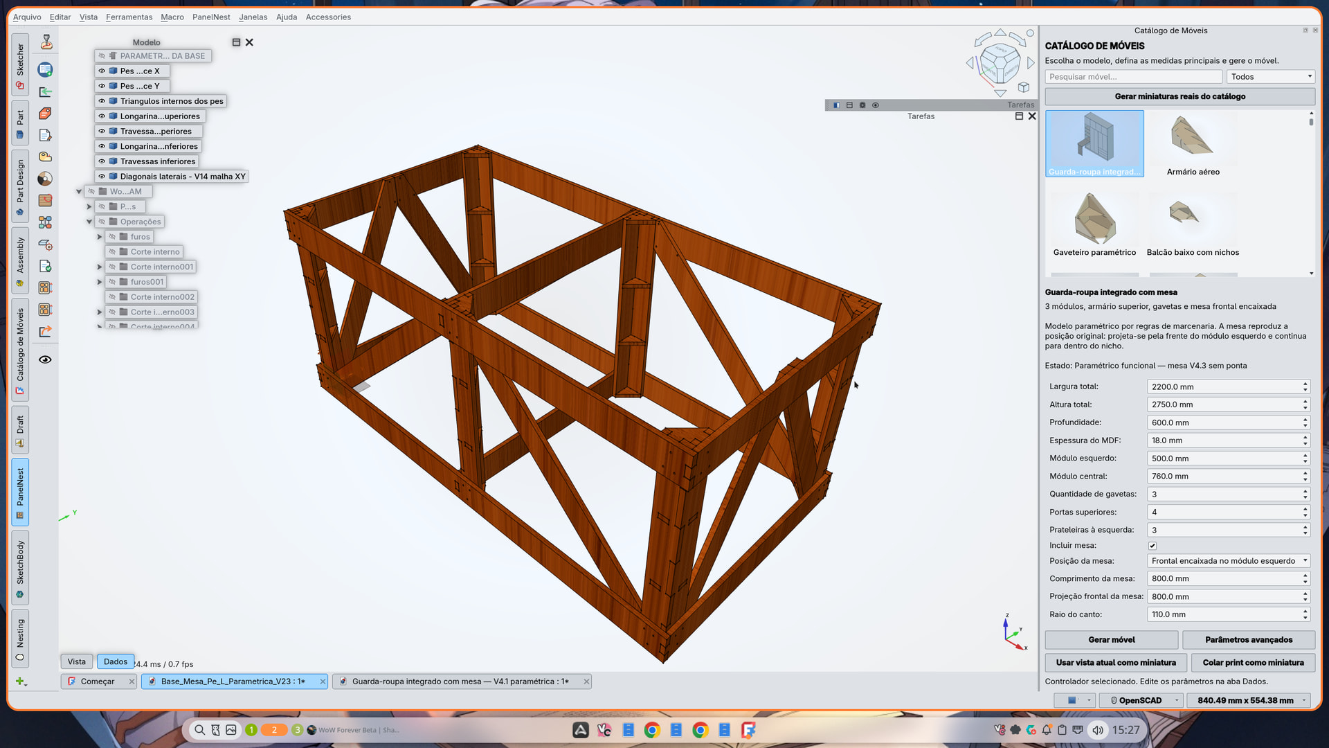

There’s the Woodowking workbench already that does a looooooot of stuff, also the cabinets you posted:
@Philipp Tokoloshe
My initial idea was actually quite similar to the Woodworking Workbench, mainly focused on making furniture design inside FreeCAD faster and easier.
But as the project evolved, I gradually moved more toward the CNC workflow. At the same time, I started building a library of parametric furniture with the help of AI, and I found that development was moving much faster that way. I think this kind of AI integration is almost inevitable and will probably become a much bigger part of the design workflow over time.
The furniture shown in the pictures I posted was actually created entirely with AI. I only applied the textures and materials from my workbench afterward, mainly to show that we can already achieve a very pleasant result this way.
Today, the workbench is more focused on quick adjustments, easy part manipulation, cutting layouts/nesting, and generating CNC G-code quickly, without requiring an overly complex workflow when the job doesn’t need it.

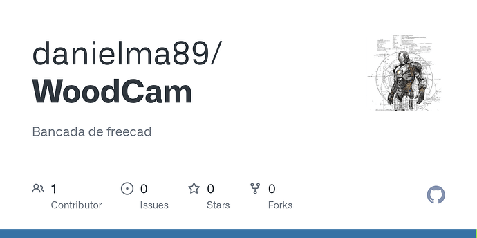

Sure — I’ll upload the workbench code and share the link.
Just keep in mind that everything is still very much a prototype, so there may be bugs or things that don’t behave perfectly yet. In my case, I use GPT with Codex while developing it, and that has made the process much easier. Whenever I run into a small issue, I just describe what happened and usually get a fix almost immediately.

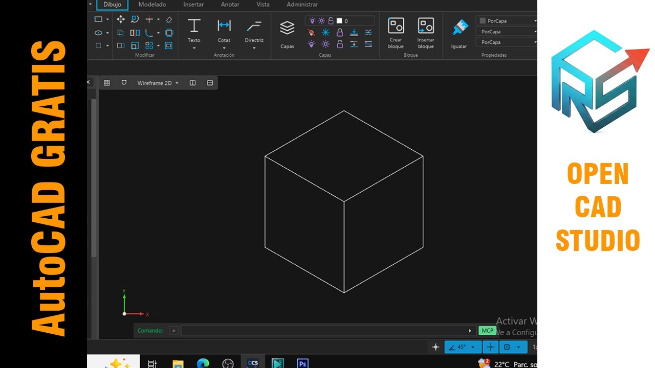

I don’t know if you’ve seen this yet, but OpenCAD Studio showed up in my recommendations a few days ago. Apparently it’s a fairly new open-source project, and it also runs on Linux.
Since you mentioned that you miss AutoCAD after moving to Linux, this might be worth taking a look at. It seems to be aiming for a more familiar AutoCAD-style workflow, with DWG/DXF support and a traditional command-based interface.
I haven’t really tested it myself yet, but when I saw it I immediately thought it might be useful for exactly the situation you described. :slightly_smiling_face:

In the WoodCam project I shared, we already experimented with some of this directly on the 3D heightfield/mesh: ramped roughing entry, Z-level/raster roughing, continuous linked raster finishing and an offset finishing strategy. We deliberately work from the mesh/heightfield instead of converting a complex STL into a CAD solid, because that conversion can become extremely heavy.
If any of that approach or code is technically useful for FreazyKam, feel free to use it as well. I think developing the 3D side further could make the workflow much closer to what we normally expect from programs such as Aspire, while still keeping FreazyKam simple.

Sure, I’ll organize the files to upload to GitHub.
