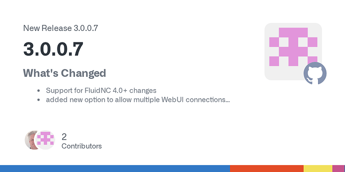

Released

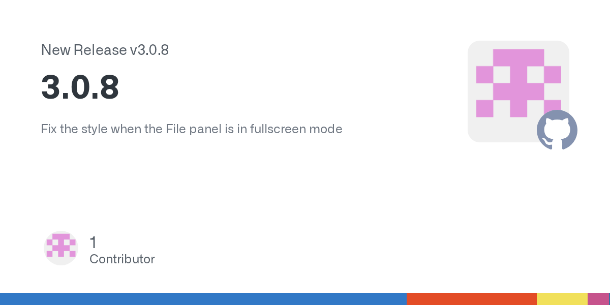

Updated release…
Was missing some styling in the fullscreen mode of the file panel
