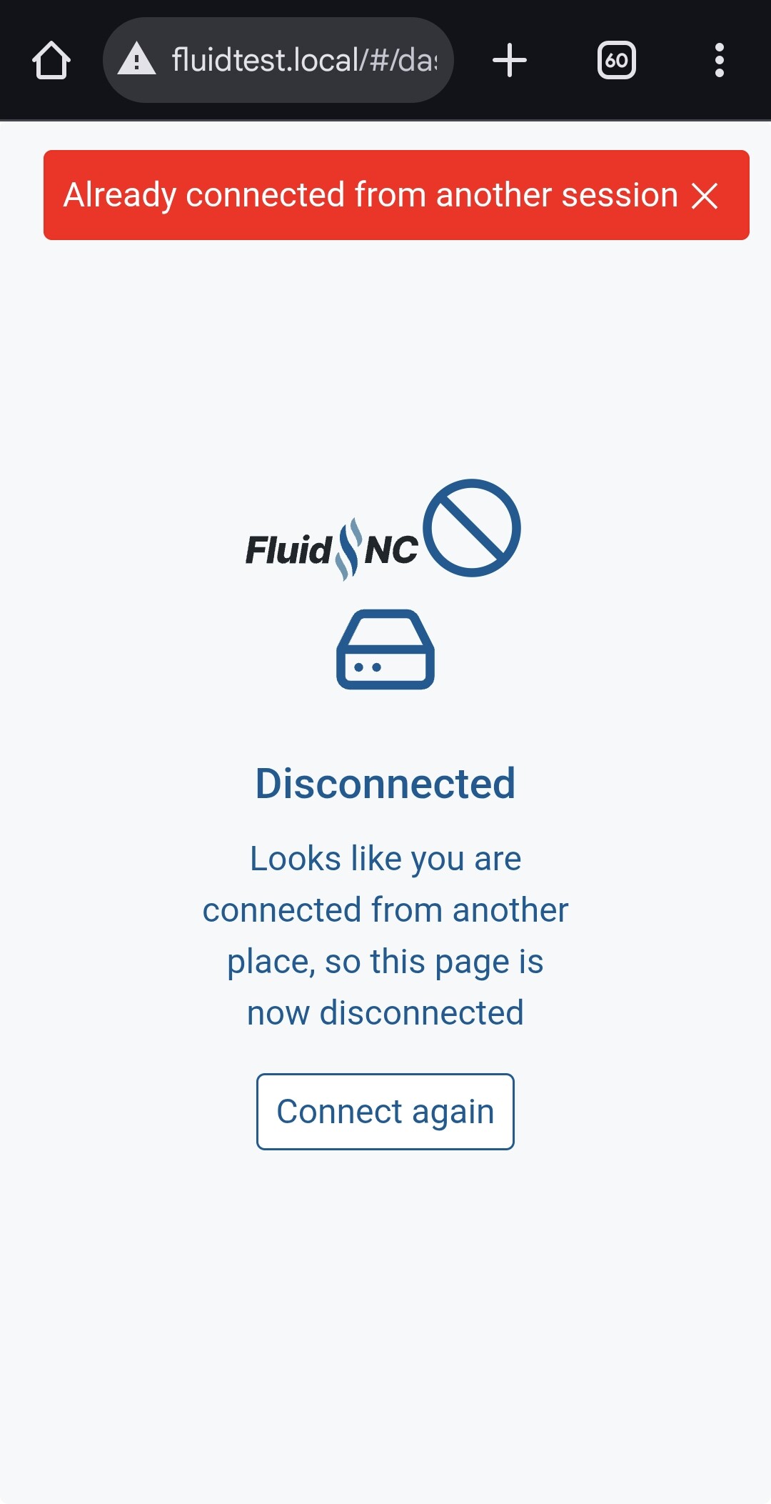

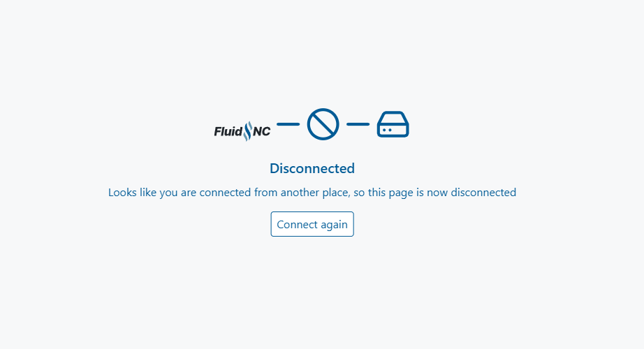

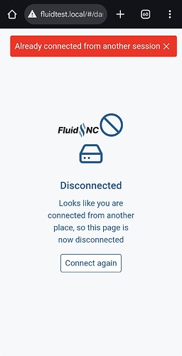

When it disconnects because you connected somewhere else, it now shows this message:
Already connected from another session
That’s different than what it used to display and not actually what happened. It seems to functionally work ok.

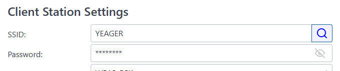

  • WiFi Settings - The only potential issue I see (I didn’t test this), is that if you choose to display the password, it’s all asterisks since FluidNC won’t provide that info. I’m curious if that could inadvertently change the password to asterisks. I suppose each piece of information is a separate command so it’s probably ok.

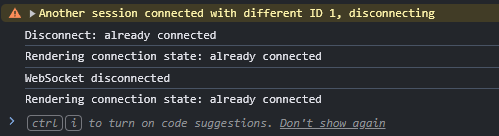

hmm… I just tried it and this is what I got…
maybe check the console log?
mine says
It only shows the red message briefly.
ah… yeah.
I did notice that. I think the new websocket code toasts every error it comes across right now. I probably need to be more selective. It’s also got a bunch of debug stuff still in the console log I think that I need to remove

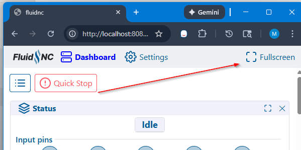

I thought this was going to be a better idea, but it turns out it doesn’t work on most devices because of limitations they impose.
I wanted it for my iPad because it’s such a pain to enter fullscreen, but the button does nothing. So for now, it hides itself on incompatible devices.
Feels like that might be a moving target though, and the only place it will be available is where it’s already easy to go fullscreen.
I was thinking instead it might be better to move the Quick Stop button there
and move the hamburger menu next to the logo.
Then we regain some significant vertical space for small devices
Works fine on my PC and phone.
I think you could move the hamburger and quick stop button and still keep the fullscreen button. I display a logo there in my themes, but that was only because it was empty space. I’d rather have useable space than fill it with a logo. I don’t think the fullscreen button needs a label regardless of screen size. That is also consistent with the panel fullscreen buttons.
It might be just Apple devices.
You have to go through their special menu.

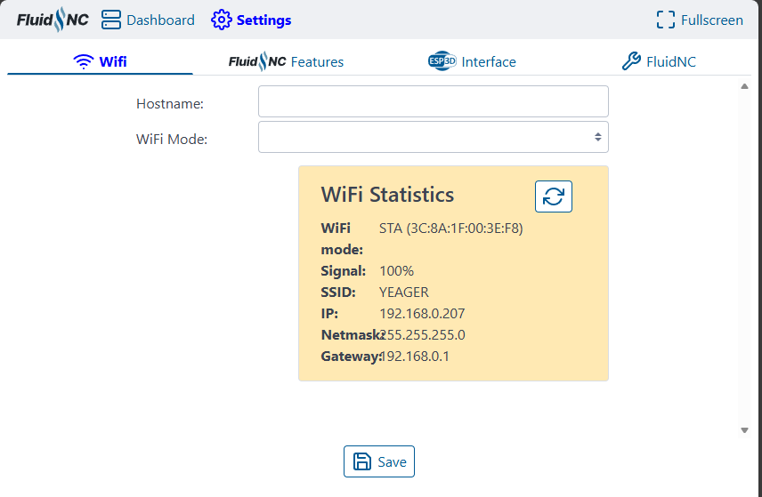

It might also help for the Wifi tab to have some kind of loading indicator. It pauses at this stage for a few seconds:
hmm… It’s supposed to have a loading indicator..
And it’s not supposed to load the wifi networks unless you click the search, which is usually the long part.

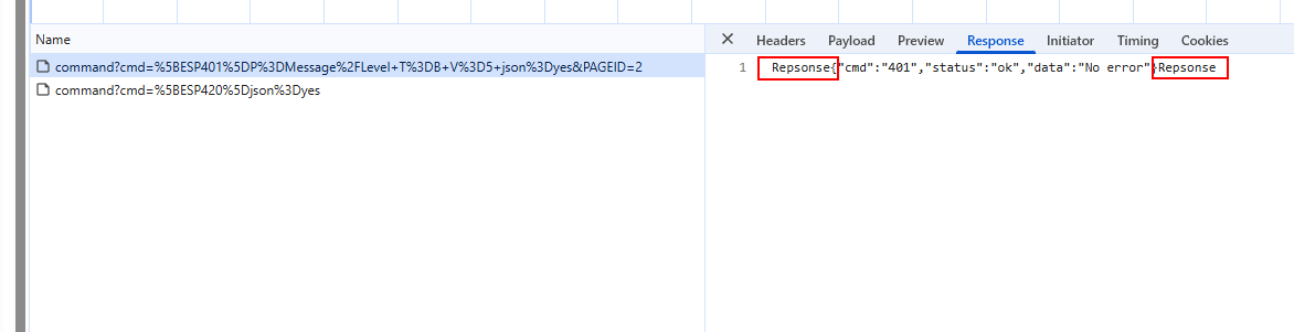

Looks like some of the responses aren’t right
