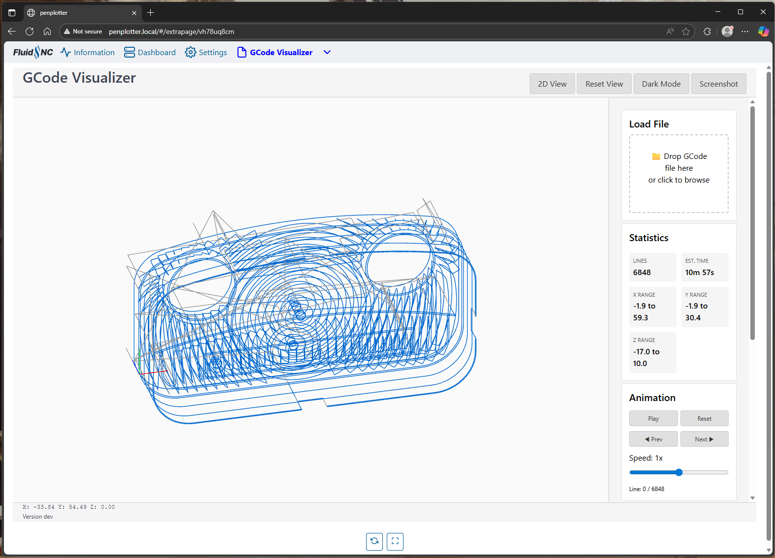

WebUI v3 Extension - GCode Visualizer
Well, it looks like the WebUI Shenanigans continue…
This is a work in progress. I just randomly started working on this.
I literally don’t know how to do this, but I know enough to direct my friend Claude. I quickly put this together. Still a work in progress.
But, it can render gcode in 2D and 3D(!) with WebGL. So, you can drag, rotate, and zoom. And it minifies and gzips down to 11KB without any library dependencies.
I messed with making the visualizer in Mitch’s tablet view available as a panel extension, but it didn’t fulfill my half baked vision.
So, I’m hoping to incorporate this into an extension, where you can preview a gcode file before you run it. It literally has to download the gcode of the FluidNC SD card to preview it, but that’s fine. I don’t entirely know what that looks like yet but the hard part works.
Stay tuned…

GCode visualizer looks cool. I had the same thing on my todo list, along with a surface wizard like @jamiek 's site integrated in, etc.
I got caught up in modernizing the code base and just trying to optimize the performance instead. I spent a good week doing it, and then got discouraged by the change in size from the Tablet mode implementation…
