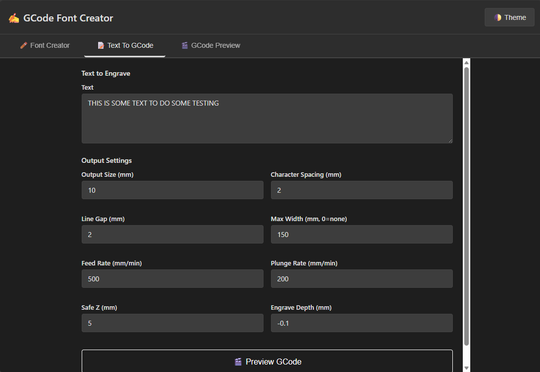

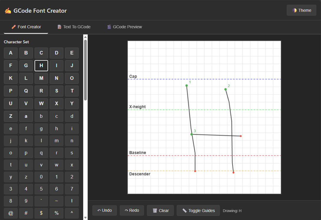

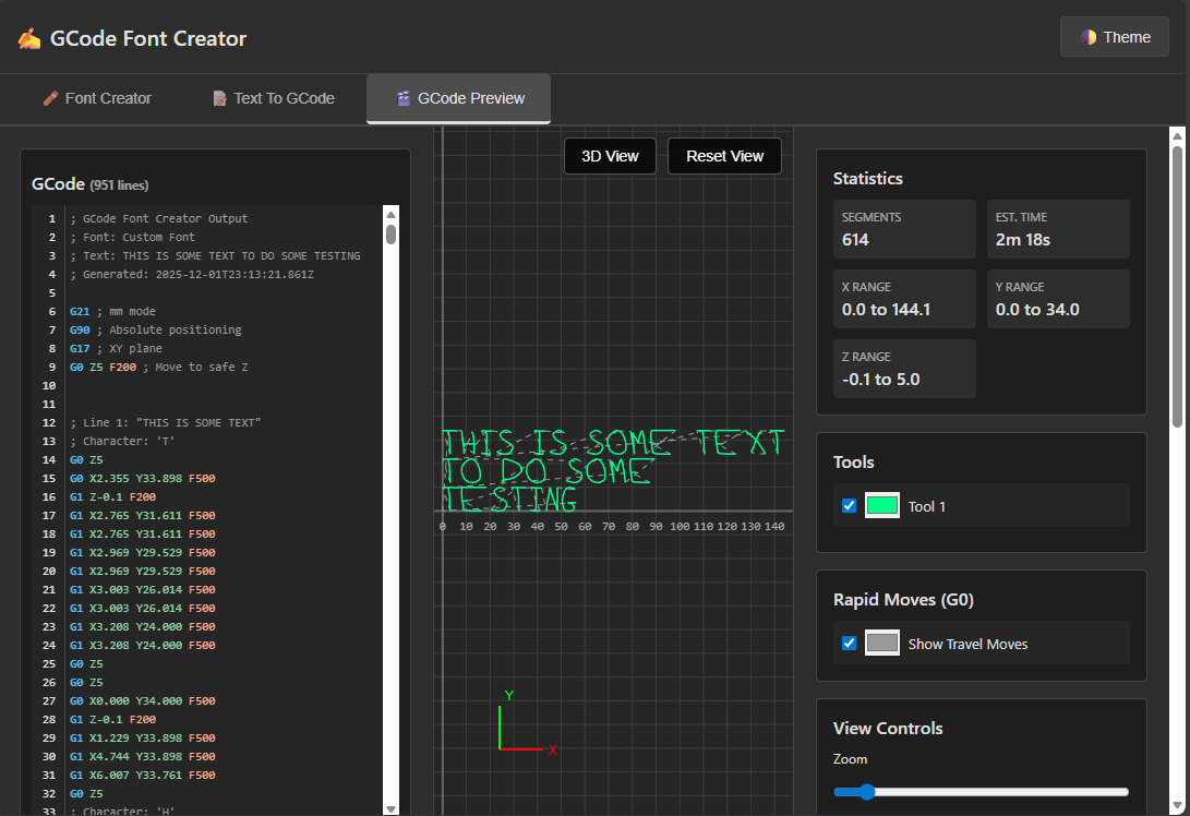

So, we finally gave in and got an elf on a shelf. I figure I can get it to write something on the pen plotter, but I needed a way to write handwriting.
Cool. Wow. That’s a lot more effort than I would have been willing to put in to avoid using single line fonts and claiming that this “elf” thing had neat writing.
AI got me a lot further than you might have expected.
