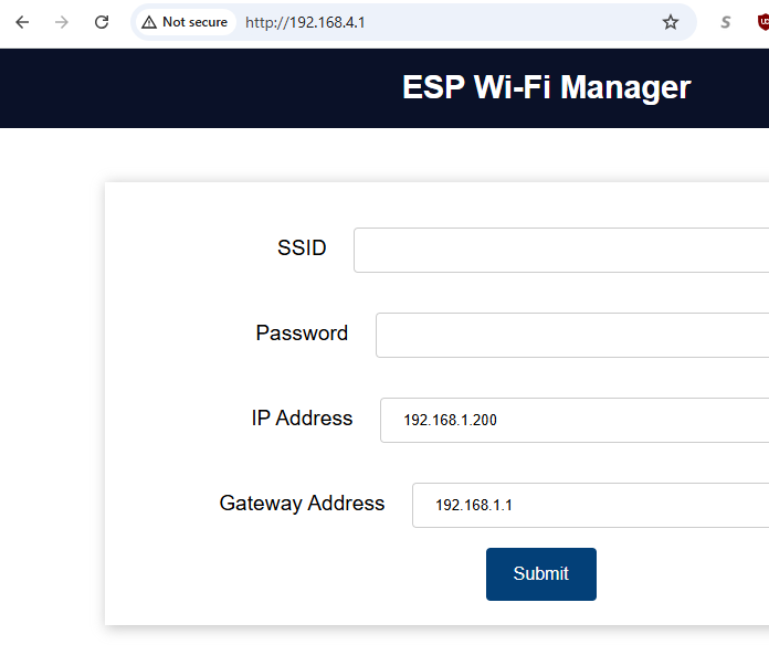

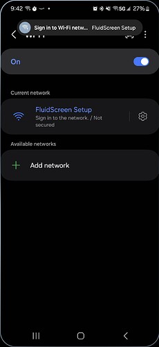

Well, this is fun. Got it setup to be able to do the settings via a captive portal page and store to flash.

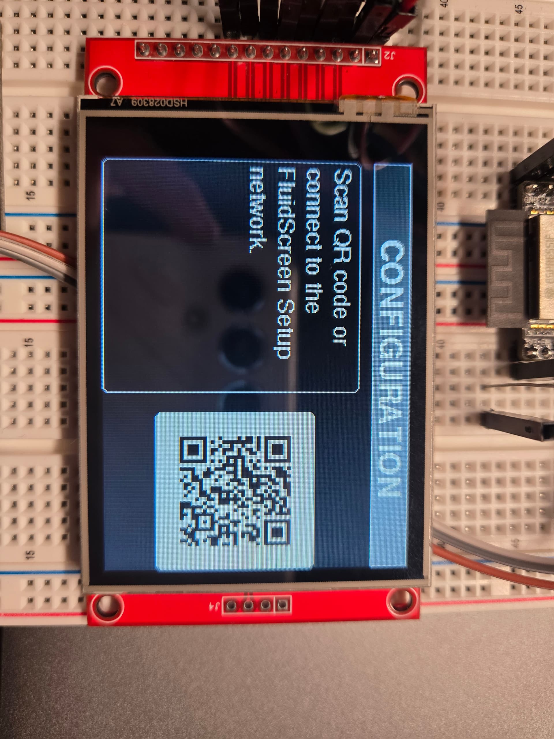

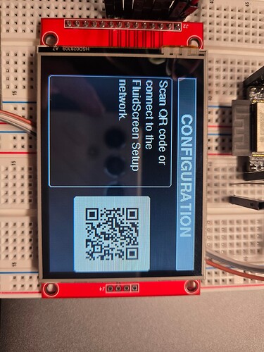

If settings are not setup or you choose to display from the menu:

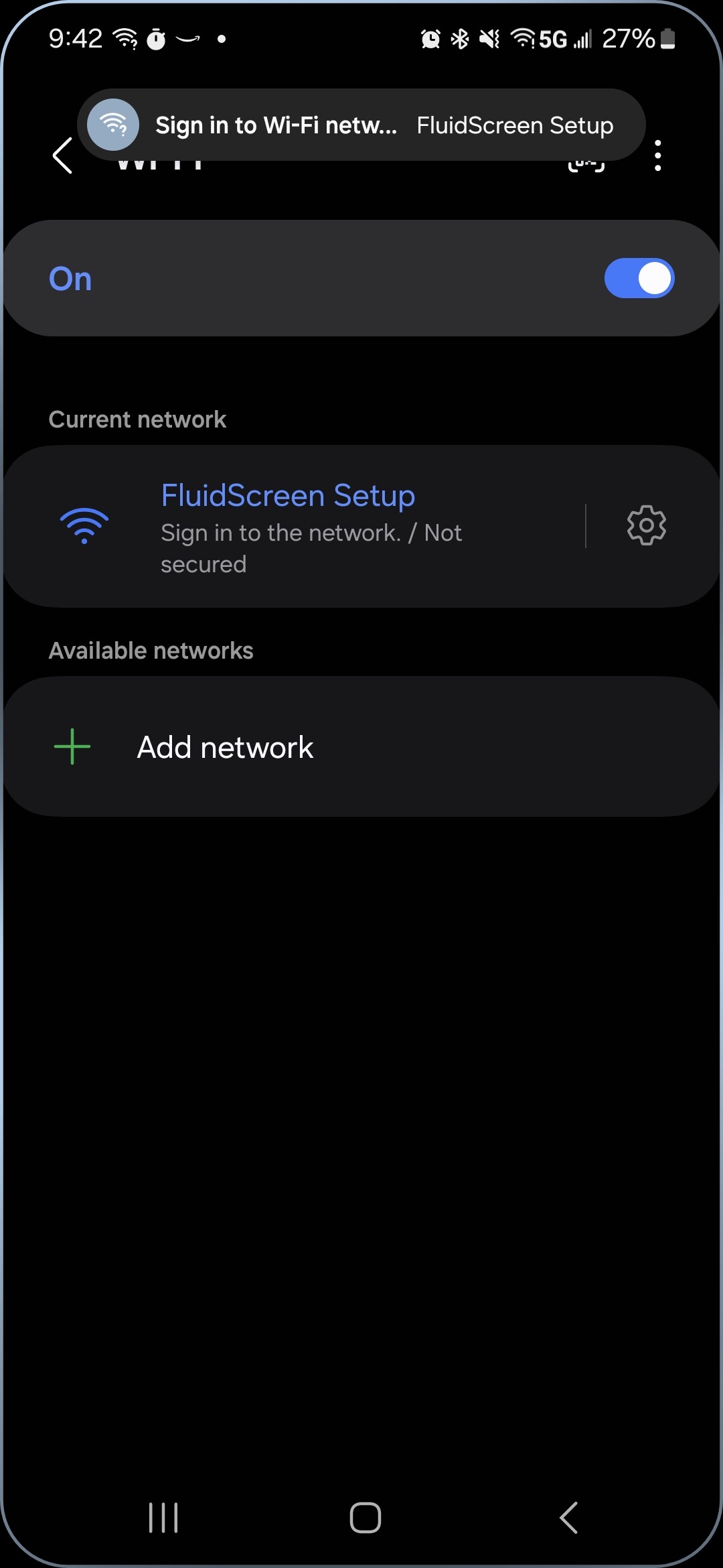

The QR code when scanned connects to the ESP wifi as a captive portal.

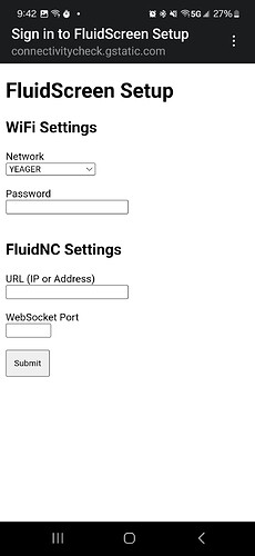

And takes you to the page where you pick your settings, including a dropdown with a list of available networks.
Once you submit the settings, it will automatically restart and take you back to the normal screen.

I pieced it together from examples online. This appears to be a pretty common thing to do with an ESP32. Adding a QR code into the mix just seemed like a good idea and I found a library.

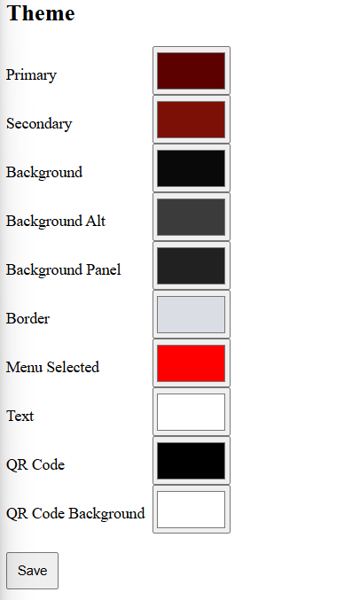

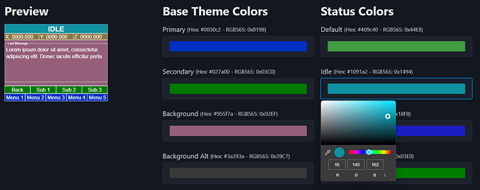

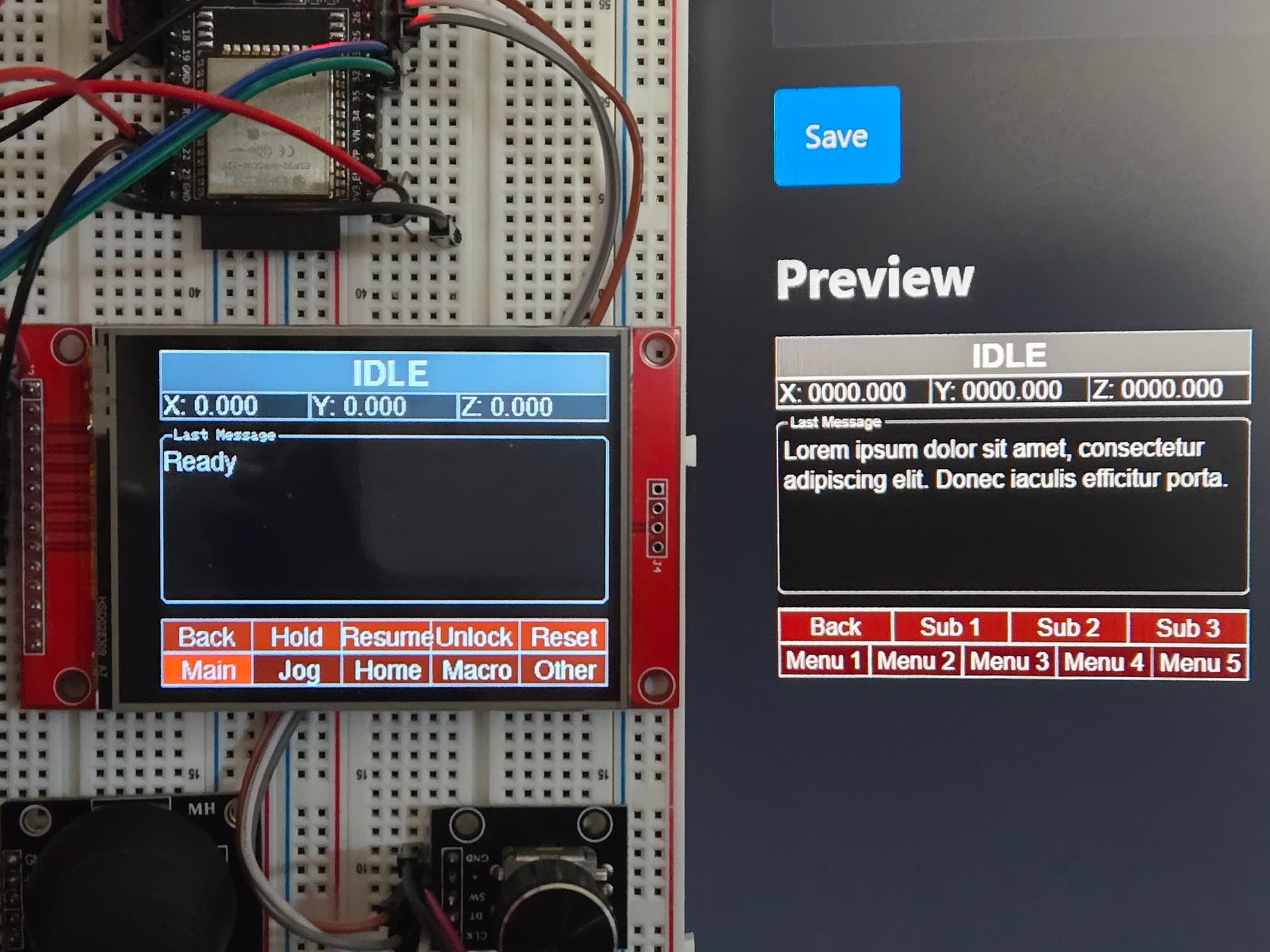

Well, that escalated. Not functional for loading/saving yet but once I saw how to serve webpage files from SPIFFS, that opened up the capabilities.
The colors won’t completely match the screen because hex colors are 24 bits and the screen uses RGB565 16-bit values. Plus, the screen colors are a bit muted.

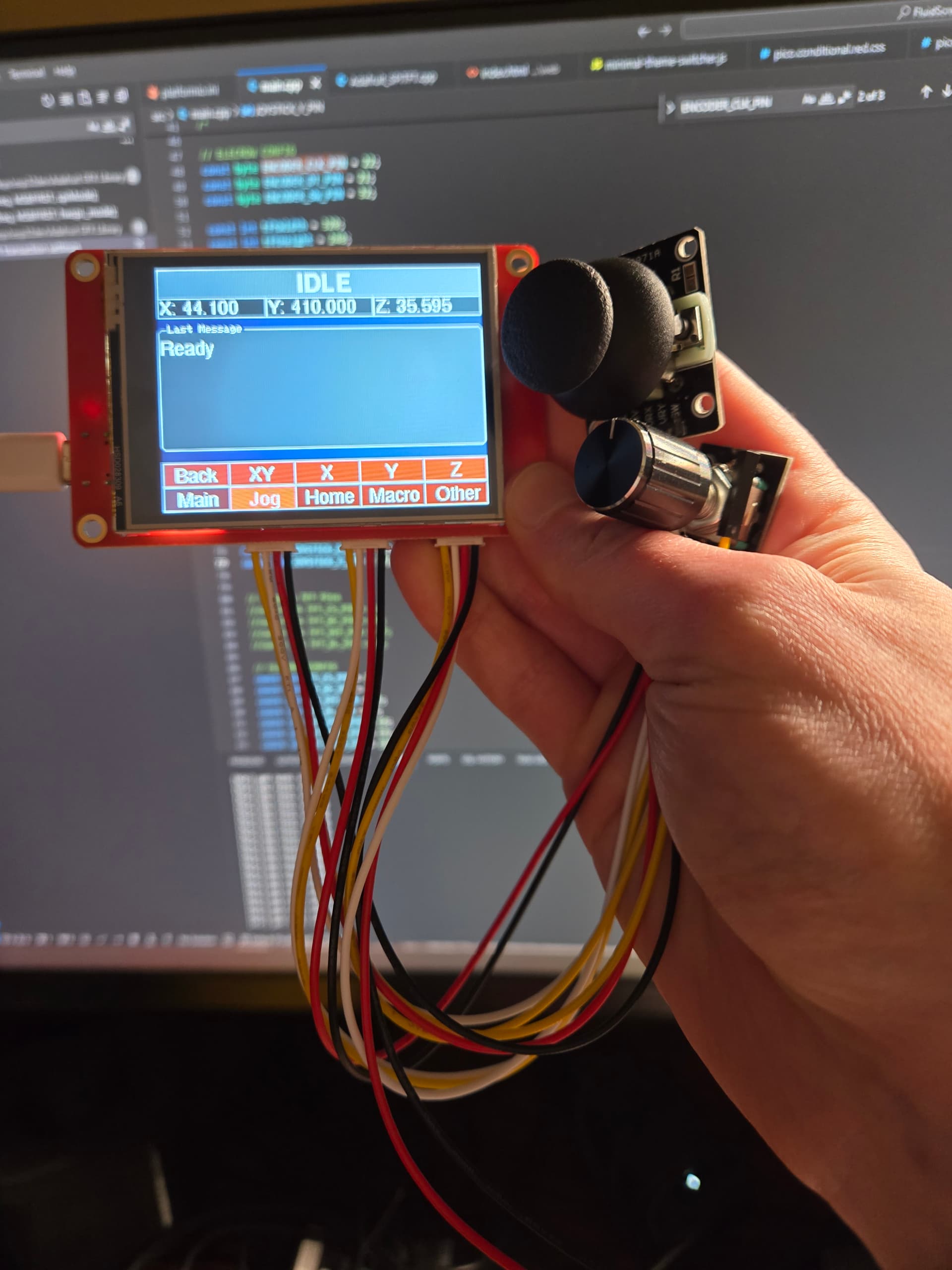

Bah, the Elecrow display/ESP32 combo didn’t work out. Took a bit to get the display to use hardware SPI. Drawing was way too slow with software SPI but got that figured out. (I didn’t know anything about that before this project.) Ultimately what killed it is not having enough analog pins. I think it would have worked but I couldn’t use one of the analog pins because it was shared with wifi.
Oh well, at this point I’ll proceed with a separate display and ESP32.
