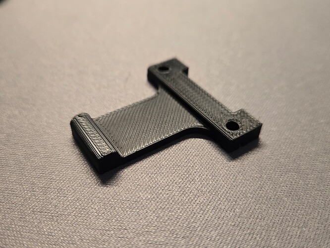

For the ESP32 mounting, thinking something along these lines since the ESP32 devkit doesn’t have mounting holes.
Which I saw here:
Dev board mounting - ESP32 Forum

Some minor tweaks to make but getting close. I wish I could center the visible part of the screen but I would have to make it wider due to constraints from other parts. Thought about covering part of the screen but that would mean I would need to make it a bit thicker. I will probably just call that part good.

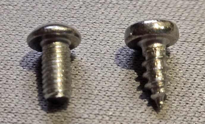

Trying to figure out screws. I was using M3x6mm fine thread screws because it’s what I had. I got some #4x1/4" wood screws because I thought the coarse threads would be better for plastic. The M3s work fine and the point of the #4s means I need to make some things thicker. And while they are similar size, they need different hole sizes.
Any thoughts?
