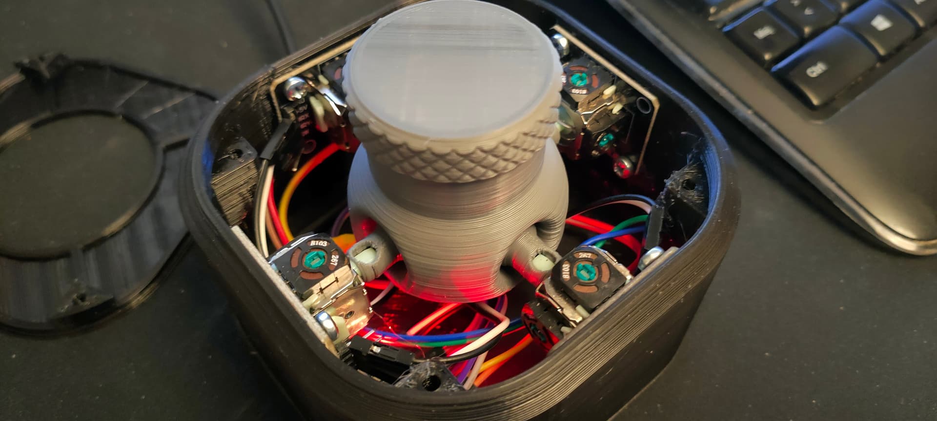

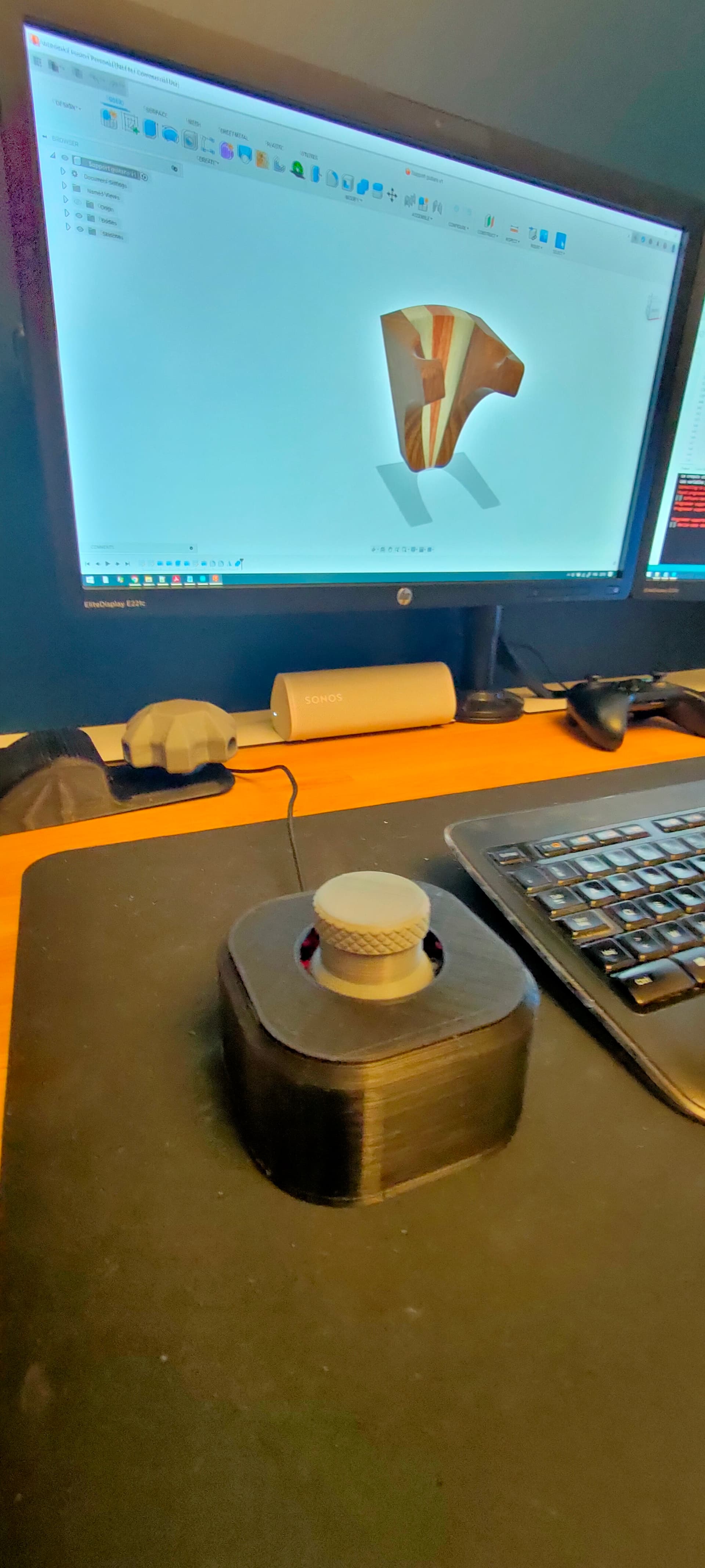

There’s been a bit of traction for this in the “Neat!” topic, so I just make a dedicated one here :slight_smile:
I’m made this Printables following Teaching Tech’s video
https://www.youtube.com/watch?v=2xAk-wegS9o
This is a cheap diy version of the Spacemouse, a 6DOF mouse for CAD softwares
I already tried to make the “old” version but it barely worked at all
Movements were pretty wonky, and using keyboard/mouse inputs didn’t work too well in fusion 360
The remixed one is definitely easier to print/assemble, and the fully emulated spacemouse is a big improvement
The only problem I had was with defining the custom Arduino board
You’re supposed to copy files from “C:\Program Files (x86)\Arduino\hardware\arduino\avr to ~\Documents\Arduino\hardware\daemonbite\avr” but I don’t have this folder
Thanks to @jeyeager I found those file in “C:\Users[USER]\AppData\Local\Arduino15\packages\arduino\hardware\avr\1.8.6”
Once I copied those and edited the boards.txt file, the “spacemouse” immediately showed up in the 3dconnexion software after re-uploading the sketch
It’s really missing some buttons and it’s pretty hard to get comfortable using it, but so far it’s pretty cool
I really struggle with the twist motion though…

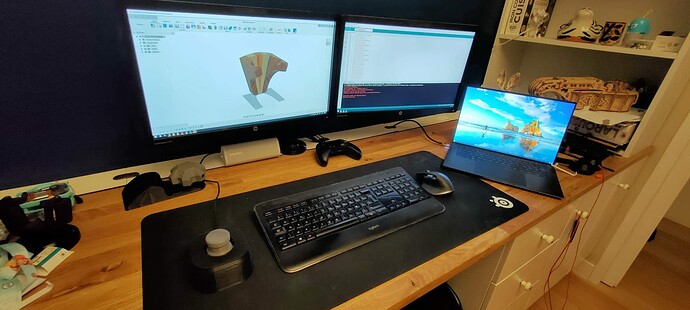

The arduino totally impersonates a spacemouse explorer and you get the full range of options and integrations

Also, I updated the firmware with this one, and the overall feeling is much much improved
https://www.printables.com/fr/model/881183-new-improved-software-tt-spacemouse-v2/files
