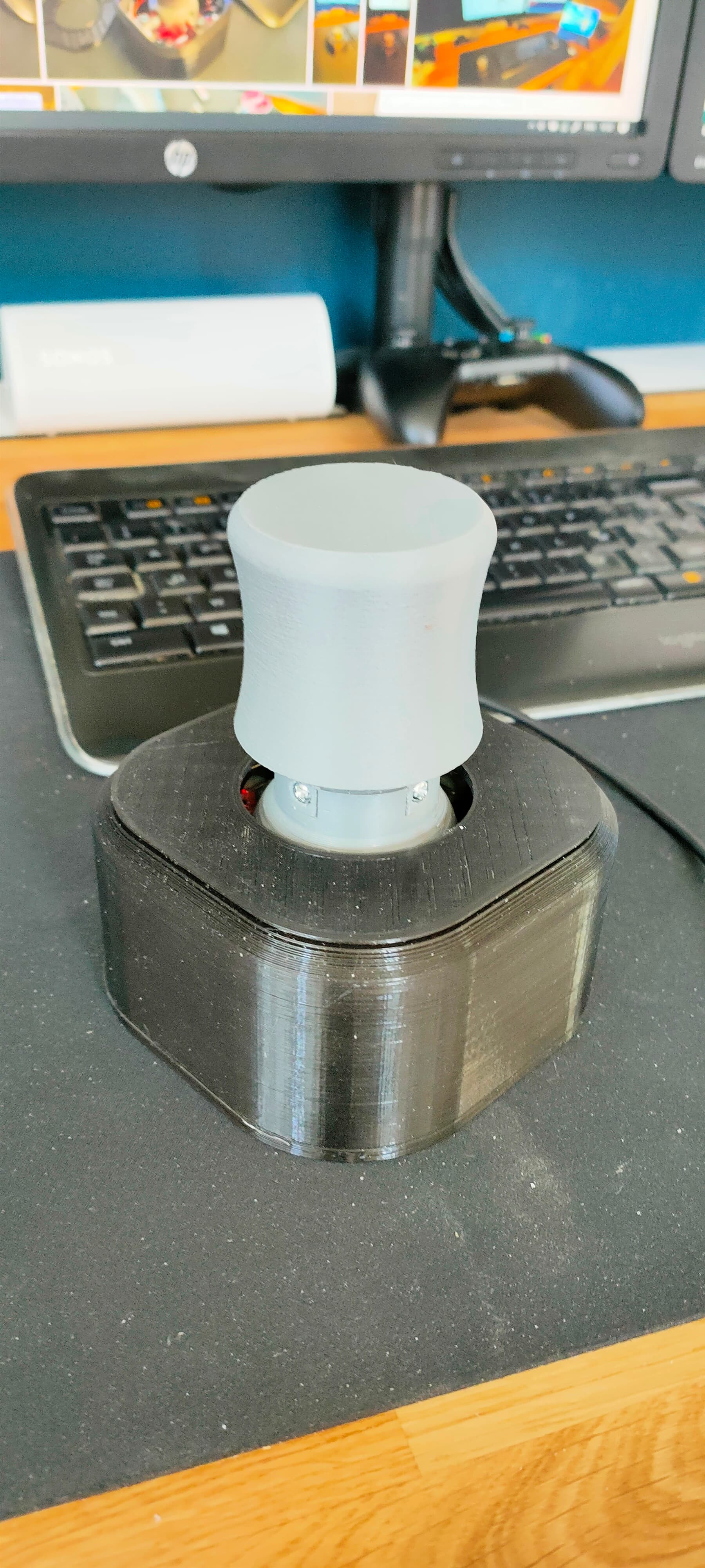

How’s the weight on it?
As tall as it is. His first design with hand rest makes moer sense, doesn’t it?
Yea, but this way someone can design a nice wooden hand rest we can cut out on a CNC. :laughing:
Ummm… I’m just going to walk away, and pretend I didn’t see this question. We’re still a family-friendly board, right? :japanese_goblin:

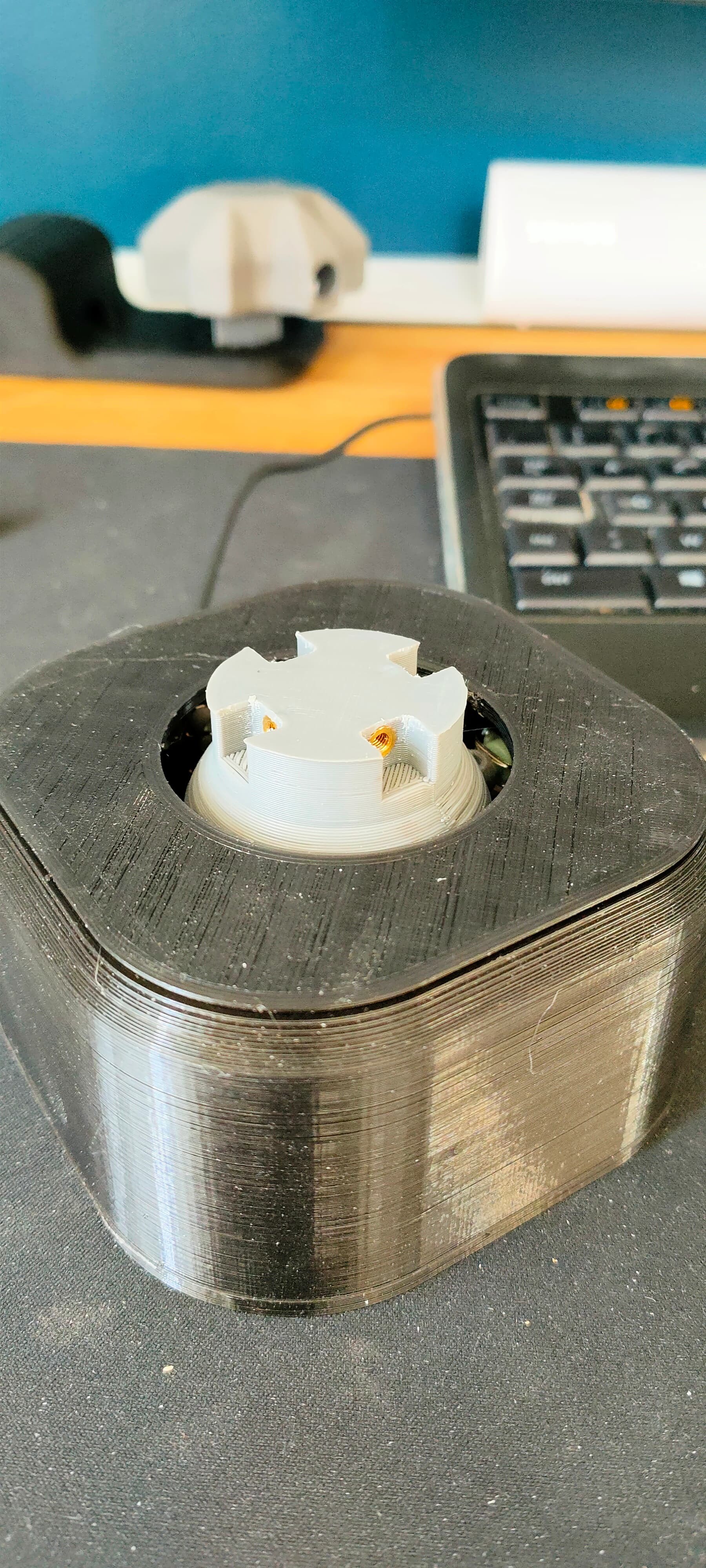

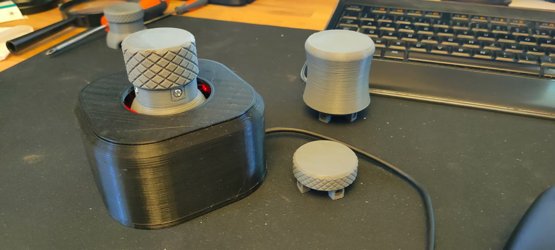

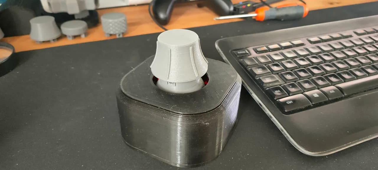

Whatever knob you’re using, I think the box is too tall

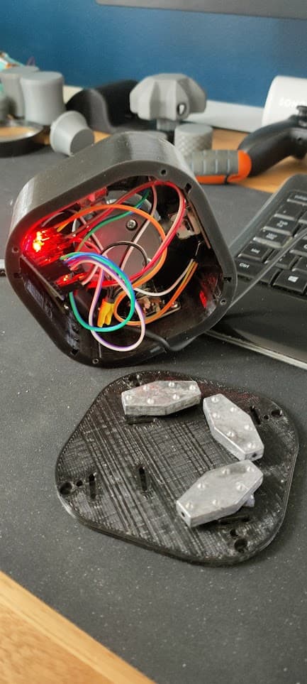

The Arduino sits under the joysticks and I think it could be optimized easily
The knobs themselves are hollow, so they’re very light
The base I still need to put some ballast in it to weight it down

Since I only have the printed parts right now, how does it feel in your hand? Is is accurate?
Maybe you could post a video of it in action?
I’ll try to make a video
Most of the time, it feels precise, but I sometime feel it lacks sensitivity
Overall twisting (rotate) is the most problematic, and zooming (push down or pull up) sometimes interfere with other movements
It’s hard to tell if it’s hardware or software related - or just me being not accustomed enough yet…

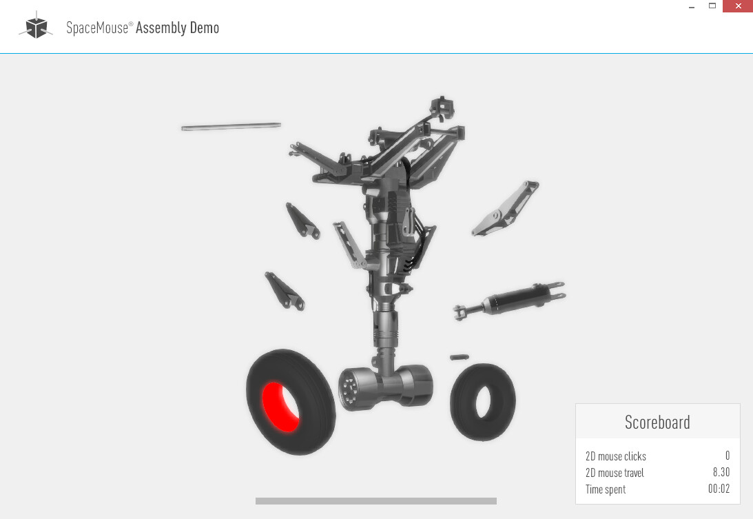

3d connection has some training stuff on their software for practice with it. And since the “space mushroom” uses their stuff it should work for that as well.

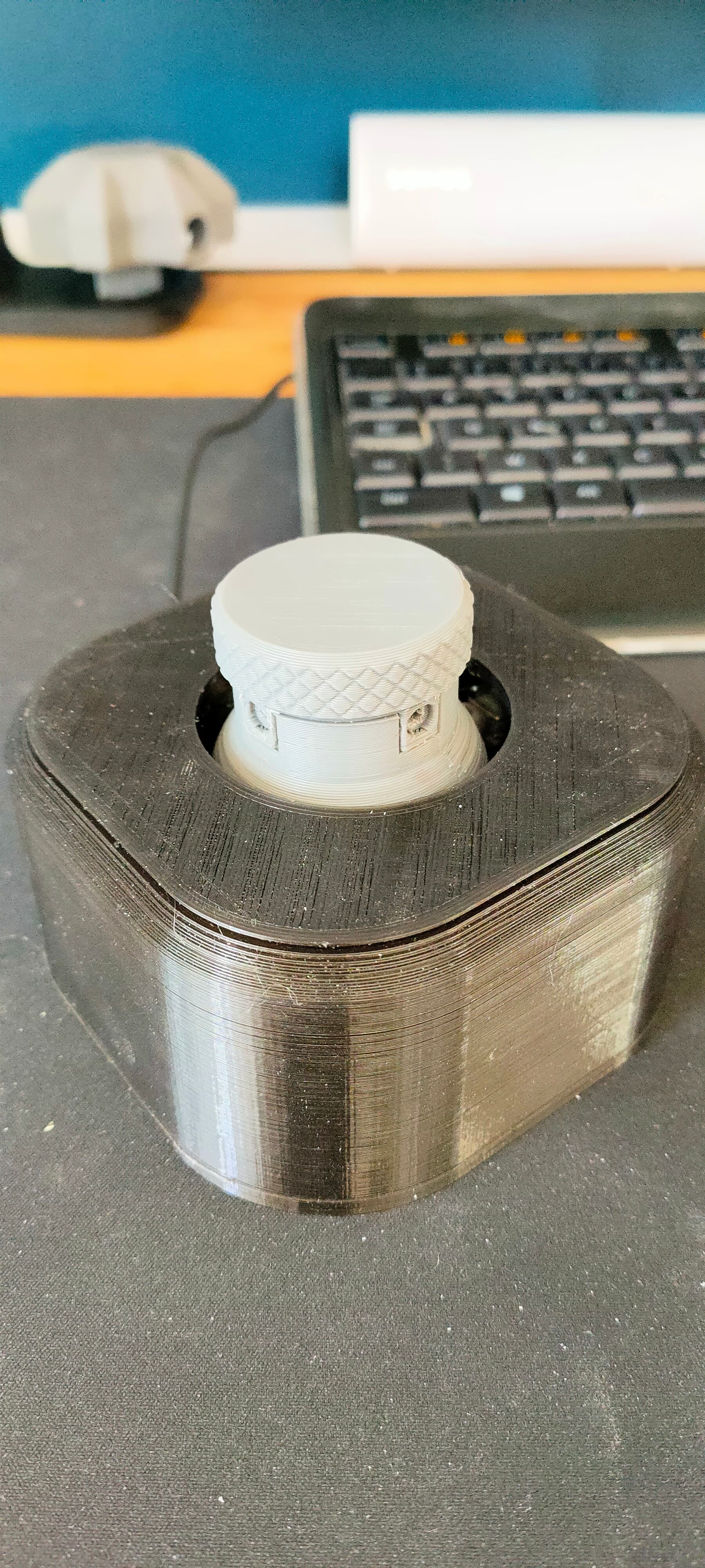

I just designed my own knob :stuck_out_tongue, therefore I officially beat “Doug the mad modder” in this race :smiley: (curious to see what crazy mods he will come up with though ^^)
https://www.printables.com/fr/model/887228-spacemouse-v2-detachable-knob
Also added a bit of lead (3x 40g) to the base and it definitely feels nicer
